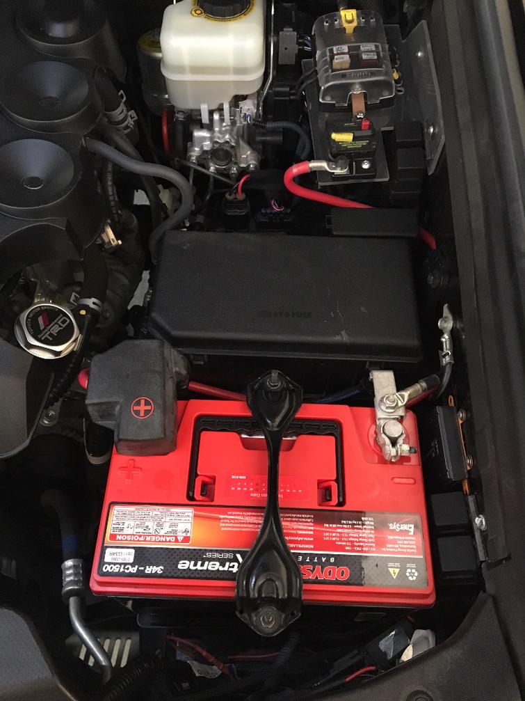

August 22, 2017
Installed Odyssey 34R-PC1500T
