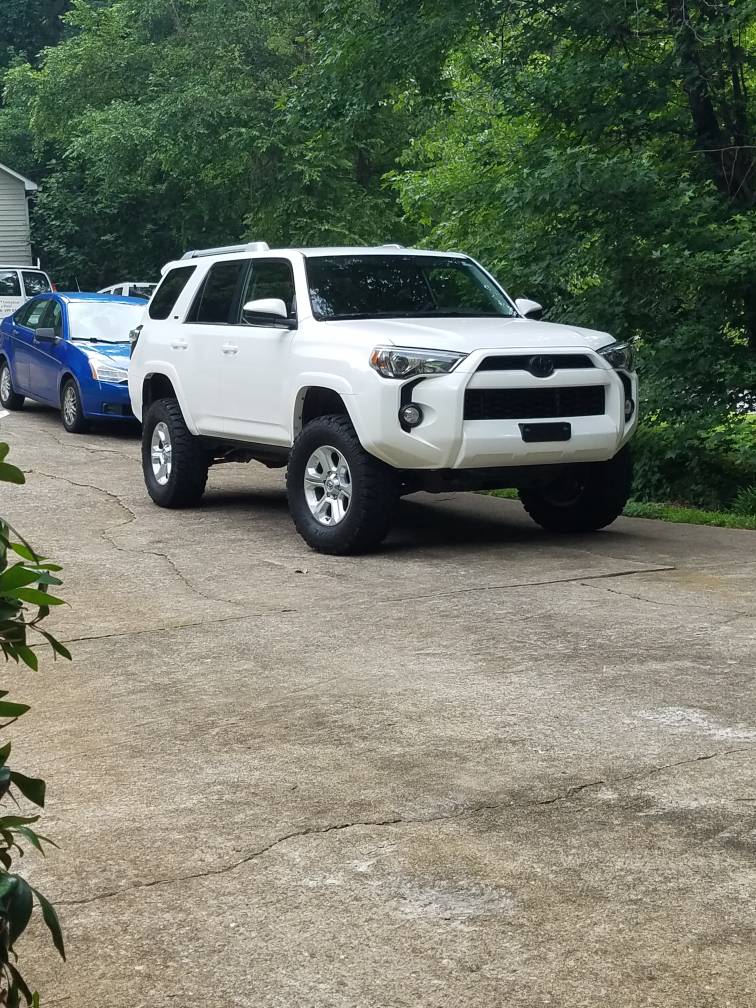

Here is a pic of the angle. I have ordered the 2884s and plan on not driving it until Friday, switching the 2884 for the 2885 and possibly taking the spacer out to get the front down.

Yeah, That sounds good. I am at about 23'' hub to fender, and that is about as high as I would want to go.
It sounds like you don't have enough weight on the front for the current springs, and the additional spacer just adds to it. It would probably settle some, but not enough without new springs and/or taking out the spacer.
If I took the spacer out i think I'd still be at 24 in front. Think it would settle enough to be OK or should I just go the 2884 with 1 spacer in driver side and none on passenger?
Sent from my SM-G935V using Tapatalk
Did you drive it around at all after the install to see if it would settle additionally, or are your measurements from right after you lowered it to the ground?
How high is the rear of your rig right now?
Yeah if they are 1/4 inch spacers, it would not get you down far enough alone by removing just the spacers if you were looking for 2.5-3'' of lift....
I have a buddy that has been running with a height of 23.75'' with no problems yet after thousands of miles, and I know of a few on here that have posted that they are at 23.75-24'' in the front, and have been for quite some time with no issues reported yet...but the lower you go, the less likely you'll have issues
If you do not plan on adding any additional weight to the front, going with the 884's would make sense for what your original goal was.
I did drive it around yesterday trying to find an open alignment shop and getting the tires on. I have also measure several times hoping it would come down a little lol. I really love how tall it is but I do not want to replace cv axles any time soon. The front passenger side is at 24 5/8ths right now. I'd be happy with 23.5 I think so hopefully the 884s get me there. I'll also call ARB tomorrow and see what they think.
For anyone in the future wondering: I spoke with ARB and they stated the new 2885s are designed to give a 5th gen 4runner 3 inches of lift WITH a bumper and winch. So basically with no extra weight in the front of mine I got around 3.5 plus the 1/4th spacer gave me around half an inch which is why I ended up with measurements over 24 inches in the front.
I have ordered the 2884 (designed to give stock 5th gen 3 inches of lift) and will be putting it on this Friday and removing the spacers for now.
