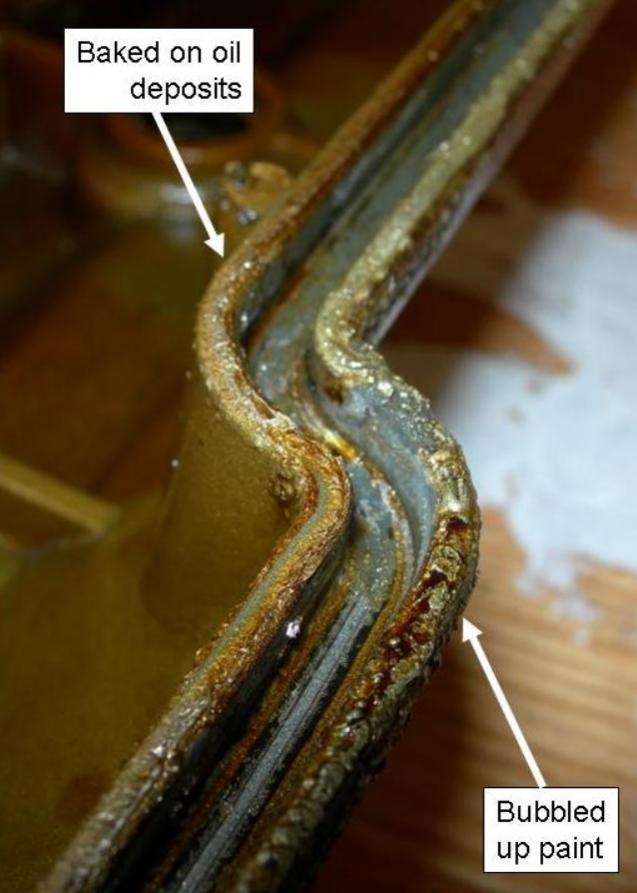

Can I blast the edges that the gaskets sit inside or would that risk creating leaks? Those gasket seats are also painted the the paint is bubbling in various places in various degrees already.

So it's OK to blast the tunnel that the valve cover gaskets sits on to remove paint there? No chance of it leaking if I'm bead blasting it? Should I maybe put a thin layer of RTV to be safe?

Gasket seat is painted? Weird. I've blasted tire beads with glass and they didn't leak after so wouldn't think it'd be a problem to blast. Yes, would avoid blasting inside with anything harder than soda or walnut shells. If DCM stripper won't take it off I doubt those will though.

Yes, I'm not a fan of what they did. It was painted from the factory, here's an example. Last time I opened it up, about 8 years ago, It was already peeling and I took a light sanding block but didn't really go to far into the seat/groove.
Good to know that beadblasting should be OK if needed. My plan is to try with Soda first... see how far that gets me for the outside and then go harsher if needed.. all the way to maybe an alum oxide or black beauty (?).
For the inside, I might just stop at "good enough" for fear of getting anything embedded, possibly messing up the Mg (?), or ripping of parts of the gasket groove seat. Worst case, I can just RTV it with whatever paint might be left.
