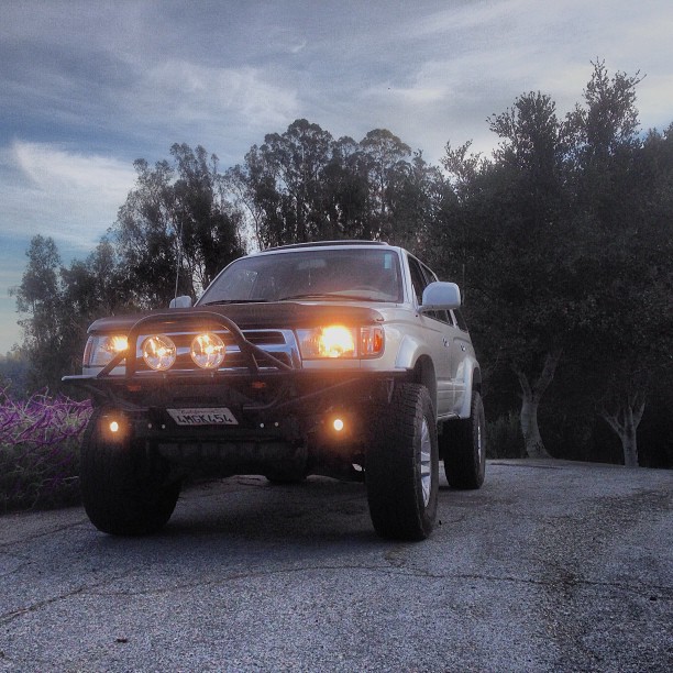

Tomorrow my projectors should be coming in. today I took off my headlights and am using my old ones from my 96.
For reference I have this...
in the oven. At first I did 300 degrees for 7 min. that didn't work so I did 350 and that worked good.
separated
projectors finished yesterday. ended up using my 96 cases with the 99+ lens. like the smooth look. Big thanks to Robert helping me with the retro!
Went with the XB35 4300k bulbs. still in the break in period.
What kind of projectors did you use?
I really like how they turned out with the smooth earlier insides, looks super clean.
I used the mini H1 kit from theretrofitsource.com went throught the Tacoma world GB and got 25% off!
I have to say. You've put a lot of work into this build. Your rig looks awesome. Keep it up Drew!
Also, any plans for aftermarket skids?
Thanks a bunch man it means a lot! I do plan on getting some skids down the road when I start working again after winter.
