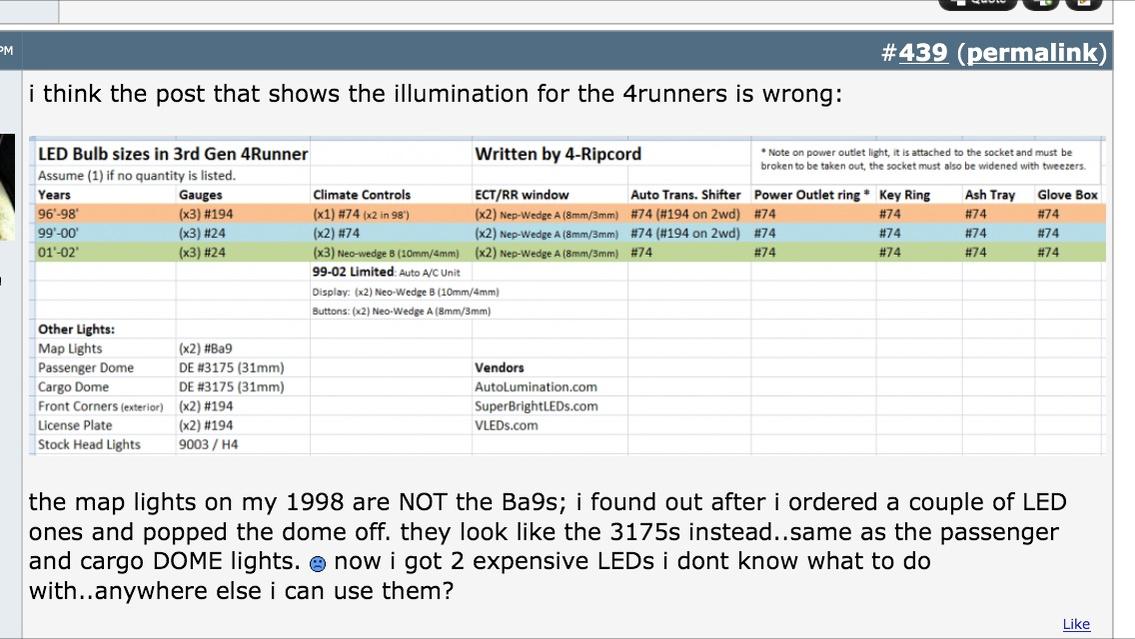

3.I need some help with the dash lights.
just want to make sure I am getting the right stuff:
-3 #194 bulbs for backlighting
-2 #74 bulbs for signal arrows
-1 #74 bulb for heating controls
-1 #74 bulb Trans lever
-1 #74 bulb ignition halo
-1 #74 bulb ECT light
-1 #74 bulb 4WD light
-1 #74 bulb ash tray (white)
-1 #74 bulb glove box (white)
-3 Neo-wedge bulbs A/C, Rear Window, Defrost swithes
Good god there are a million different threads about the LED dash lights and they all are so confusing. some say you need one type of bulb, ones says another. Anyone have the straight answer for a 2000 runner?
Right? Jeeez. I have subbed 4 threads, all saying different bulbs.... If you get a straight answer, do me a favor and tell me?

In the same boat on the led swap. I found this on one of the threads. It's been what I've gotten my info from. Excuse the writing under the pic. It's a screen shot from my phone.
