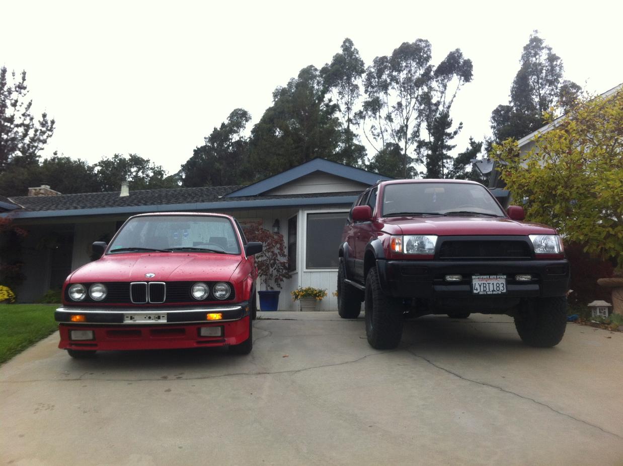

my two cars :driving: bmw finally up and running good!!

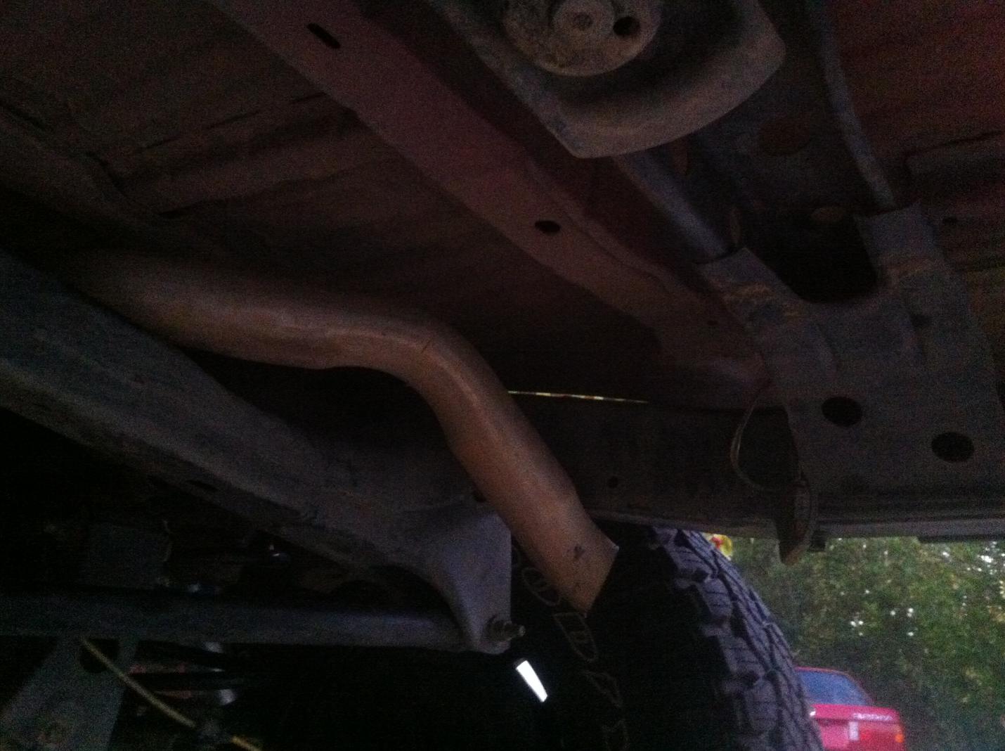

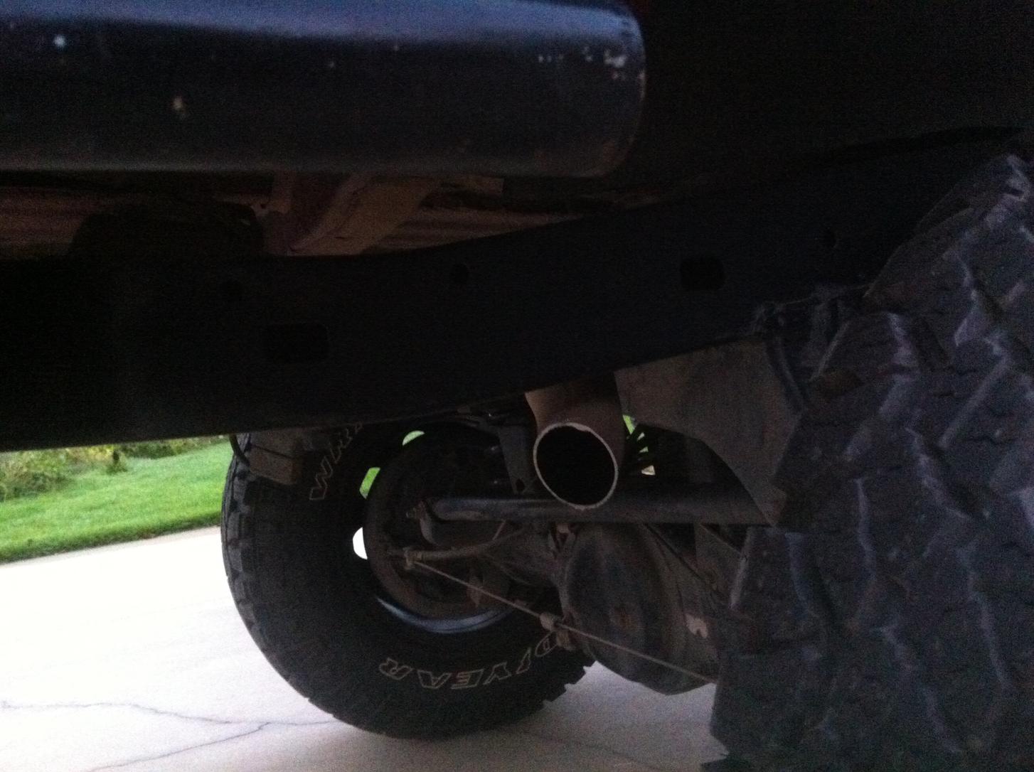

finally cut off the exhaust so it wasnt hanging so far below the bumper. sounds a lot better to now actually!
Looks good Drew. Same spot I cut mine back too.

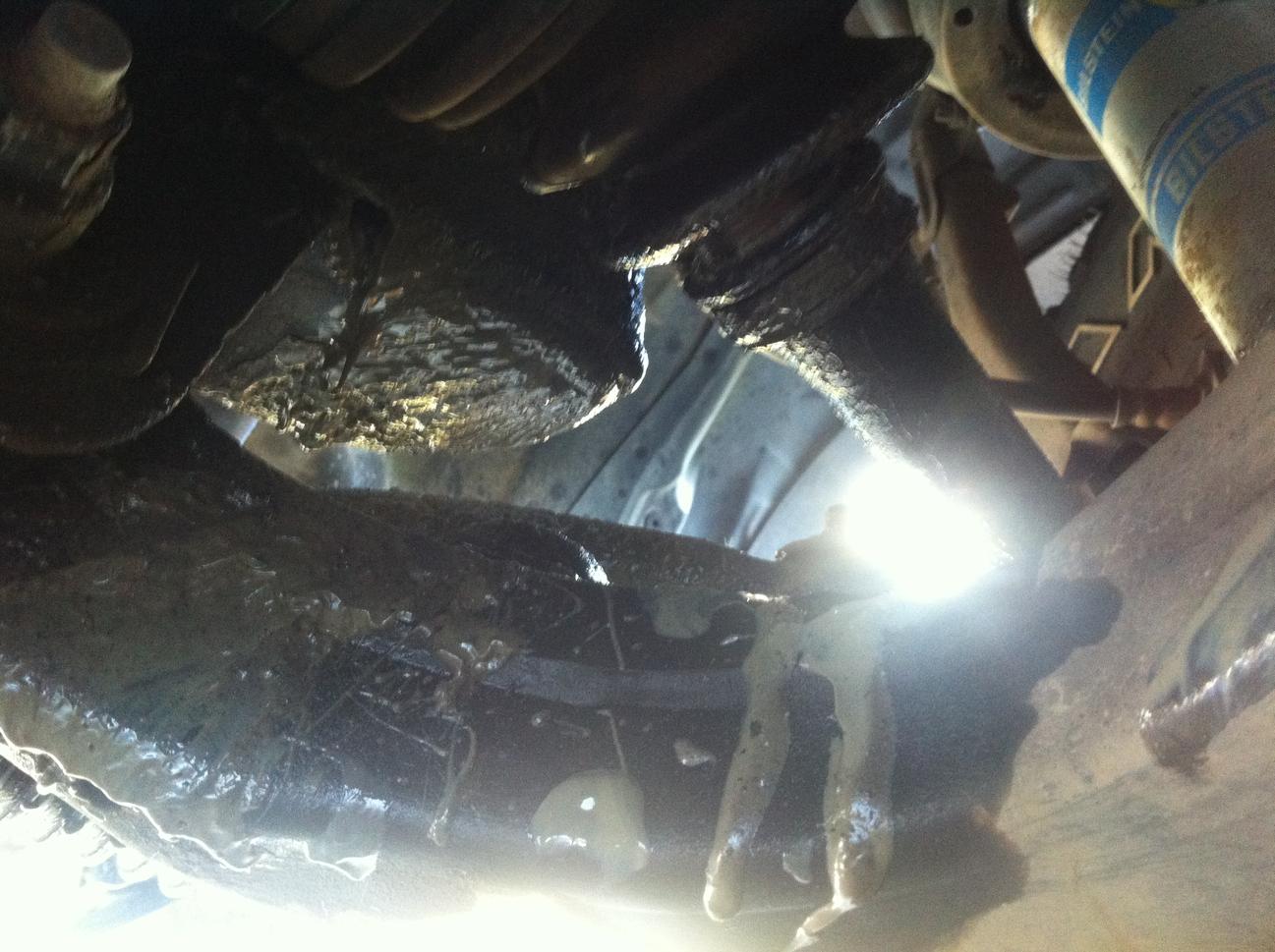

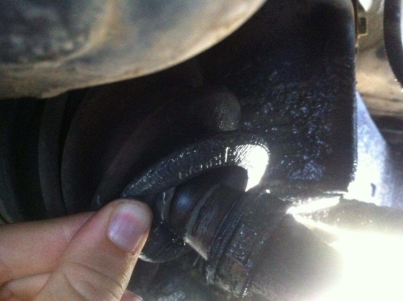

today my left front cv boot finally ripped after 191k miles... right front still looks fine. guess i should have installed that diff drop...
My buddy ripped his shortly after going through the mud bog('99 Tacoma?), and ripped his skidplate. Anyone got a diagram on how a diff drop kit looks/works?
there are 2 bolts holding up the front diff, 2 big ass bolts cant miss it, take those bolts out, put a spacer in between the mount and the frame, put in longer bolt. done deal
