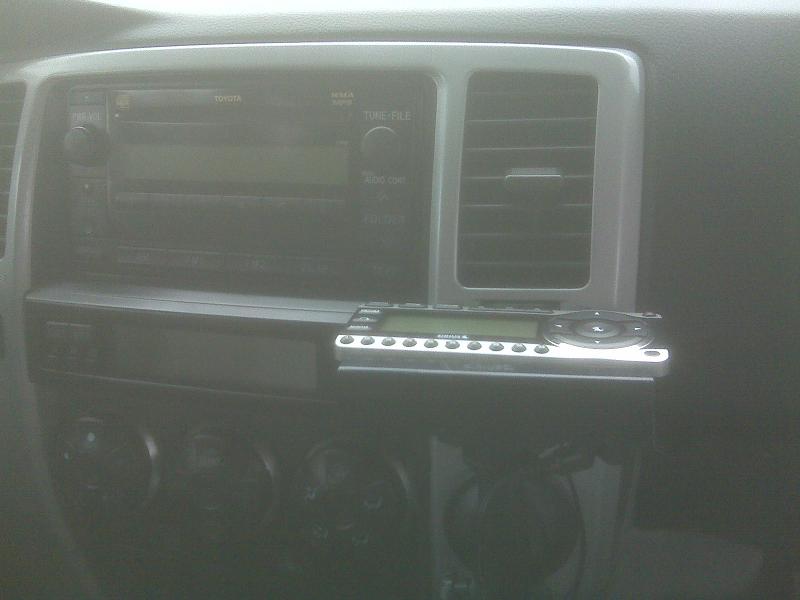

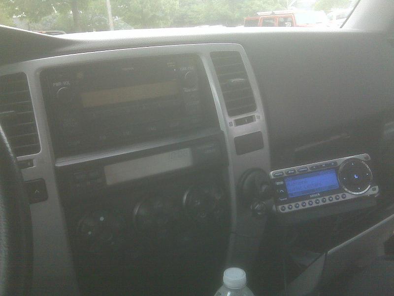

After following some of these write-ups, I also installed mine using the suction cup mount on the right side of the dash under the flasher button.
3525842764
So far mine is holding great (only there for a few days, but it is TOUGH to remove the suction--so I assume it'll hold). For now, I just have the power cord plugged into the cig lighter right behind the shifter in my 2006. I'm thinking of tie-ing into the cig lighter power wire with a cig lighter adapter and mounting all that under the console for aesthetics.

rowdymoose said:
After following some of these write-ups, I also installed mine using the suction cup mount on the right side of the dash under the flasher button. So far mine is holding great (only there for a few days, but it is TOUGH to remove the suction--so I assume it'll hold).

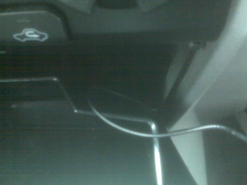

Here's my install, I just decided to get rid of that little cubby. Tucked all the wires and ran the aux wire underneath the shifter through the bottom of the ceter console.
