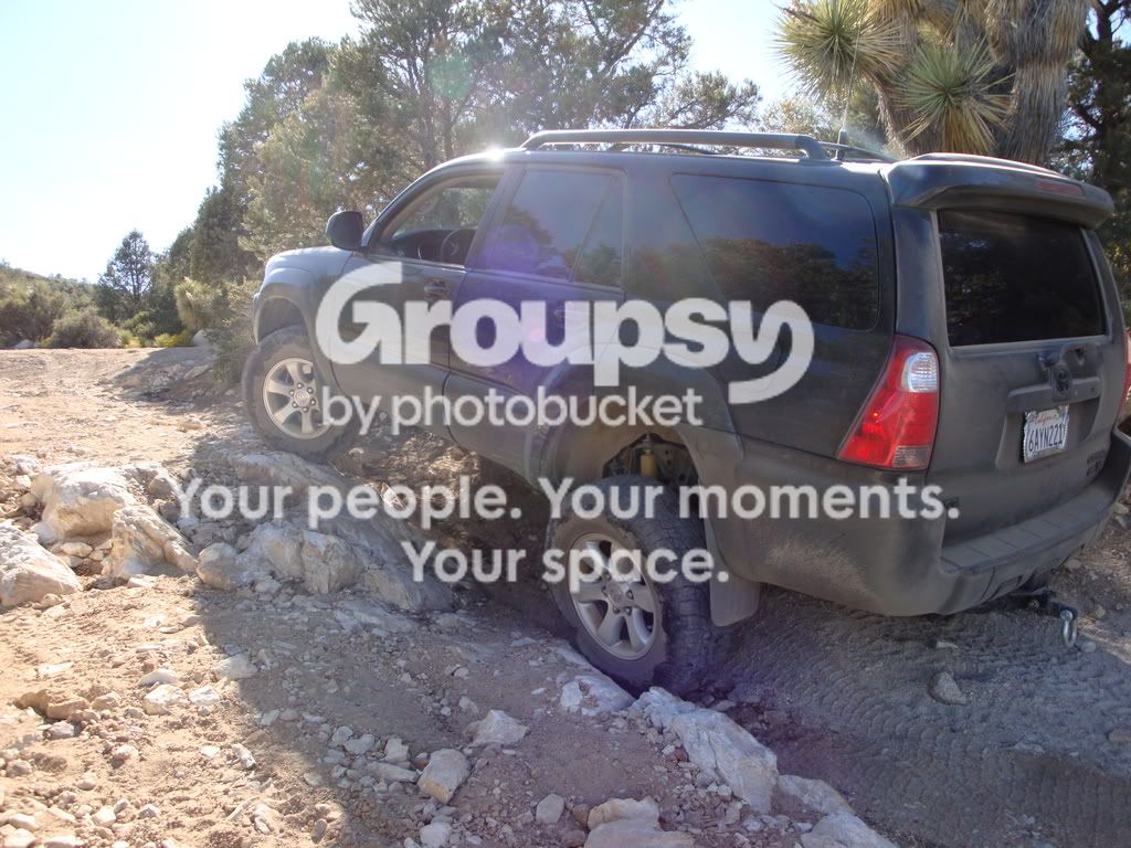

That depends on the stiffness, but generally speaking yes. Here is a picture of my truck flexing in the back when I still had the OME.

If you don't plan on adding a bumper and winch later on then OME will suffice for your needs. But if you think you might get those items, then coilovers are a smart choice because all you have to do is crank them a little to compensate for the added weight.
