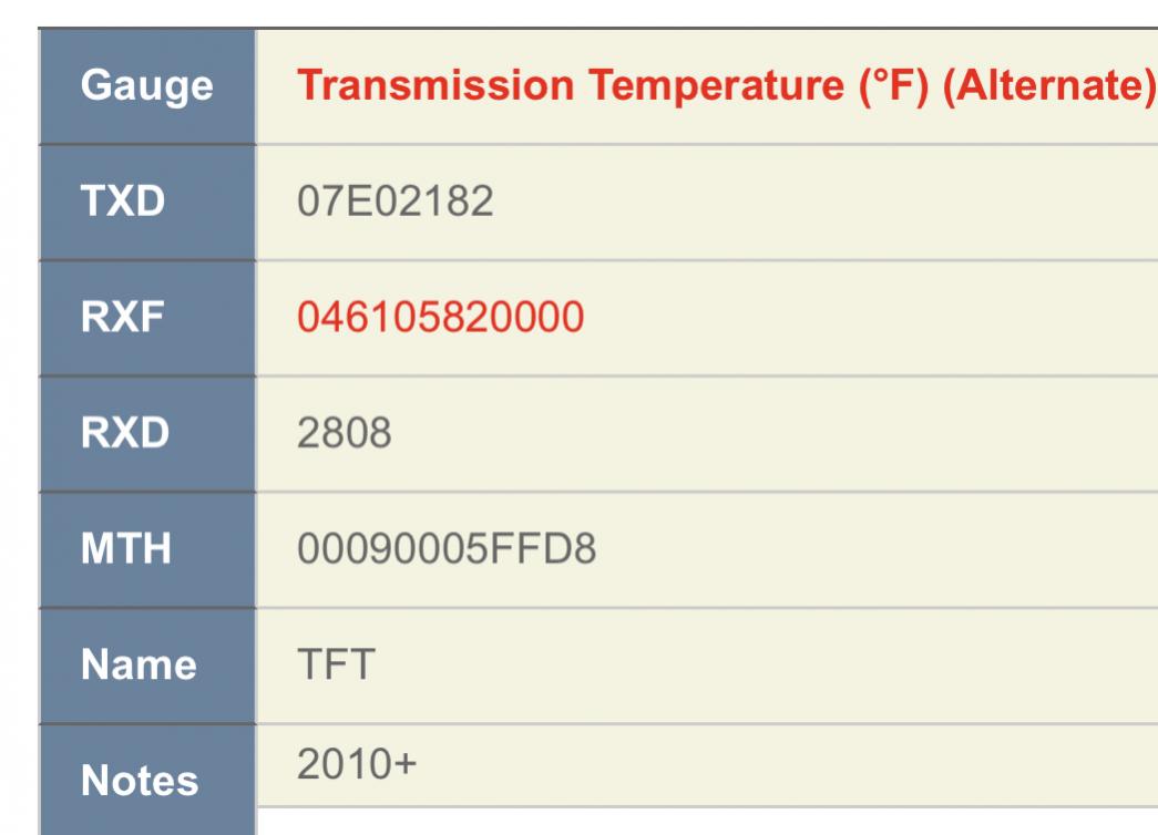

Anyone setting up their Scangauge 2 for both transmission temps here you go,After running through many codes I finally found two that worked for my 2021 for Transmission pan temps and converter temps
Use this one for pan temps and named it TFT for trans fluid temps and made another with the same numbers but changed “RXD” to 3808 ,this change opened up the converter temps ,I named this one TCV for trans converter ,I searched and never found the answer here so I emailed the company and they helped me fix it,figured I’d pass the info along
Huge help I was just messing with my Scangauge and couldn’t get both the converter and pan temps to work. Their documentation is spotty. Thank you friend.
