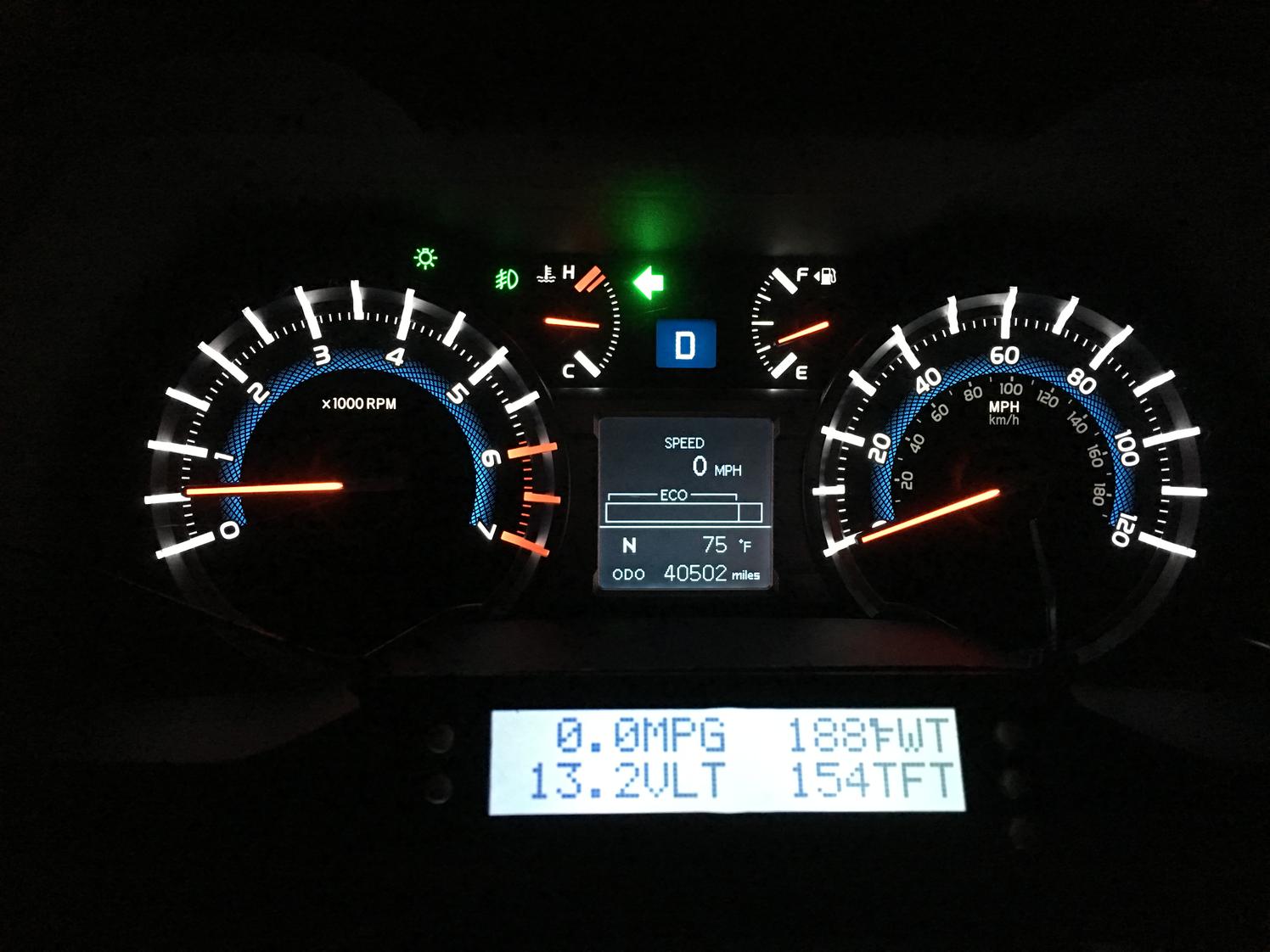

Definitely works. I used the first Trans temp pickup and not the "alt". Not sure which is more accurate or where which picks up from, but it's kicking out numbers, and I like numbers. I read where someone here was finding one more steady than the other. Need to compare with alt temp and a stand alone gauge (but that ain't happening)
Prior to B&M cooler I've seen my Trans temps match my coolant temps (+/-) on long hot days driving on the freeway, and spike to high 190's in stop & go, but quickly come down after some speed and air circulation.
Post B&M, Trans temp consistently 10-30 deg lower than coolant, and can just about match coolant in stop and go, but no major spikes.
