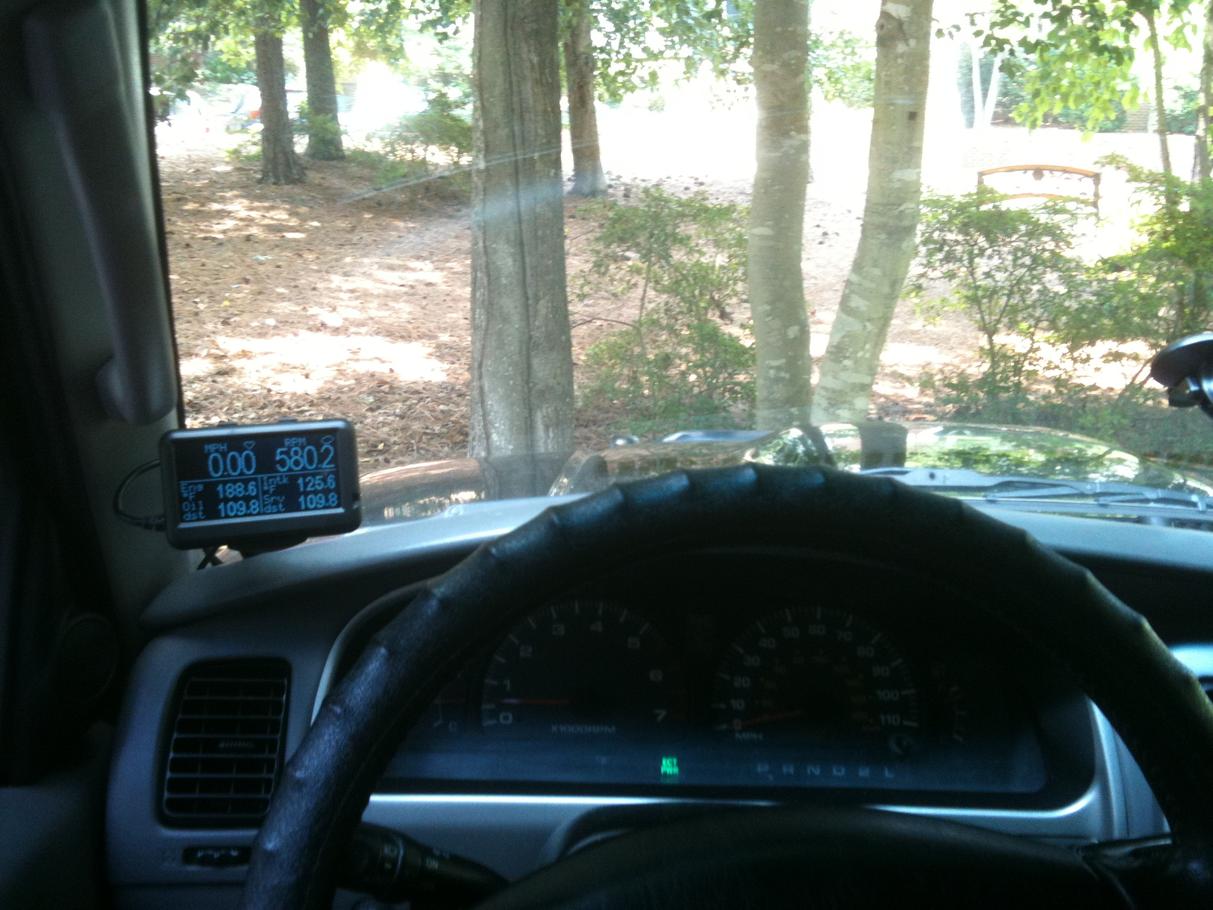

As far as mounting, the blocky, chunky SG doesn't fit easily anywhere. You can see from this photo that I mounted it on the dash with a mount intended for a satellite radio, using some very strong double-sticky tape.

newstuffs003.jpg~original
it should take care of all of your cons, but it cost more than those 2 combined. Like ripcord said it only reads 2 things at a time but you can put it in a cycle mode to switch every X amount of seconds to where it reads 8 (i think) different perimeters. I cant imagine trying to look at a bunch a different things at the same time while i'm driving but that's just me.

aeroforce scangage to the rescue! :hiding:
Wow, that's nice! Much cleaner than either one of my installs.
Plus, I already have a pillar pod, so that's got me thinking...
