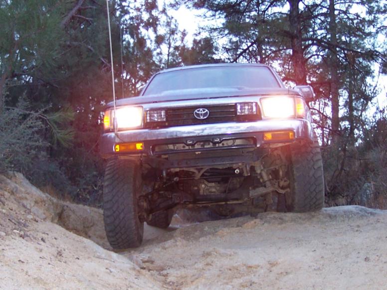

Not to worried about high speed off road but more for being able to help level out the body while the ifs is flexed for more stability on the rocks. Pic for reference.

The maximum droop you can get out of the front suspension without going long travel is with an extended travel/mid travel setup: aftermarket UCAs, extended travel coilovers, ditch the front sway bar.
For the rears, not much you can do without changing the geometry of the rear suspension links. The Metal Tech LT rear setup is about the max droop you can get out of the suspension in its regular configuration: extended length shocks, springs, lower bumpstops, longer brake lines, and changing out the links.
I'd just remove the front swaybar, or look into detachable end links (there was a prototype on the forum a while back IIRC). See how far that gets you. If you're still not happy with the flex, you could be the first 5th gen guy to do a solid axle swap!
