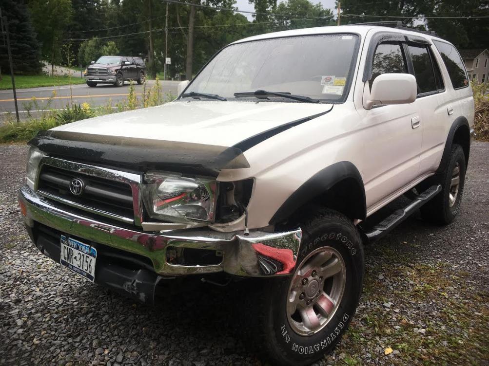

1996 SR5, 124K on it, nice and clean, this is my baby, not my daily driver.

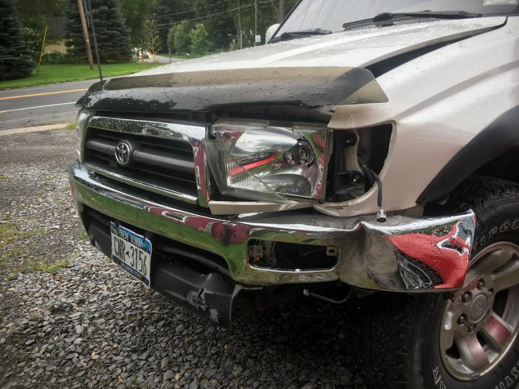

Came away from a harrowing experience last night, wet, elevated highway overpass, banking, curving, suddenly, 2 complete 360's, a bit of concrete retainer wall pinball, and I came to a rest. No one was hurt, no other cars involved, and a nice cop with a crow bar wrenched the bumper far enough away that I could drive home without further issue.
Damage is limited to mostly the bumper, which I just removed, driver side mount is slightly bent. Grill is fine, hood is fine, uninvolved, that's all fender damage creating the bad sight line.
So, rather than go with some cheapo replacement bumper, I'm choosing to use this as an upgrade opportunity, since I'm self insuring this one.
I do not do serious offroading, so I don't really need anything insane, but mounts for lights so I can kick up my rather abysmal headlight output (dang deer are everywhere). I'd prefer to spend less than more, as I need to get a fender painted and mounted, and the front end otherwise put back together.
I know nothing, looked at a few, seems $750 to $1000 is the average. Some require modifying the mounts somehow? Haven't looked deeper yet, would appreciate some insight on how involved that work might be?
