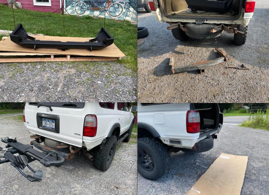

Well speak of the damn devil, the bumper shipped today way ahead of schedule! Was quoted end of October initially. And now oddly enough it's no longer available from CBI? Must've gotten lucky

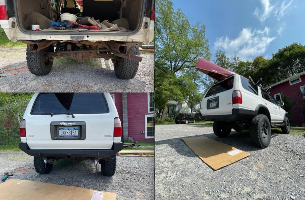

So, yeah, it was a bit of a process. Got the OEM rear off fairly easily, had to destroy a couple things, but I wouldn't be needing them again, so, all good.
The hitch mount was the biggest PITA. I got three of the 8 bolts out, and broke two, stopped.
Oxyacetylene torch first thing Thursday morning at a buddies garage, got the remaining bolts out. What a great feeling, watching that thing drop to the ground....
More grinder destruction to get the old bumper brackets off, a bit of head scratching how to do the install myself, but clamps, muscle, patience, and thankfully, a pocketed design that allowed it to hang freely on the frame rails once up and in place, made it possible.
I'll look into the stuff you're talking about with shock mounts, but for now, the rusted out hulk is gone, the spare tire, temporarily deleted till I find a good used tire (the EOM one is 25 years old, jeeeeeebus...), and this thing just looks soooo much better!
