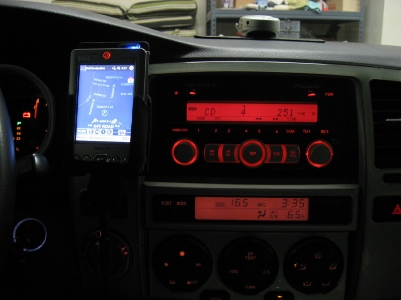

I have a T1808 installed and the sound is awsome. It is a huge improvement over the stock HU. I love it.
Does this model work with the steering wheel controls as well?
Where did you find it?
Thanks.
Yes, steering wheel control is still working after installing T1808. I got it brand new off ebay for $100.

ksneubec said:
Thanks for the replies.
SDSH- where did you get that GPS mounting bracket?
It is from ProClip. Here is the link:http://www.proclipusa.com/vehiclemounts/vehiclemounts.aspx
There are two parts of the ProClip system. Part one is your device specific holder (Device Holder). Part two is your vehicle specific dashboard mount (Vehicle Mount). The Vehicle Mount attaches to your dashboard and then the Device Holder attaches to the Vehicle Mount. I just bought the Vehicle Mount and reused my existing holder. I attached the holder to the ProClip mount using Industrial-strength Velcro tape. I like this mount because it is stable and was tired of the vibration of my old gooseneck windshield mount.
