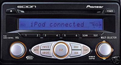

My "new" Scion 3-knob unit is in transit. $150 off of EBay plus shipping

The seller was pretty lazy about responding to my questions. I am guessing that he was grumpy because similar H/Us were going for almost twice as much! I found his right when it was listed and it had the "Buy It Now" at $150. It is crazy how this new model has depressed the prices of the previous single-knob H/U. I saw one new in the box close at $23 plus shipping!
I have seen them listed under the "Pioneer" category, under CD Players and "Parts and Accessories\Other. You have to search well. There is a new 3-knob unit on right now with a first bid of $9.99
04-06 Scion xb/xa/tC Sat/Ipod ready/Stock radio Item number: 4643723986

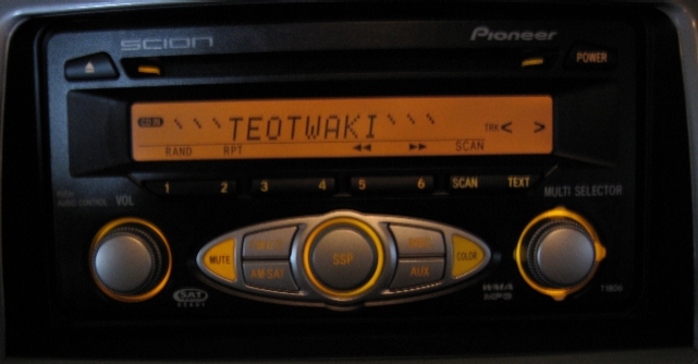

It came, I saw, I installed!!!
jharris2 said:
Hope it arrives in time to be this weekend's project!
I am so impressed with what a huge improvement I got for my $150 and I am SO GRATEFUL to all who posted so much, especially that one web page on removing the Nav Unit.
Picture below with new greeting ;):
