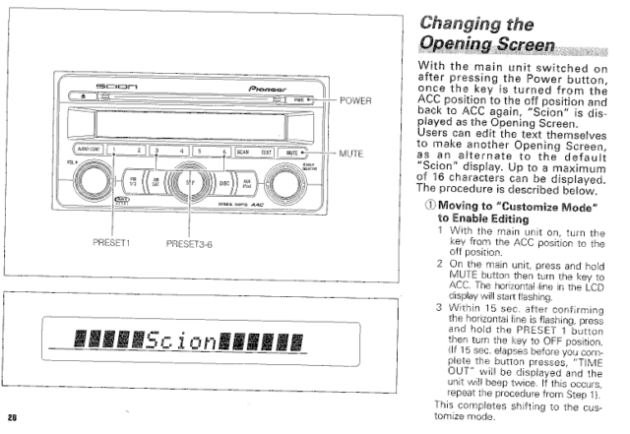

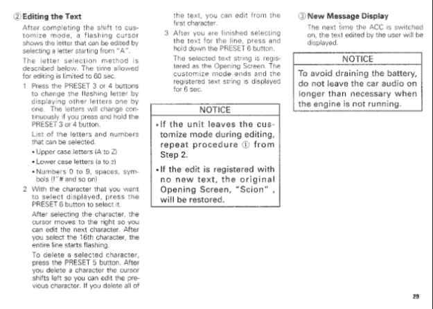

One more question though, I have the single knob scion cd player, and was wondering if you can change the "scion" text to read something different?
TIA, Jason.
96dcmss said:
Ok, I installed it a little while ago. Answered mt own question;): , there was one big antenna wire and one small, the scion unit used the big one.
TIA, Jason.
Hi 96dcmss
You can try the procedure from t1808 ( I put the entire procedure below)
I hope that the information can help you,
