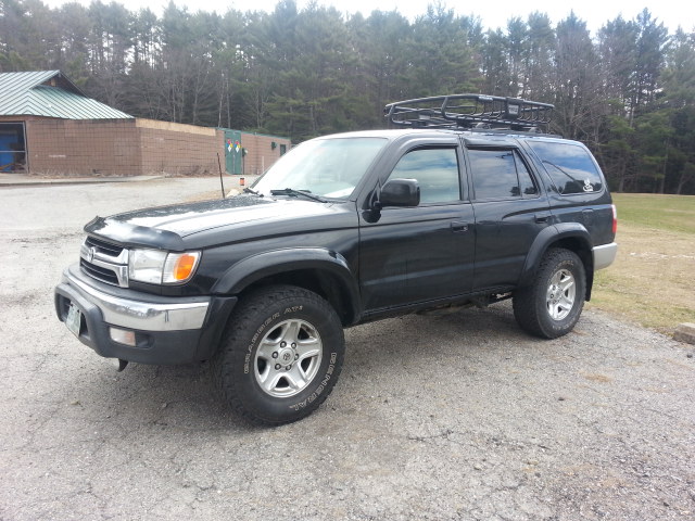

Current Pic
Specs:
3.4L auto 4X4 SR5
175,000 Miles
Current set-up
>Stock suspension
>265/70R16 General AT2 Grabbers
>Removed intake silencer
cut hole in air cleaner box
Added K&N filter
>Thule roof rack
>KC 5" Appollo front driving lights
>Removed running boards
Future build items
Suspension: Toytec Ultimate
>Front: 650# coils +200LB/Bilstien 5100 shocks
>Rear: Superflex 024RCB:3" +400LB/Bilistien 9602R703 5100 long travel shocks
>Extended brake lines
>Panhard drop bracket
>Rear control arm skids
Also plan to add front and rear bumpers, rock sliders,skid plates,winch and offroad lights.
I plan to start ordering my suspension parts in a couple of weeks so I will keep thread updated as I progress.
Welcome to the forum! Truck looks really nice! If its not just my eyes then you mounted your KCs under the front bumper? How is the light output from down there?
Your list looks like it's gonna be fun! You'll love the ultimate kit. Any plans on bigger tires once you lift it?
No your eyes are good, just there for now until I get a new bumper. Mine has a small rust hole and someone at work hit it and ran. They are very bright though. My plans are to get at least some 285's under it.
Thanks for your input on the toytec lift, I was hoping someone would comment on my choices. All im going on is what people on this forum have used. where i live all you see is tons of Jeeps lifted no runners.
