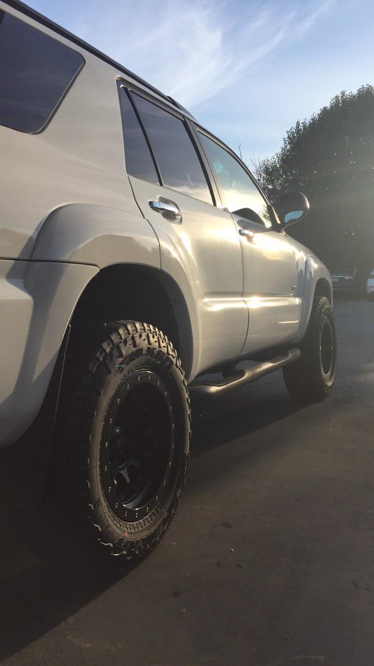

I'm wondering what mods you needed to get those to fit? That's over a 33" tall tire!
Yeah it's a huge tire and I love it! So I've got 1.25" spacers to clear the stock UCA, a lift with Bilstein 5100's all around with OME 885 in the front and FJ springs in the rear. Moved the fender liner forward, removed the front mudflaps and did some slight chopping of the bumper.
Just got the OME 885's installed yesterday, will try and take some pics today! Hard to say lift amount.. I'd guess 2-3 inches. Will take some measurements later.
Interesting.
From what I understand, the OME 885's will net about 2.5-3.0" of lift. That's comparable to the Daystar 2.5, which netted me just over 3" of front lift.
With the 265/70/17 Falken AT3W tires, I had to do quite a bit of work to get the wheels to clear up front - Cut front bumper, move fender liner 1" forward, and trim the front mudflaps. Granted I have an aggressive -10mm offset on my 17x8.5 wheels, but it's comparable to stock wheels with a 1.25" spacer in terms of where the wheels sits relative to the fender.
Given how close my wheels come to the body, I'm surprised that you didn't have to do the body mount chop with that tall of a tire and only the modest lift.
Eager to see pics when ready
