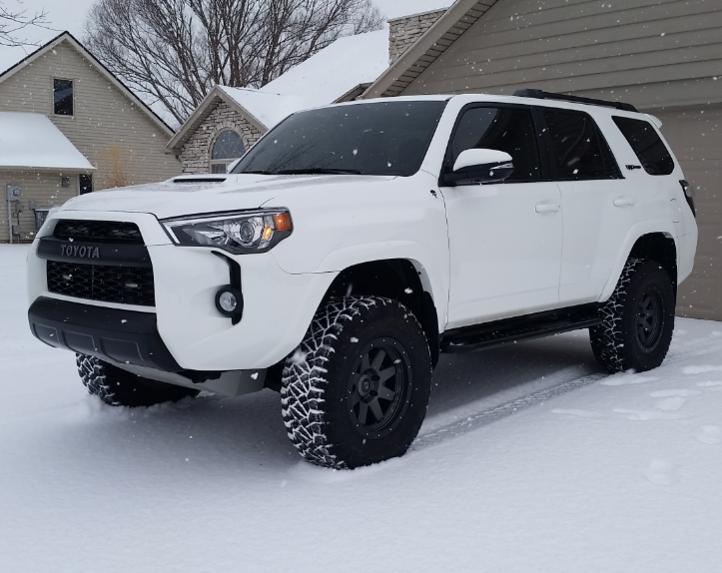

Here’s a pic from way back when.....

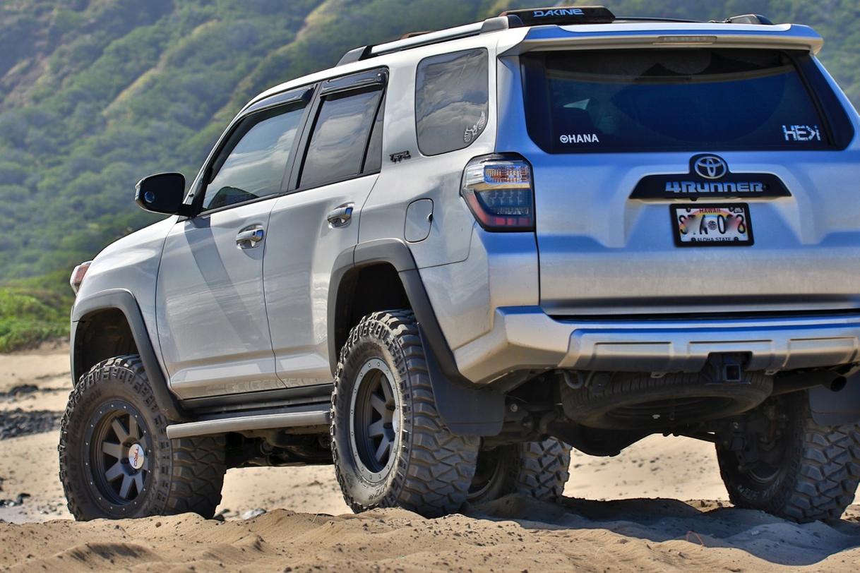

I ran 285 BFGs with 1.75" BORA spacers (see picture) on stock TRD OR wheels and 2.5" lift which would end up being about .5" more aggressive than your TRD PRO wheels with 1" BORA spacers. All I did was relocate fender liner and trim the front bumper. Had zero rubbing.

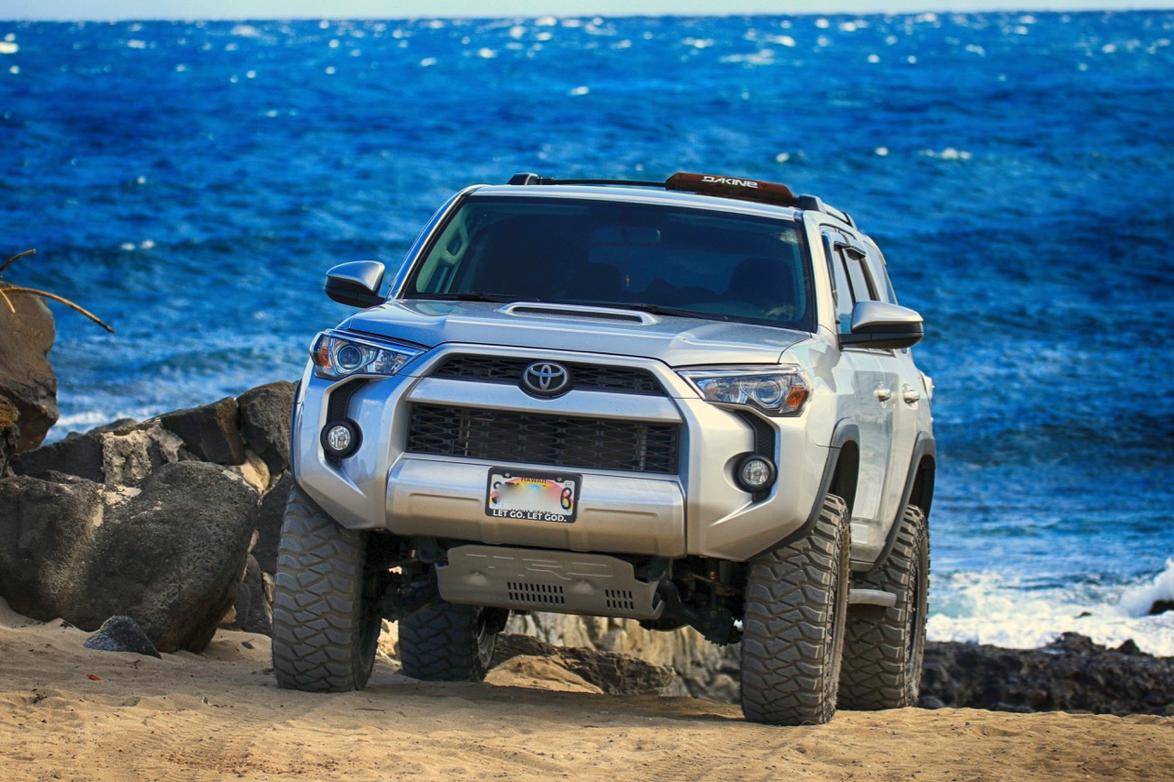

I actually get asked A LOT if I'm on 285s. I think its the combo of a slightly larger than stock AT3Ws, poppy gold, and black "beadlock"
then more on ig. same handle as here.
Wheel width and offset makes or breaks a tire size too. Wider wheel with more aggressive stance usually makes the tires appear much bigger. Looks killer btw.
