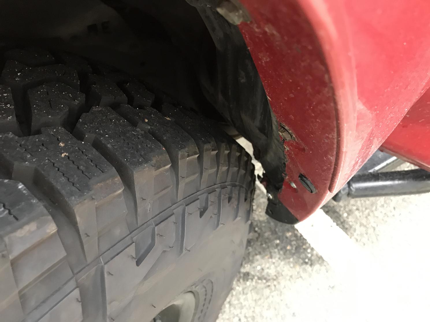

17x9 -38 F5’s on 2.5” Front lift and 2” rear lift and 285 KO2’s. A good bit of front bumper and fender liner trimming. Also trimmed the body mount. Removed mud flaps. No issues.
17x8.5 -10 with 285s would be easy to fit. 265's would be almost no work.
Do you have any pics of how much you trimmed off? Just want to get an idea.
Yeah, I see you went beast mode! Looks good. Did you grind down some of the body?
Thanks! I need to do a proper BMC (currently just have it trimmed enough to clear the 295s off-road) and pound down the pinch welds and hammer on the firewall a bit and then trim up the fenders some more. Then take it off road and figure out where else it needs some work.
Yeah, I hear ya. I’m running 285/75/17’s on a 2.5 lift. got a bit of work to do.
