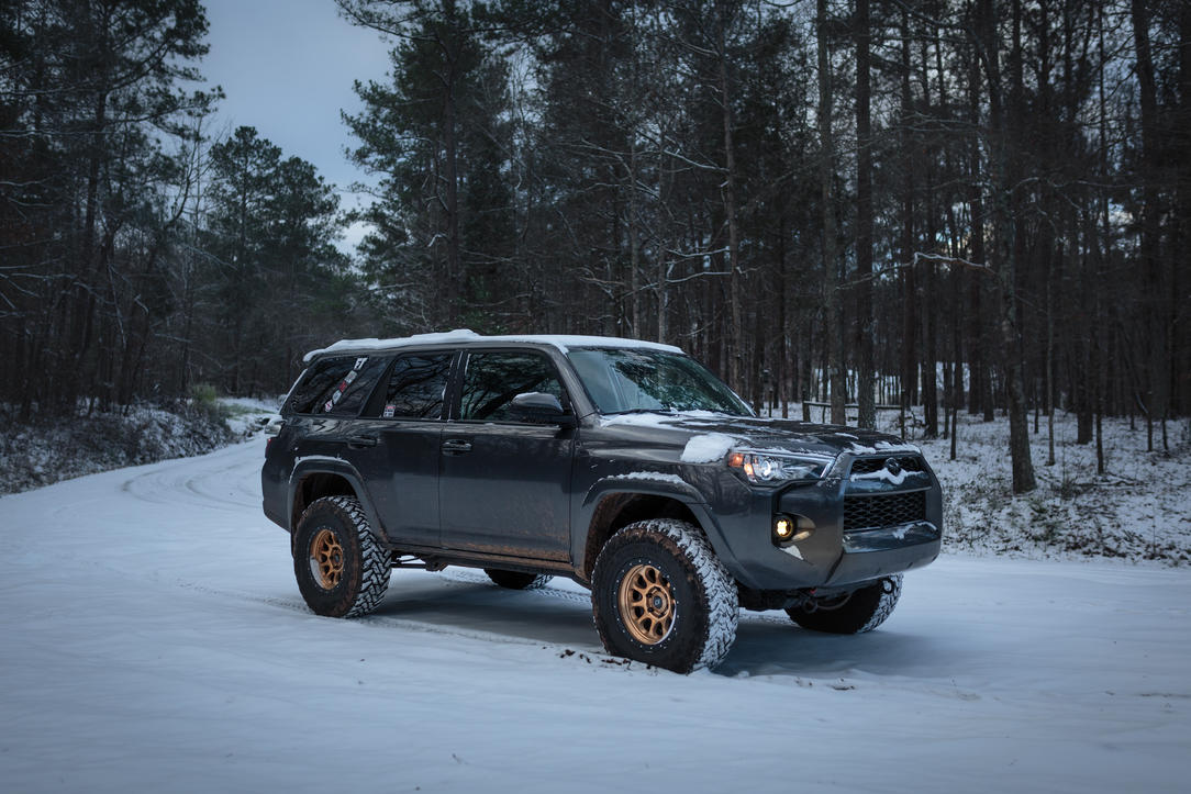

Brushed copper
ray 10's and toyo m/t 285's. going for 35's when these wear out :hatsoff:

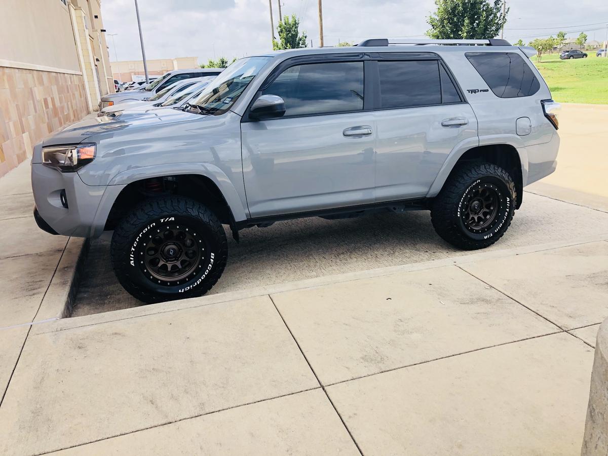

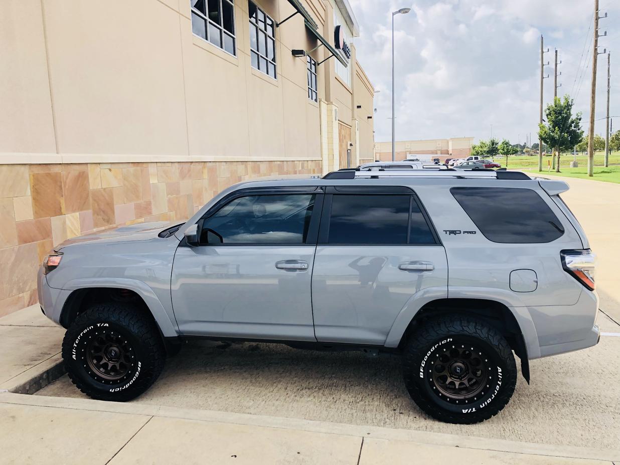

Running 17x8.5 SCS Ray10 -10 offset with 285 ko2’s...2”/1.5” Lift with no rubbing...switching out to kings suspension in coming weeks

Were the 285's on the stock suspension? Just ordered a pair of SCS Ray10 for my 2017 Cement Pro and plan on going with 275 ko2s and was wondering if there will be any rubbing with the offset and going up on the tires. What do you think?
