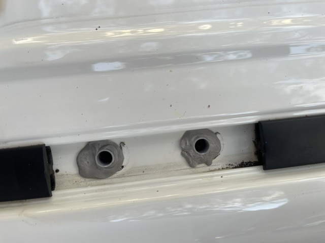

Here is what I did with my Gobi rack. Used Butyl tape. So far it has been 8 months with no leak with heavy rain here in South Fl. Very happy with the outcome
Make informed choices when deciding what to use when sealing roof rack mounts.
Destroyed Factory Roof Mounting Locations
This is a bad reference though. The OP later explained how the damage in the initial post happened.
He never once inspected the seals after putting the rack up. This happened more than 5 years after installing the rack. He linexed the roof up to the seams of the rack. He kept it outside in Hawaii for 5+ years, and had annual periods of up to 6 months at a time where it was never moved.
