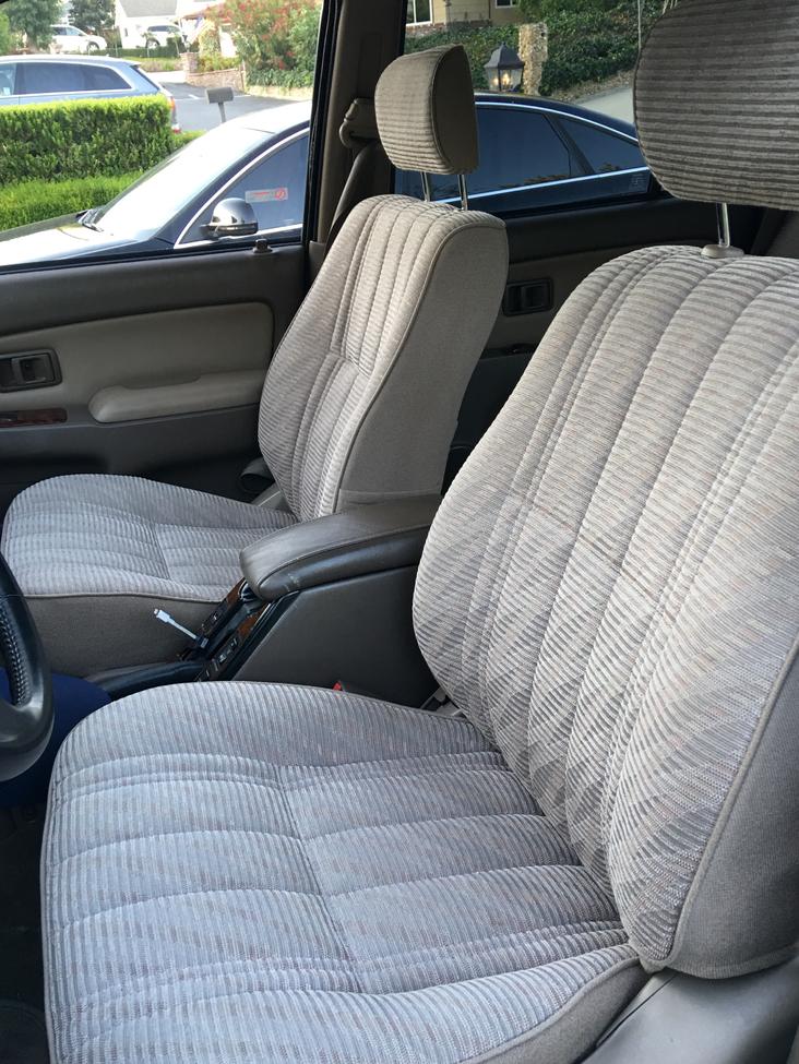

Sorry for dark pic, but here are seats reinstalled
