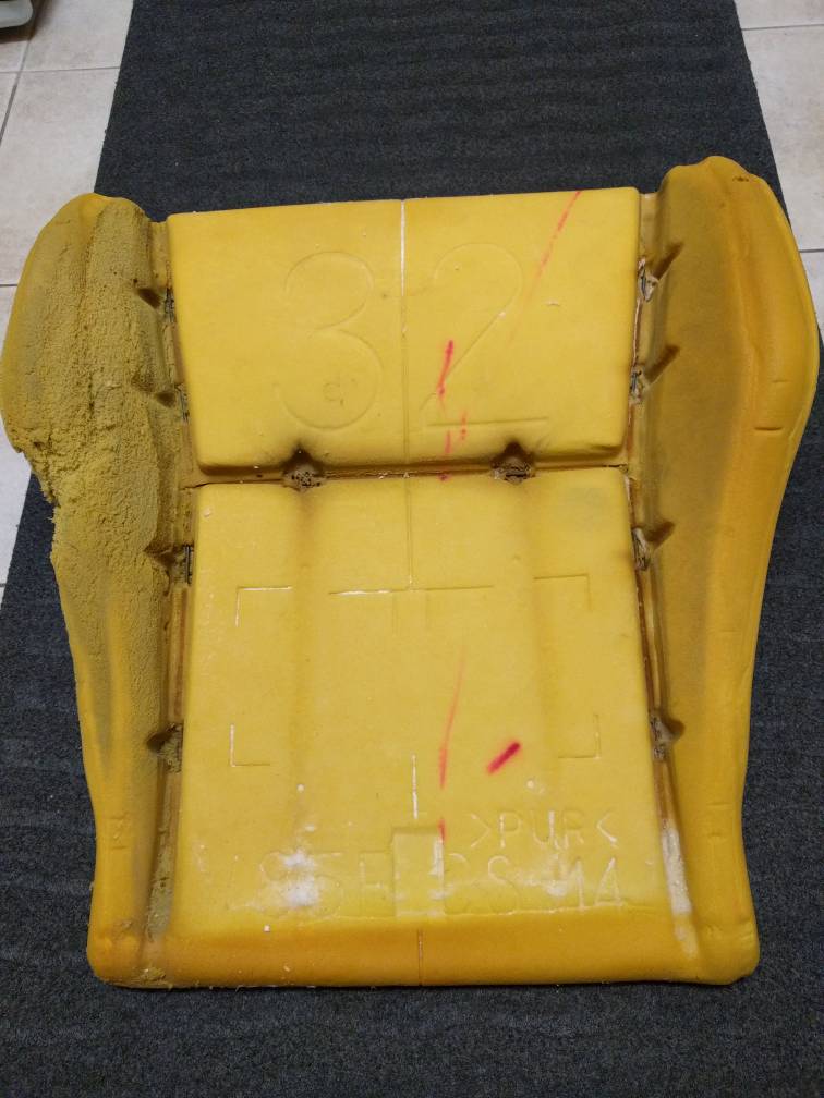

99 seat foam
Sent from my Nexus 5X using Tapatalk

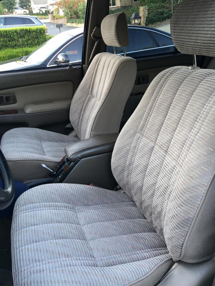

Are these the standard cloth seats for a 3rd gen 4runner?
Those are the '99/'00 'base' model seats (used on base and SR5 4Runners without the 'sport' seat option). The 'sport' seats have a height adjuster and lumbar adjuster on the driver's seat with more bolstering.
