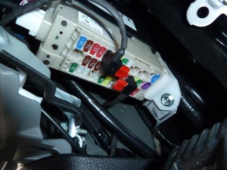

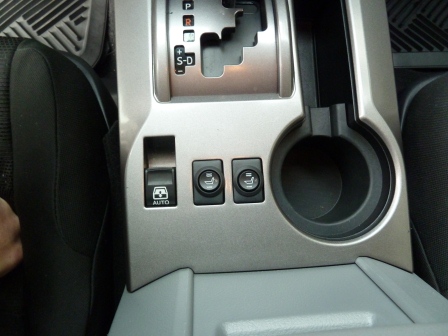

Similarly, I did not want the round switches. Toyota's rocker switches ranged in price from $53 to over $100 for one switch. You'll have to dremel out the lower plastic where the dummy plugs went in to take the larger rectangle rocker switches, but it's not a big deal. They come with an extra-long wiring harness, as in way too much. I coiled that up, zip tied and stuffed one under the rear part of the console and the other next to the shifter. Placed the wiring in one of those plastic spring covers and ran under the carpet along the tunnel under the driver's seat where Toyota ran a wiring bundle, then up under the door sill cover and up the front pillar to the fuse box. Both heater wires to a mini fuse tap with 10A fuse and both LED light wires to a mini fuse tap with 5A fuse. They are working fine. You could just join those wires under the center console and just run single wires to the fuse box for the switches and LED lights. The wiring is the easy part. Taking apart the seats is the tough part. Though I have hog ring pliers, I zip tied back together.

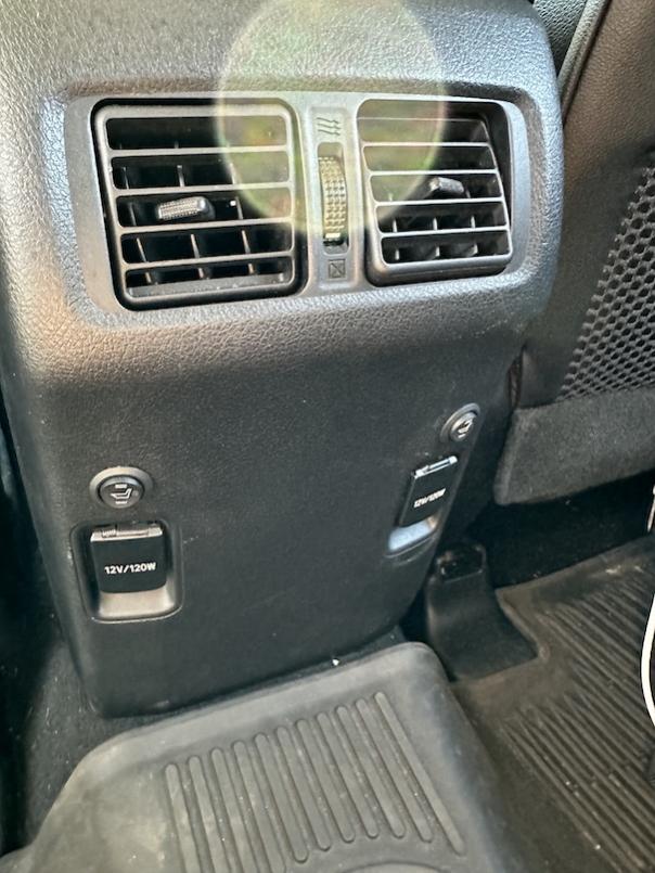

Here is where I put the switches:
That's great! Exactly where I thought of putting the switches! How/where did you run the wires?

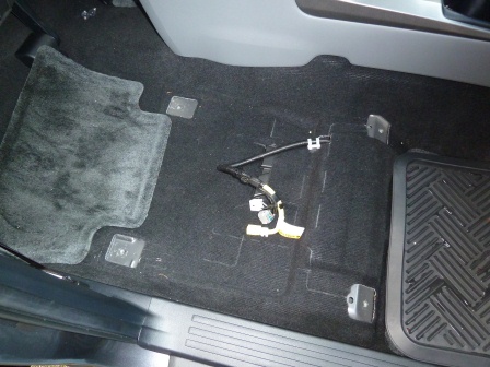

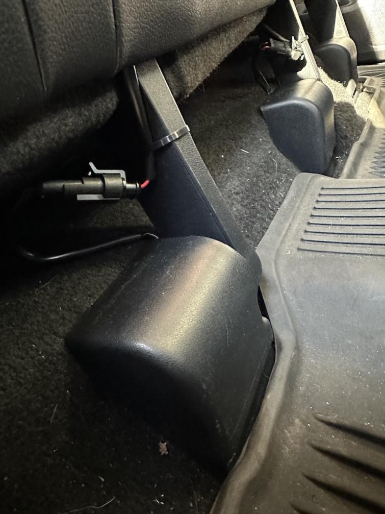

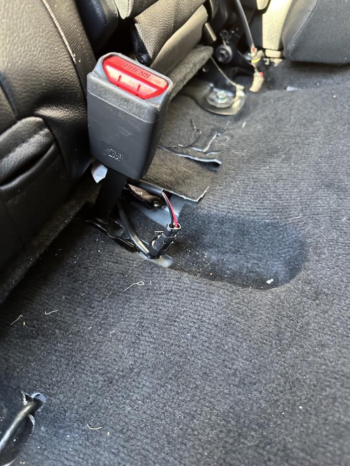

Wires go under the carpet to the rear seats to the holes where seats floor mounts are. Will post a pic a bit later.
As for the switches, it’s surprisingly the only location I found to fit them in. The space behind this panel is very limited. I initially wanted to put Toyota-style switches but they turned out to be way too bulky so I had to rewire it (practically did this installation twice :doh:). These switches on the pic above are the smallest I could find.
Was also considering installing switches on rear door panels - there seem to be way more room even for Toyota- switches. But fishing 5 wires though the flex rubber hose felt like huge pain in the butt.
Here you go...
(for obvious reasons I didn't remove the carpet :biggrin1:)
To fish the wires through you can just remove the plastic side step and lift the carpet one side at a time. Also remove the lower portion of seats and remove the plastic guards around the front seat mounts - it will make the process so much easier. But still be prepared to get a few cuts on your hands ;)
Ah, and unbolt the central console and slightly lift it up, no need to remove it.

Here you go...
