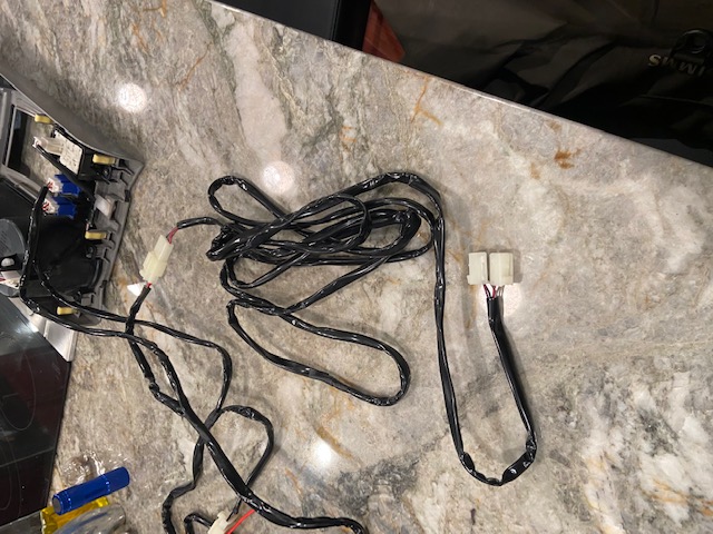

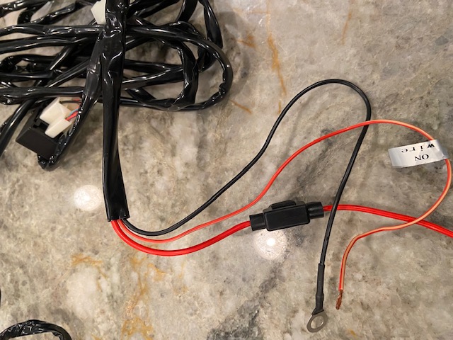

3-Wire Install
In the middle of installing this kit bought off Amazon. The kit I got has two position (Hi/Low) rocker switches. Wire harness has Red, Red/Yellow stripe and black wires. Instructions for Single-Dial Switch kit describe same number of wires and say to install Red/Yellow stripe wire to Ignition Positive 5 amp circuit. Is this the same as the positive on P/RND plug?
Also, the harnesses have quite a bit of length to the plugs to the warmers. Should I bundle excess and leave in the console?

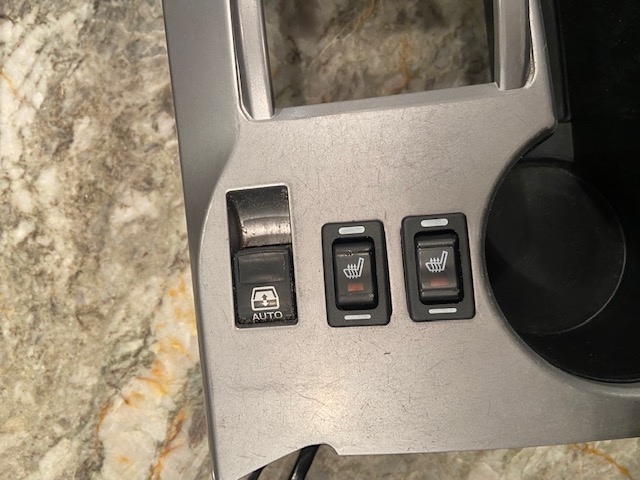

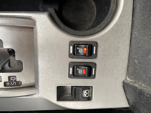

Install Completed
Like others said, would take half the time the 2nd time around. Removing plastic pieces from the seats is a pita and just feels like you're breaking the parts off. Warmers work well and my wife is happy: warm booty = happy wife.

Similarly, I did not want the round switches. Toyota's rocker switches ranged in price from $53 to over $100 for one switch. You'll have to dremel out the lower plastic where the dummy plugs went in to take the larger rectangle rocker switches, but it's not a big deal. They come with an extra-long wiring harness, as in way too much. I coiled that up, zip tied and stuffed one under the rear part of the console and the other next to the shifter. Placed the wiring in one of those plastic spring covers and ran under the carpet along the tunnel under the driver's seat where Toyota ran a wiring bundle, then up under the door sill cover and up the front pillar to the fuse box. Both heater wires to a mini fuse tap with 10A fuse and both LED light wires to a mini fuse tap with 5A fuse. They are working fine. You could just join those wires under the center console and just run single wires to the fuse box for the switches and LED lights. The wiring is the easy part. Taking apart the seats is the tough part. Though I have hog ring pliers, I zip tied back together.

Now, the electrical was a particular nightmare, as there aren't really any good "standard" processes for running the power. So, like everyone else, I improvised and took a few lessons learned from several others on this thread. I used an add-a-circuit tapped directly into the fuse panel for the 20A seat heater slot. I pig tailed the add a circuit and ran both hot leads from the left and right seats to this single power tap. I ran the ground loops to the emergency brake mount bracket which is directly forward of the fuse box. I spent the rest of the time wrapping, looping, and zip tying a lot of excess wiring up under the steering wheel. Unfortunately, the "green" illumination wires which run to the switches I didn't connect. The reason is that one of the switches illumination didn't work. So, opted just to cut both wires and then capped them off. I still get the orange lights when the heaters are on, Just no green illuminated dials when the headlights are on.

I wired both seat heaters into the single seat heater fuse location with an add-a-fuse. They work great. For whatever reason, it took about an hour of continuous use to get them to heat up for the first time. Since that initial burn in, they heat up immediately and get nice hot. Weird but oh well. They work!
Ordered the Clazzio seat covers and their Toyota style seat heater with switches. Still waiting for them to arrive, but want to get familiar with how to wire them.
What’s the easiest and safest way to wire these? I don’t care for the backlight on the switches themselves, but just want to make sure there’s no power to them when the car isn’t running to prevent battery drain.
From reading this thread, the simplest way seems to be using the add a fuse, but I see various methods of how users are hooking it up. Some use two add a fuse, some tie both power wires from both heating pads into one add a fuse, etc. How do you know which fuse(s) to run? I also see different amps being used and it’s confusing me even more.
