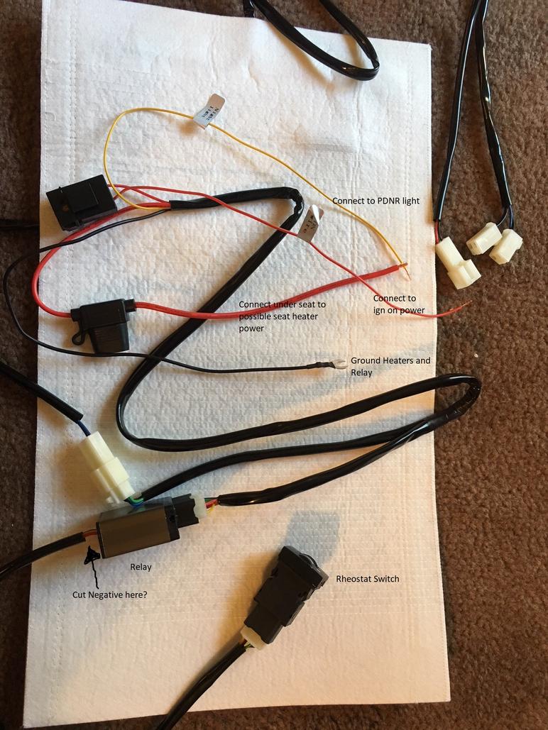

Has anyone tried to wire the ebay seater heater kit in to the dimable circuit. I know enough about electricity to shock myself every time i change a light bulb, so looking for advice before i start a fire.
Here's what i'm thinking
1. rheostat switch for seat heater only requires negative wire for lights
2. Dimable lights are controlled by a rheostat on the negative side of the circuit
3. seat heaters and relay need constant ground but switch does not.
If i disconnect the negative wire between relay and switch and tap into a negative wire on the dimable circuit it would dim both the switch light powered by the(on wire) and (night light)
The negative wire that is grounded is still connected to the seat heater and the relay giving both the constant negative
Or am i missing something?
