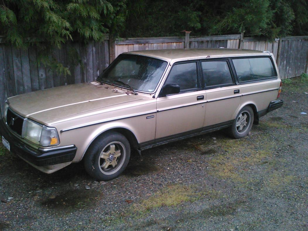

If you need help with your Volvo i'd be happy to come down some day and give you a hand for free. what year make model engine etc? whats wrong with it?
Hell yeah that would be awesome. Its a 87 240 wagon non turbo automatic. The fuel pumps are not turning on and ive already replaced the ignition switch and relay I'm just not good with electrical problems. Well at the very least ill cover your gas to come down. heres a pic of her i call her Goldie locks. She was my grandmas. I got her after she passed. My gramps gave her to me because i have been trying to get my grandma to sell it to me for like 2 years.
This is going to be Kendles car. My volvo is a little better than hers lol but also not running, but im not worried about that one at this time

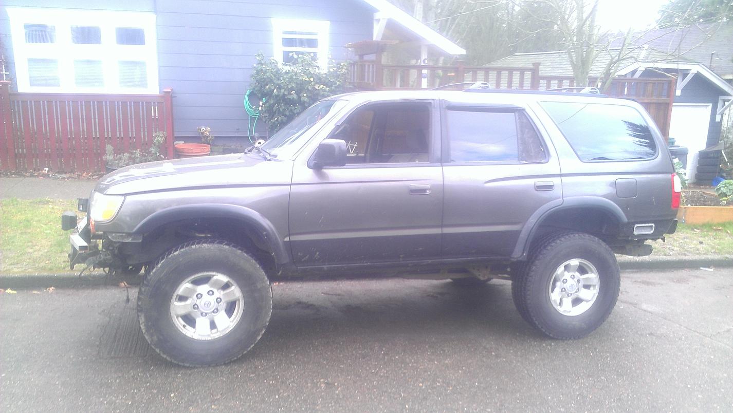

My custom front TRD 5th gen Tacoma suspension is done! Removing the old suspension took 16 hours... rusted and spinning bolts suck! after cutting, shortening, and welding very carefully the new TRD bilsteins it only took 4 hours to install. gained right around a perfect 3" of lift over stock. And the ride is amazing. it is soo smooth its unbelievable

I am still finding mud from the darn pit under the truck, i have pressure washed it twice already. i need nobbier tires for that pit

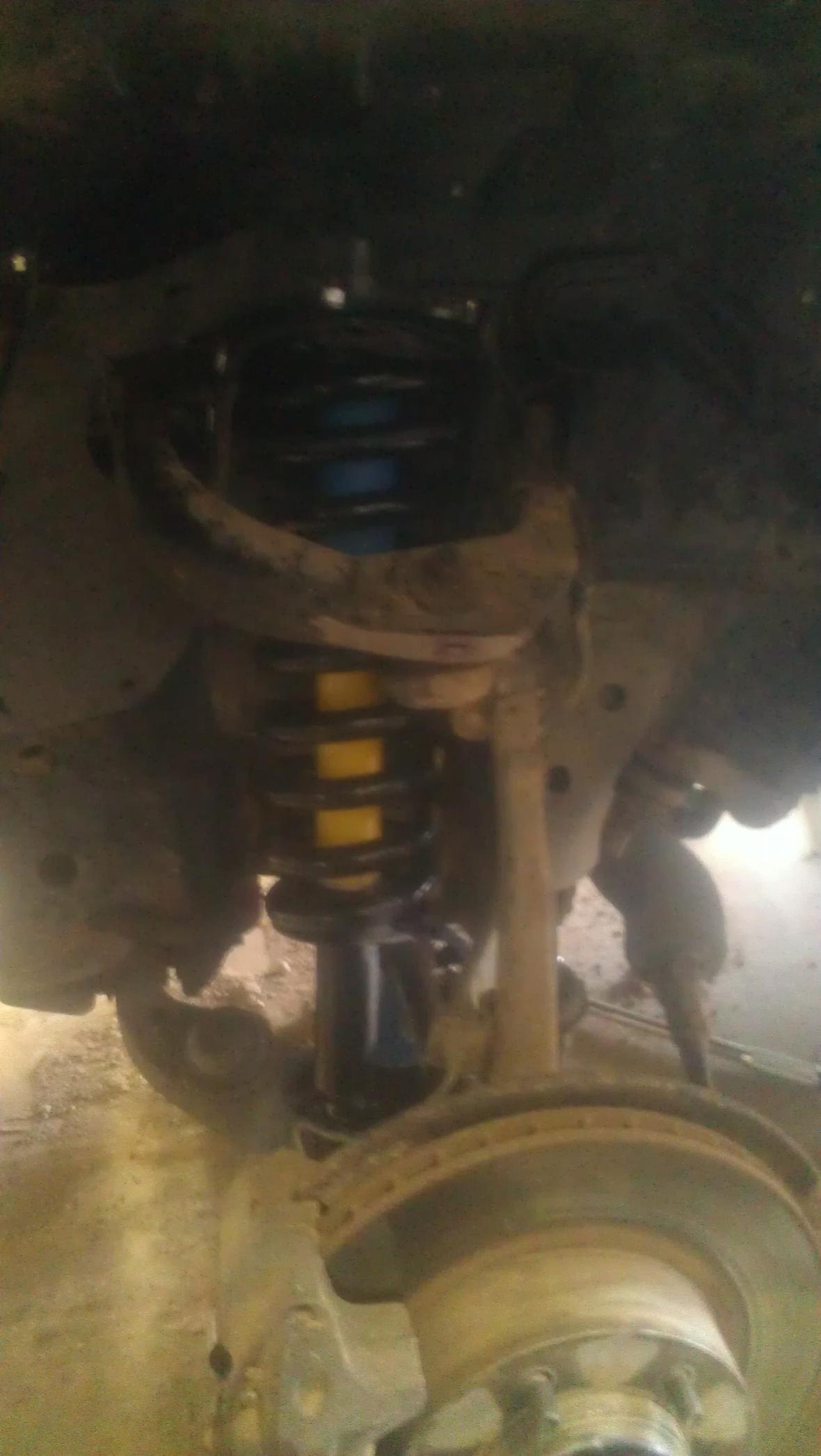

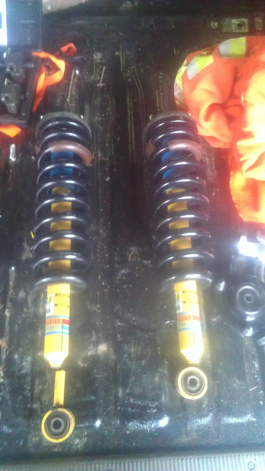

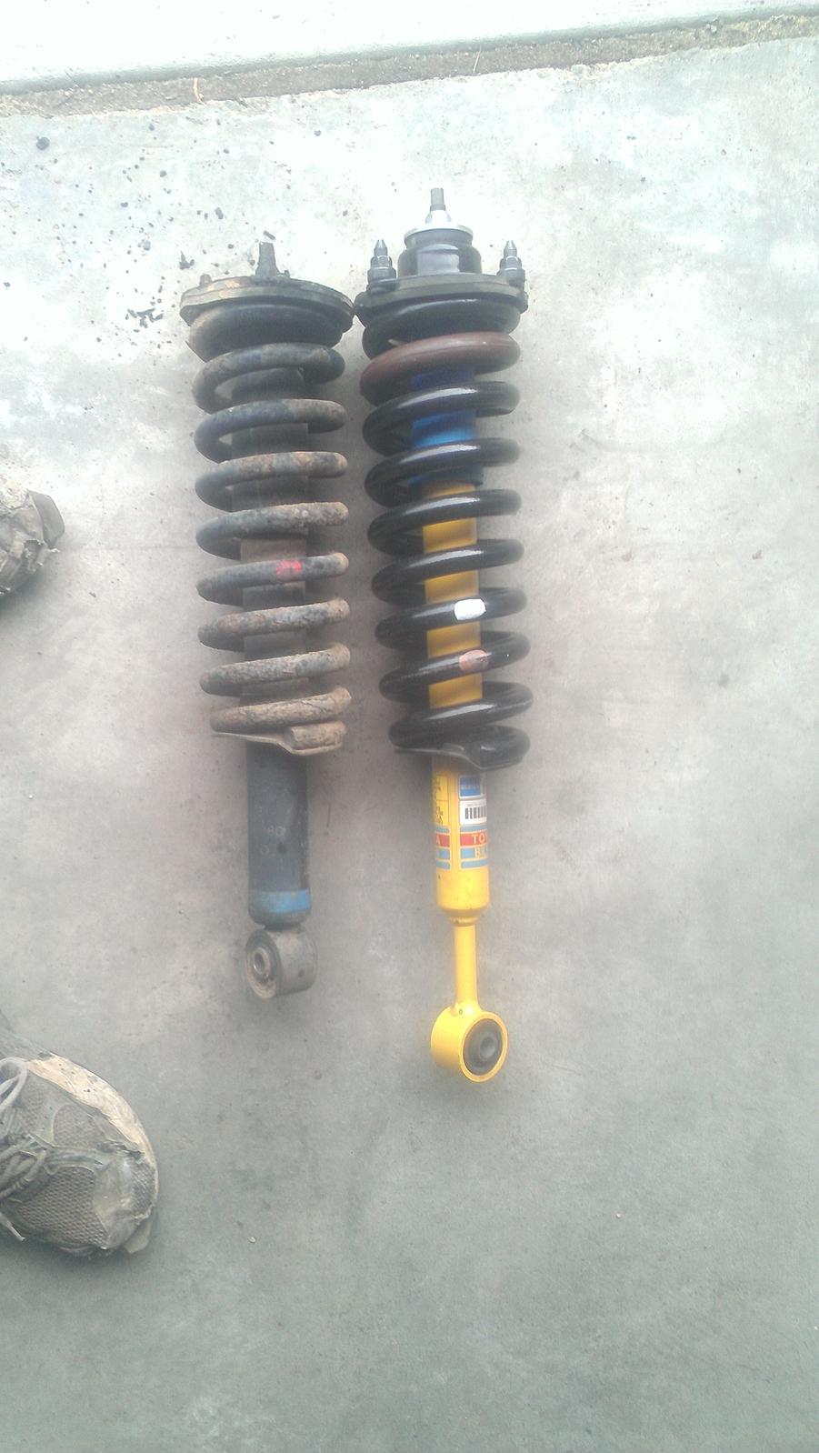

Can you please explain exactly what/how you pulled this off? What parts? Coils? Struts? Tophat? Picture off complete front suspension? Thanks
First off, I am a professional welder. I would not recommend anyone try this as if your weld fails going down the road it would be very bad!
I bought a almost brand new set of stock 2013 Tacoma TRD front coilovers which are Bilsteins. They come with an extended lower which is solid steel round bar, which makes them 2.5" too long to even consider trying to fit..
I then bought tophats for my 97 4runner. I reused the rubber isolator from the TRD coilovers with the new tophats as they are a tad wider. I had to modify the rubber bushing under the tophat to get it to seat down further.
Next I cut out the lower steel rod off of the shock to shorten it 2 1/4" and then welded the strut to the mounting ring thingy.
welding to the shock/strut was absolutlly one of the most difficult things i have ever welded. the shock is full of extremely flamable oil and if it bursts or you get it too hot and you end up with a hole the shock is ruined and not fixable. Yet you still have to end up with a perfect 100% weld or you risk the chance of your weld failing, especially when you wheel like I do.

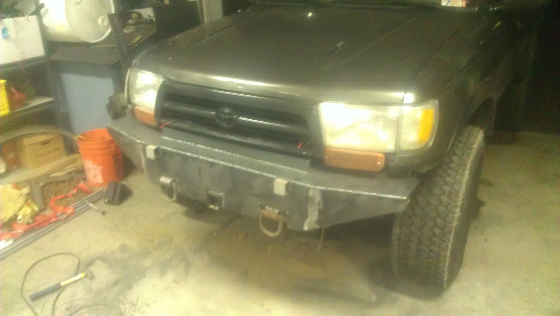

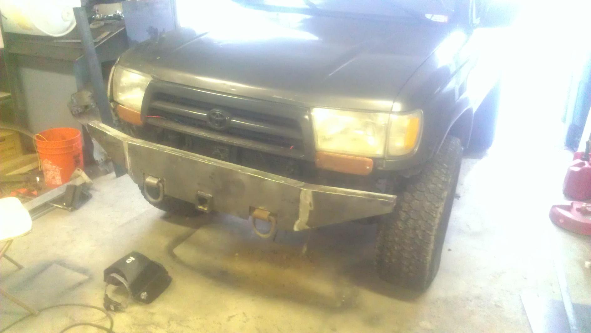

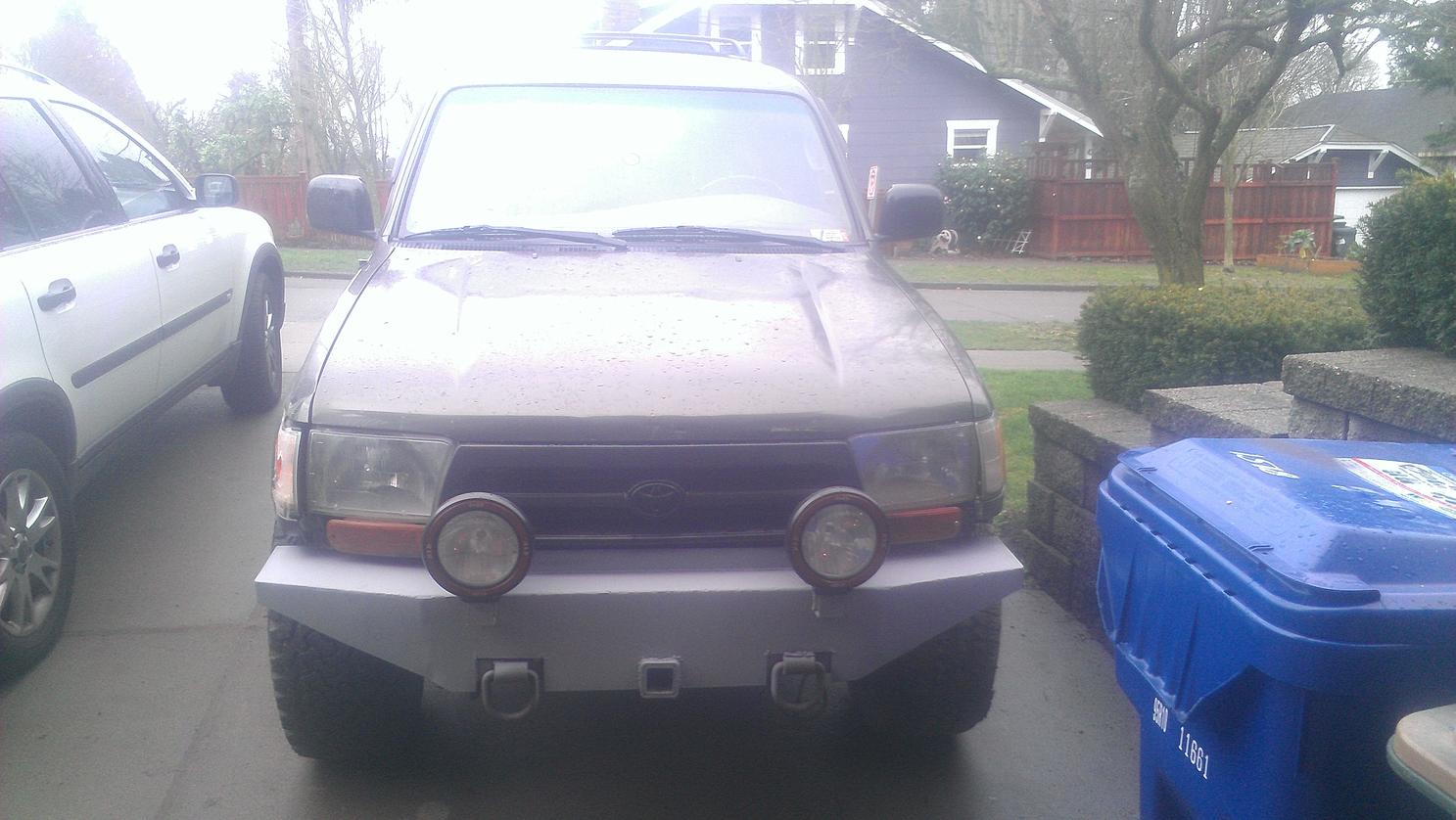

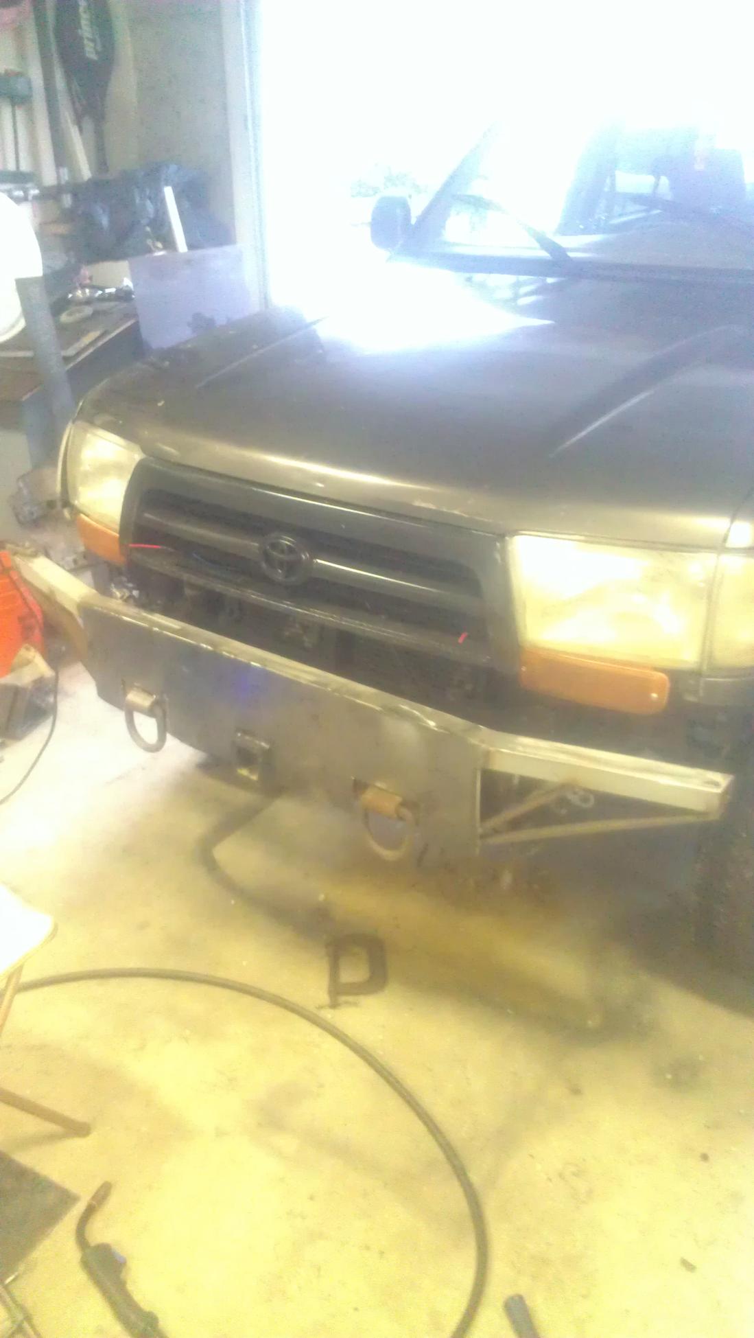

worked on my front bumper all day, got further than the pictures show will add more pics tomorrow. Mounted 2 7" HIDs that are not in pictures .
Looks good bud I'm going to finish my brushguard this weekend I might get this piece of like 3" square tube from my bro that was used for the rear bumper on his blazer to use to make my bumper
Nice, I might start my rear bumper today. i bought mud flaps for it but am not sure if i am going to use them cause they arent the best looking(i bought them online). Im also thinking about doing the dual battery mod and modifying the airbox. I also want to get a unassembled stinger for the front.
