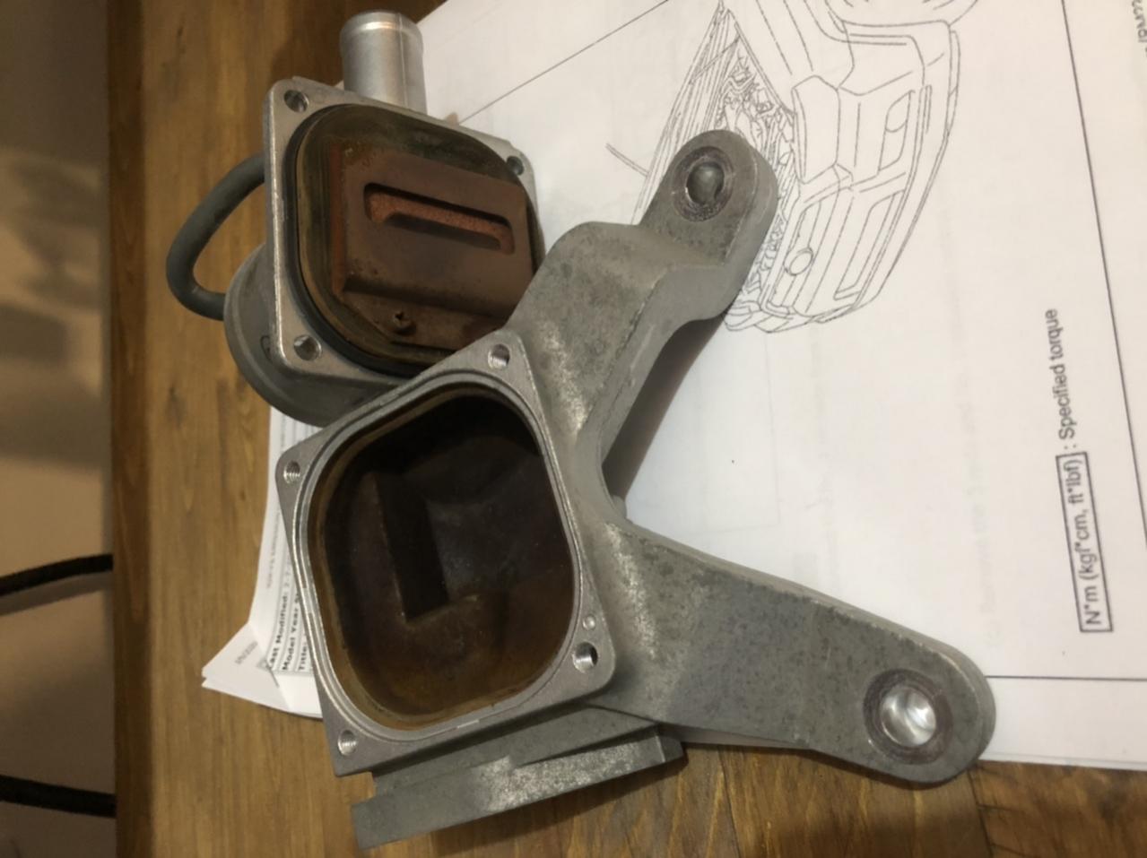

Update on this:
I picked up new valve and two air tube gaskets $180, install was easy 20 min job with half of that time removing and reinstalling air intake tubing and connections. Old valve was rough and rusty looking inside (see pic). Idle for 5-10 min after install and drive for another 10 all runs fine. Code is self cleared after that. All is well now.

Shake the valve and listen for any rattle inside. I had the valve plate break in one.
Once it fails it stays closed. Reseting won't make it go away permanently. If it cleared now - it'll be back.

I did the same, split the case in half to inspect. That’s when I found the valve plate broken at its mounting screws. They do not sell the internal parts separately, just the entire valve.
