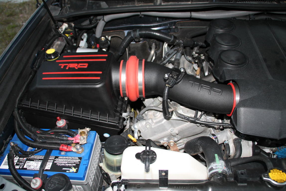

I put a marine deep cycle in my 5th, so I used this Attwood marine tray from Walmart and this hold down from Advanced auto parts, hooking into the stock locations. Less than 20 bucks. I had to bend the front hook a little to clear the larger battery but its been solid. It's a 2012 so no AIP repo, and I attached the power steering res to the tray. No pics of install tho.

That little Attwood tray has a lip of about 3/4", and I fastened the PS res to it. It's pretty rigid as far as holding the weight of the battery from rocking. There is not much room in there so that deep cycle is not going far anyway. Now the factory tray is stout, but using it to support a big battery I don't recommend.
