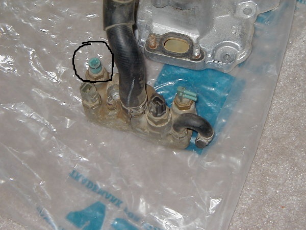

Hello all,
I bought a 93 4Runner with a blown head gasket. I replaced the gaskets and now cannot find a specific sensor wire--I know it sounds ridiculous. Anyway, the sensor is on the coolant bypass block and is round and a blueish color. Does anyone know what this sensor is for and where the wire/connector comes from that goes on it. It would seem like the wire would come out of the harness on the L side with two other sensor wires that connect back there, but I have searched the world over and can't find that wire/connector anywhere. I'm pretty sure I took it off--been a few weeks since I disassembled it--and the sensor looked clean like it had been covered so I'm assuming there was a connector on it. There is a pic of the sensor in question below, circled in black. Any suggestions would be greatly appreciated. Thanks
The plug to that sensor comes out of the wire harness right after the plugs for the fuel injectors and knock sensor on the drivers side. I dont know how to post pics on here but if youd like to pm me your number i can text you a pic i have my motor tore down right now to replace the heads and i know exactly where it is if you need more help.
I was sure it came out of the harness in that area also, but it sure isn't there. I can't even find a broke wire where it might have broke off. I'm very perplexed.
