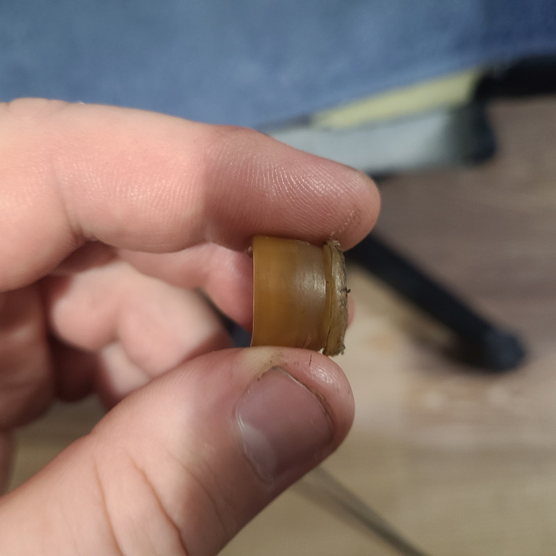

1997 4Runner Bushing not same Shape as Marlin Crawler?
I pulled out a bushing that doesn't match the standard / Marlin Crawler bushings out of a 3rd gen 1997 4Runner with a R150F. I can't seem to find anywhere that sells it or even a part number. I tried the Marlin Crawler one, but it causes the shifter to get stuck in 4th gear. Any help would be appreciated.
