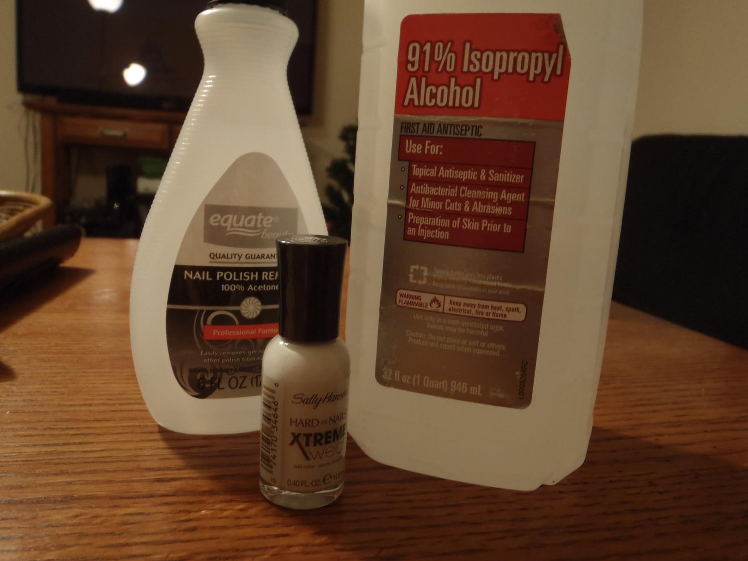

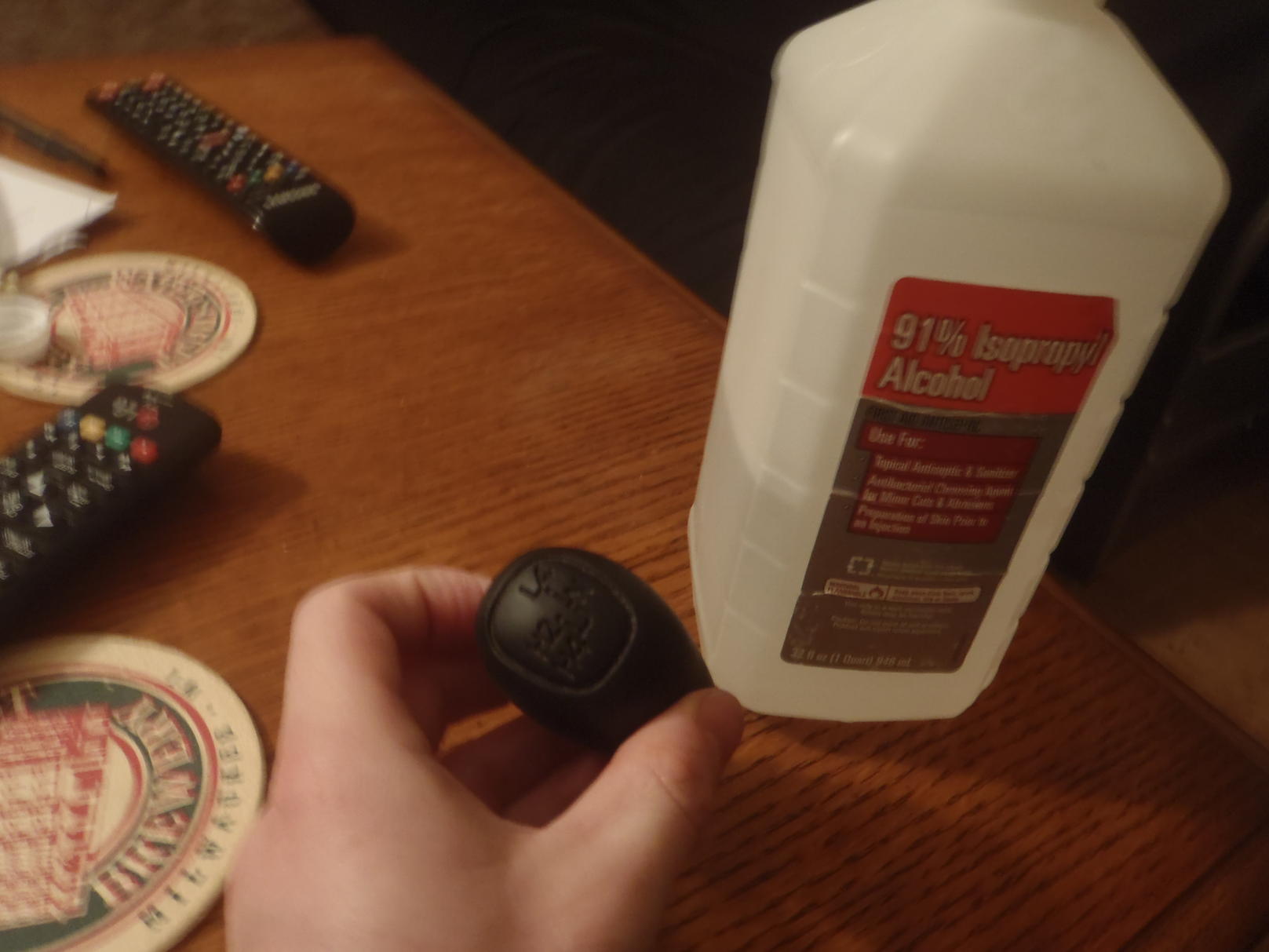

Supplies: You will need everything pictured below; Rubbing alcohol, nail polish of your desired color, and nail polish remover. Other things you will need that are not pictured are; paper towels and q-tips.

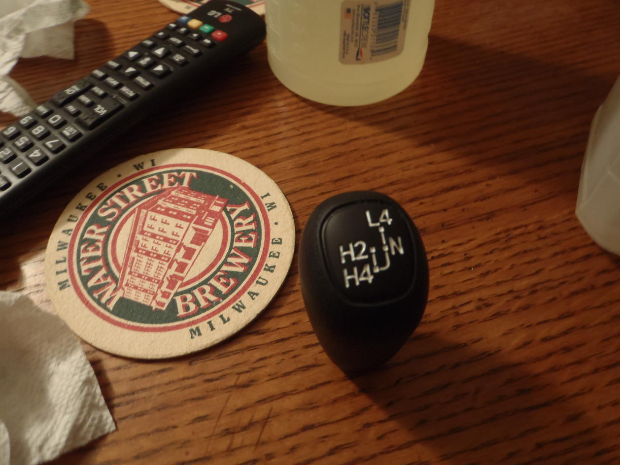

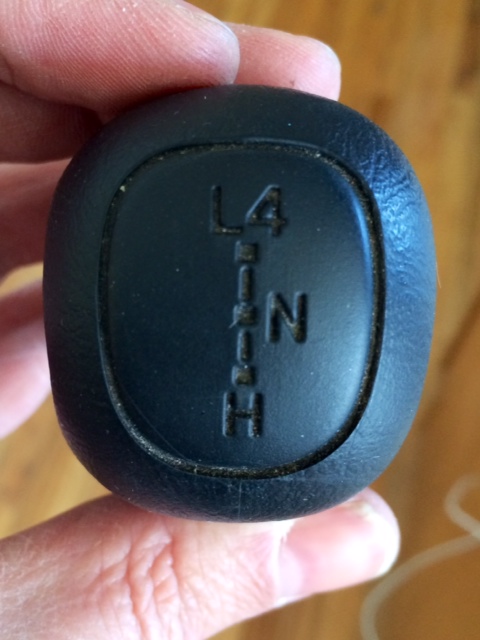

Cleaning: After you remove your shift know, you must clean all the nasty crud and oils off of it. To do this use the paper towels, q tips, and alcohol to clean your knob. Make sure you do a good with this and pay special attention to the recessed areas. Sorry for the blurry picture, but you can really see how nasty these can get.

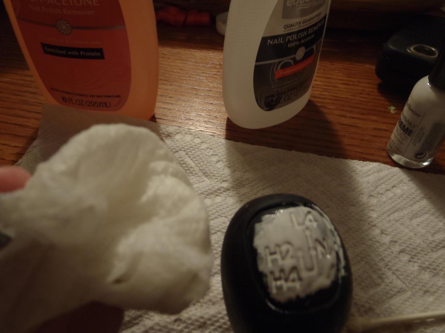

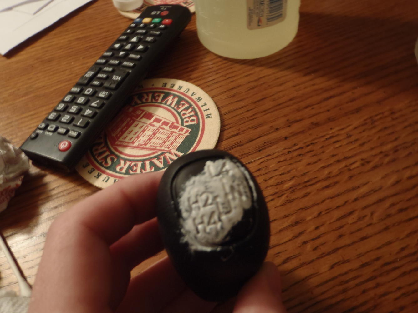

Now we need to get rid of the extra. After you brush on the color, wet a paper towel with the nail polish remover and wipe away the polish on the surface. Don't use too mush pressure, or else you will end up removing the color fill as well. You may have to use a few clean paper towels to eliminate all streaking. You will be left with something like this:
This doesn't look the best, but that's okay. Thin coats are your friend and we just repeat the coloring process until the desired level of fill is achieved.

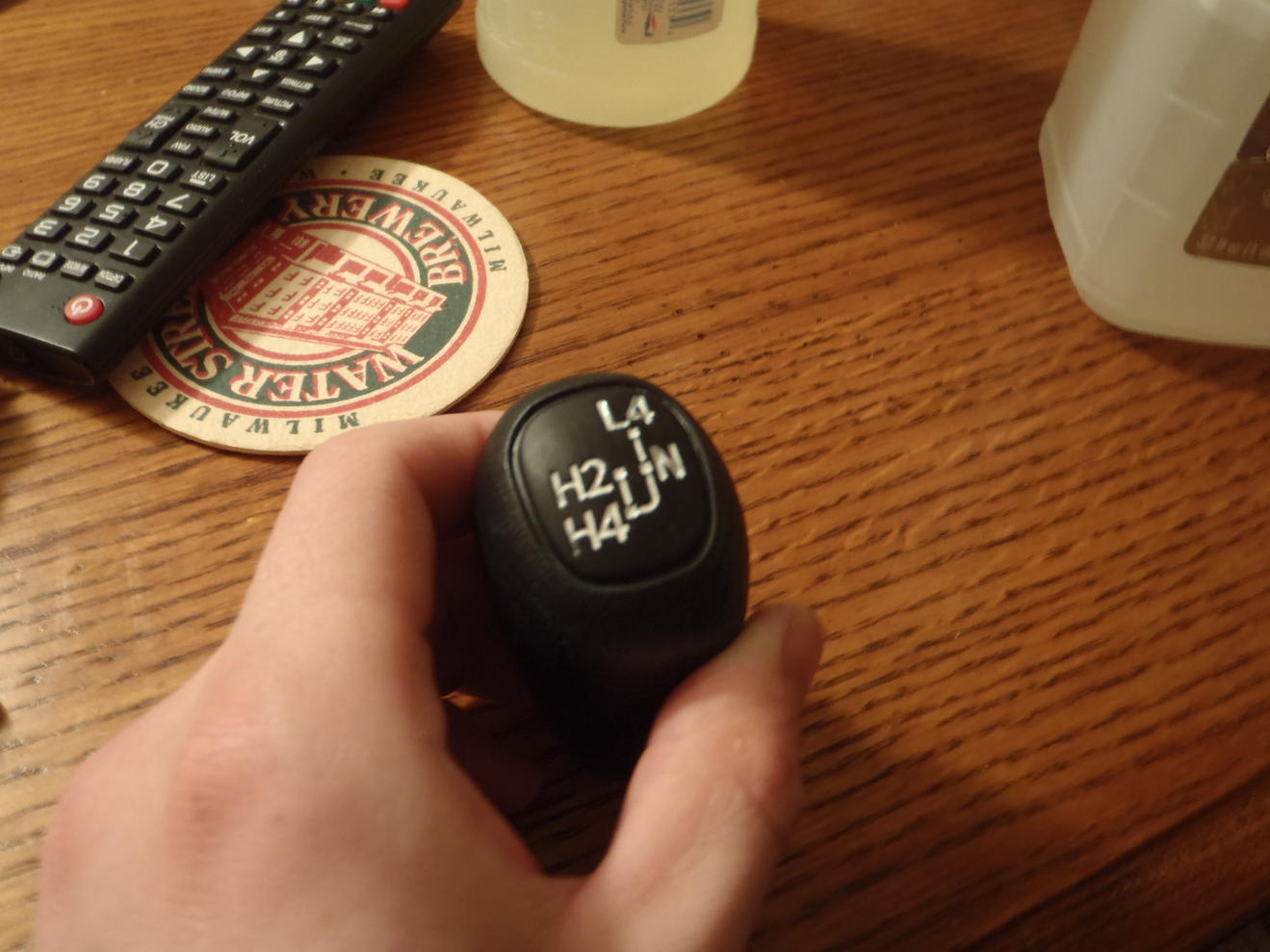

Make sure you wipe off the nail polish really well, and use fresh paper towels, or else you end up with a milky haze on your knob. You may need to apply 2 or 3 coats, but your finished product should look like this:

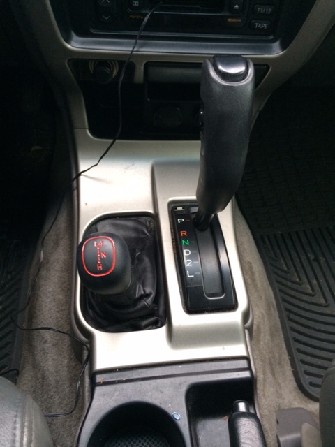

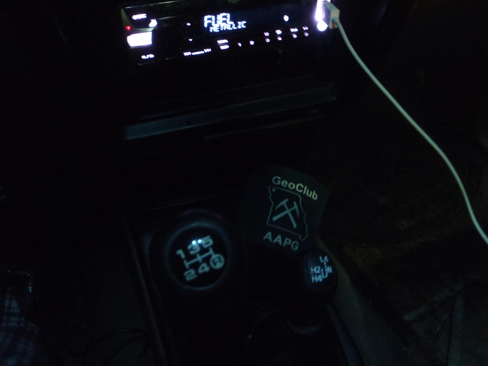

I really like your idea. Last night I was board so I decided to fill mine as well. I think it turned out great. Not something many people will notice, but I really like it. Thanks for the idea!

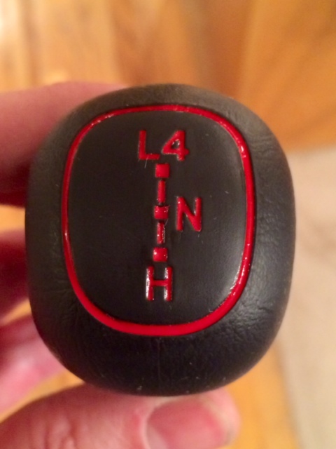

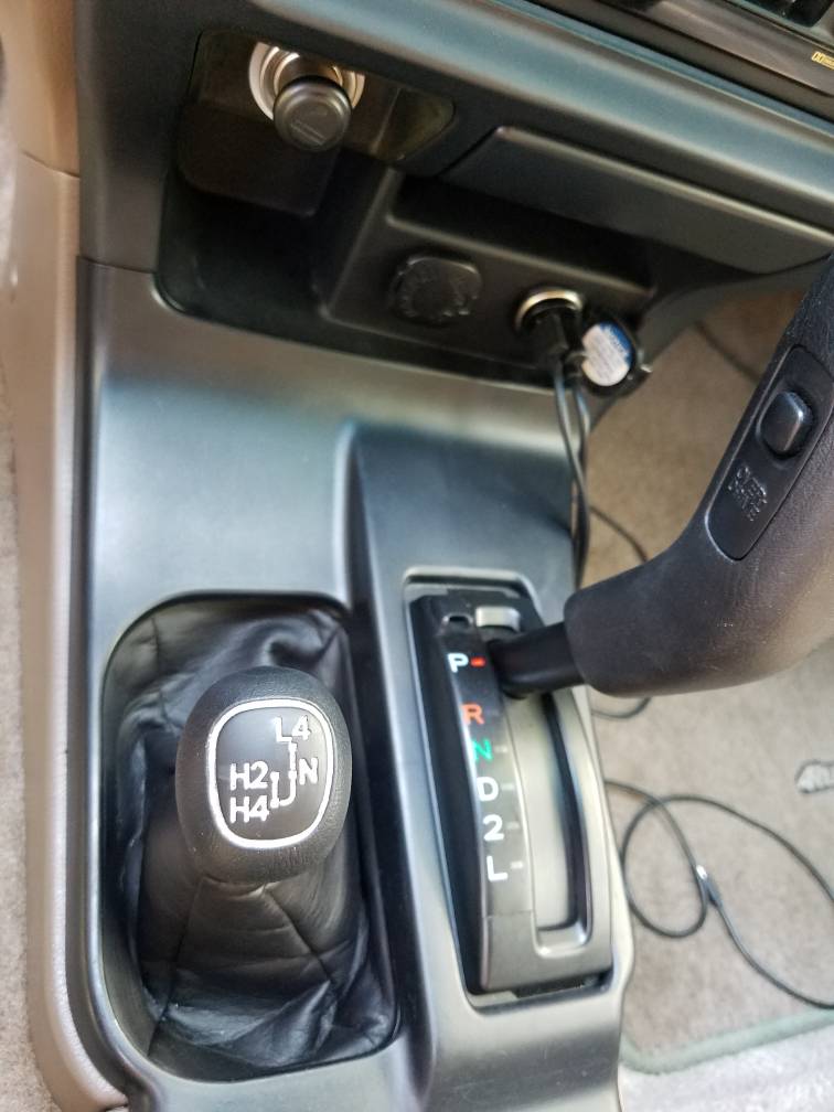

Just came across this and loved it! Here's mine, raided my wife's nail polish and found a really cool silver:
Sent from my SM-G930V using Tapatalk
That looks great. Now you should do it to the little cigarette on your lighter. I keep meaning to do this on my 1st gen because they had paint inlay that wears off. *This is neither a promotion or endorsement of smoking.
