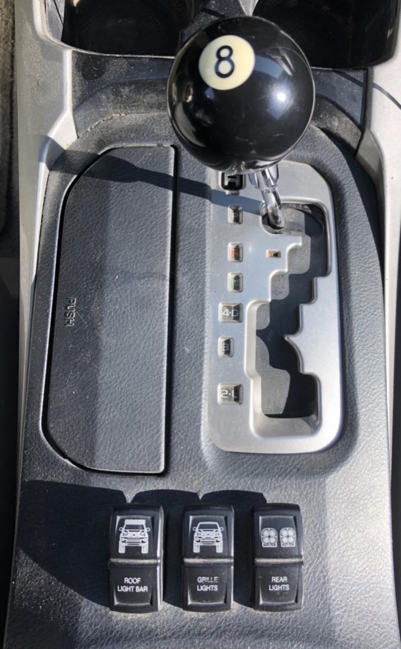

I made my own. I’d had this 8ball kicking around for quite a few years after I sold my table. I was going to drill it out and epoxy a metric insert into it but it has a metal core that I was able to tap out. I had a little chrome piece with a set screw that fit below it to cover the reduction on the lever itself.

Can you shed any light on how you got this to work. Being a bike mechanic/feen love the idea and look.
The grip I used was a mini lock on made for kids BMX bikes I think. Machined an adapter out of delrin to clamp it onto, pretty easy! Though I have been considering putting that design into CAD and 3D printing them.
The Getta Grip adapters look much better though being made of aluminum.
Any pics of yours? One issue I had with the bike grip on mine was I had to raise it higher than I expected due to clearance issues when in 1st/2nd gear. Not that I use those very often but still a little annoying.
I'll try to remember to take a pic tomorrow. But I don't think I have that issue.

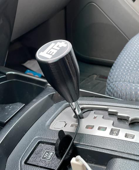

I got this 3D printed one from one of our awesome forum members. Thanks [MENTION=83833]thegame7[/MENTION]
