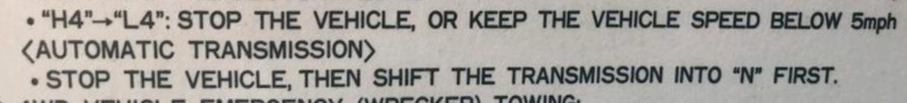

Here's what my card says:
('99 SR5 auto, standard j-shifter)
So, in or out of Low range (notice arrow goes both directions) should be stopped in Neutral with the automatic trans.
Into 4H below 50mph, no mention of limitations on going back to 2H, just suggestions for how to get the ADD to unlock, basically.
-Charlie

I haven't seen one place that says it is ok to shift ranges (H-L or L-H) while moving with the auto trans (j-shifter, electric part time or multi-mode). Can you post something that says this is ok?
Even on the manual trans, it says to stop the vehicle, then mentions that you can do it at less than 5mph.
-Charlie
Look at the visor pic posted twice now. Both imply that doing it at 5mph is ok unless you encounter issues.
Essentially what I'm saying is most of us with an auto will encounter issues.
I mis-spoke in my previous post. After looking at the FSM again, it's clear the manual transmission version of the tcase has a 4L to 4H synchronizer, upshifts can be made on the fly. The automatic transmission version does not have that synchro, so stopping or shifting below 5mph is necessary. This corresponds with the placard posted above.
I think you need to look at it again. The section that says up to 5mph is for the manual transmission. Auto transmission says stop the vehicle.
-Charlie
I wonder what my Son does! He has a two transfer case thing setup in his 87 rock Crawler! I bet something grinds sometime in the crazy shift variables.
-Charlie
LOL, I couldn't imaging shifting into 4low going faster than 5mph. It's like downshifting into 1st gear where you bash your forehead on the steering wheel! LOL
Yes it does say that auto ... Stop.
-Charlie
The instructions could certainly have been written better.
:bat:
:bat:
Seriously? What level is your reading comprehension?!?!?
The line above what you wrote says "Depress the clutch pedal" and the line above that is "Manual Transmission" ... as in, doesn't apply to automatic.
Then the line below, that actually applies to the "Automatic Transmission" states, "Stop the vehicle, then shift the transmission into "N" first"
-Charlie
edit: or were you agreeing with me? In which case, I'm sorry!
I don't disagree with you man. But yes the first time I saw that pic it wasn't clear. Could be the picture or just my brain. Thanks for posting clarification btw.
"This shit reads like stereo instructions" says the 2WD guy
