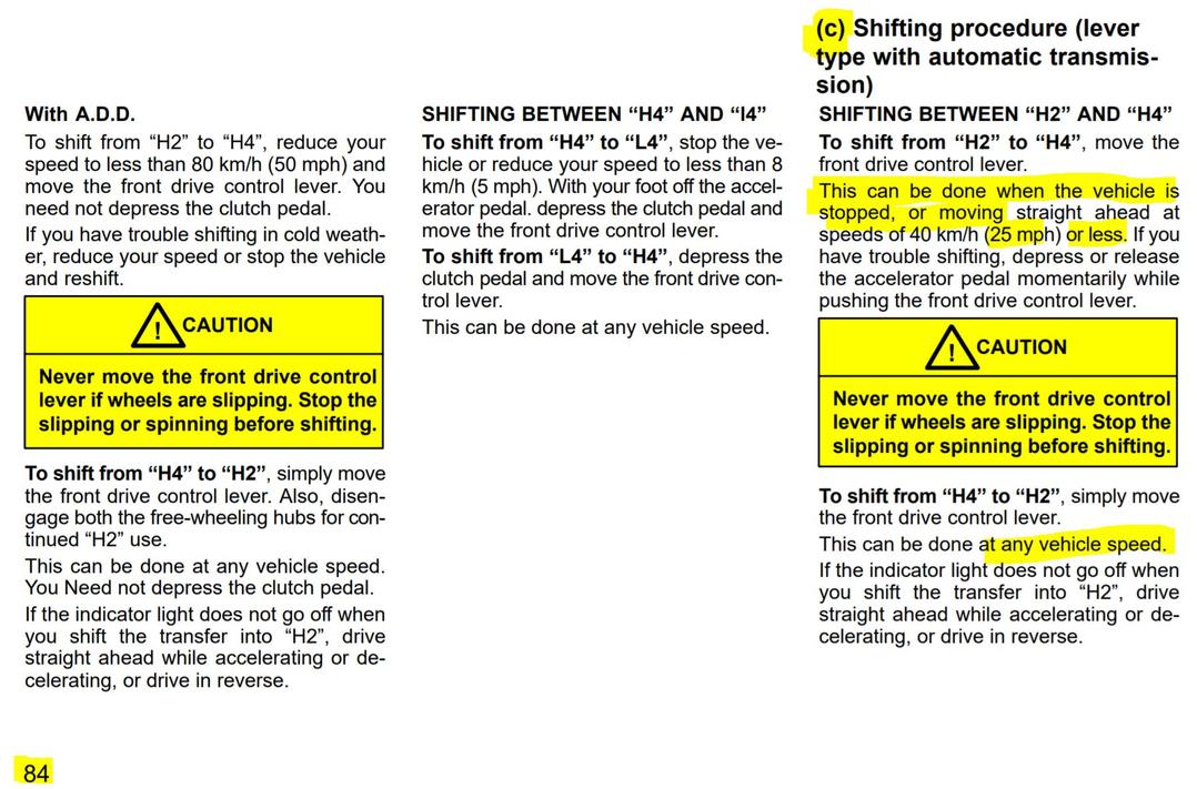

So friends on the 1997 Automatic Transmission 4WD 4Runner this is what I was talking about. The 1997 owners manual itself flat out says you can shift it while driving.
https://www.toyota.com/t3Portal/document/om/OM35694U/pdf/omsource/1997om/974runne/sect1/16.pdf
We can argue about what the visor says of some years 3rd Gen in circles all day but FOR SURE on the 1997 (and likely others but I'm to lazy to check all) it clearly tells owners they can shift LO/HI/LO while moving.
If you have an older 4Runner, note that despite what the owners manual says about shifting 4LO <---> 4HI without stopping, you will probably damage your transfer case if your truck has a lot of miles on it and you ignore the grinding warnings.
Maybe they changed the manual for later years because I don't get why the visor posted earlier basically says the opposite.

... it clearly tells owners they can shift LO/HI/LO while moving.

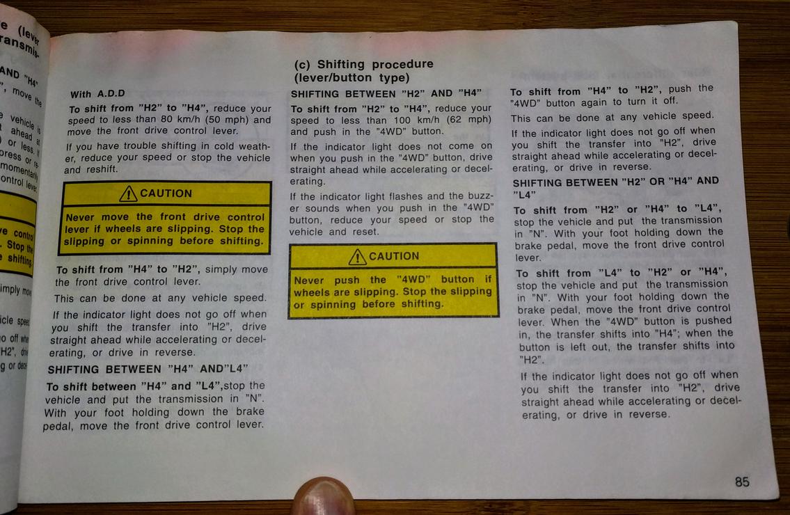

Not exactly.. If you look at the next page of the manual, it says that for automatics, shifting from H4 to L4 requires a complete stop and trans in N:
We need to be clear on whether we are talking about H2 to H4 shifts or H4 to L4 shifts. It is correct that H2 to H4 can be done while moving.

They ARE very confusing :). Nonetheless, I also have '97 Limited with push button, and I still think that for automatics, you have to look at page 85 that I posted, which says H4 to L4 shift requires full stop. Now, H2 to H4 shift can be done while moving, which is what page 84 that you posted says (for automatics). Confused yet? :)

No, I'm with you. Like with the last screen shot of the manual posted by [MENTION=198376]4Runner4Leon[/MENTION], in the leftmost column there it says at the top:
With A.D.D. To Shift from "H2" to "H4"
...and then follows it up with:
To Shift from "H4" to "H2"
The real confusing part there is that these are instructions for shifting to and from H2-H4, yet mentions
Also, disengage both free-wheeling hubs for continued "H2" use.
......Wait wut!?? Is this some sort of magical ADD & Free-Wheeling Hub Hybrid Unicorn 4Runner I didn't know about?
Sent from my SM-G900P using Tapatalk
Oh wait, I see what you are getting at Brian, the right side of page 85. That does talk about H4 to L4 shifts while either stopped or below 5 mph; but it says to also to depress the clutch pedal, which is sort of hard to do in an automatic. Oy.

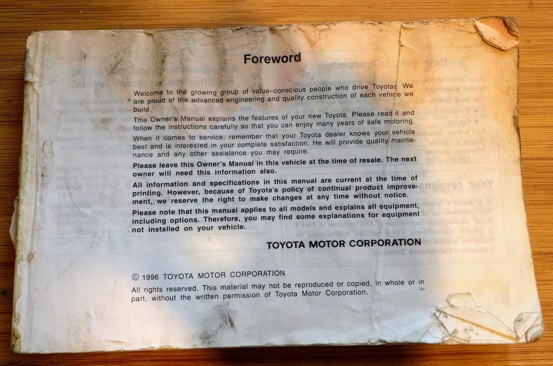

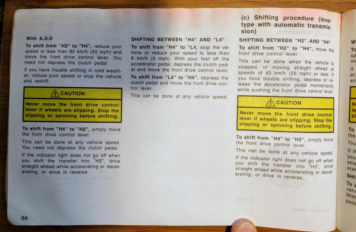

Here is my 1997 paper manual.
Ha, as I suspected, this is different from the online version, which is obviously bootlegged and messed up.
The printed version clearly says that for H4 to L4 shifts, the vehicle needs to be stopped and transmission in N.

What you call bootlegged LoL is from Toyota.com
Then there is the question of why the visor on some years says different also. I am starting to believe Toyota has been pretty inconsistent with instructions on this issue.
I agree, the lack of consistency is bothersome. I'd still go with a hard copy that came with the vehicle instead of any online document, even if it is from Toyota. Especially because in this particular example, the printed version seems consistent while the online one makes no sense.

Wow. It's in much more distress than mine is. Mine is still pretty crisp and in its original vinyl pouch from the Dealership. I think I've referenced it more often than any of the previous owners (If I recall, I think I'm the 3rd owner).
