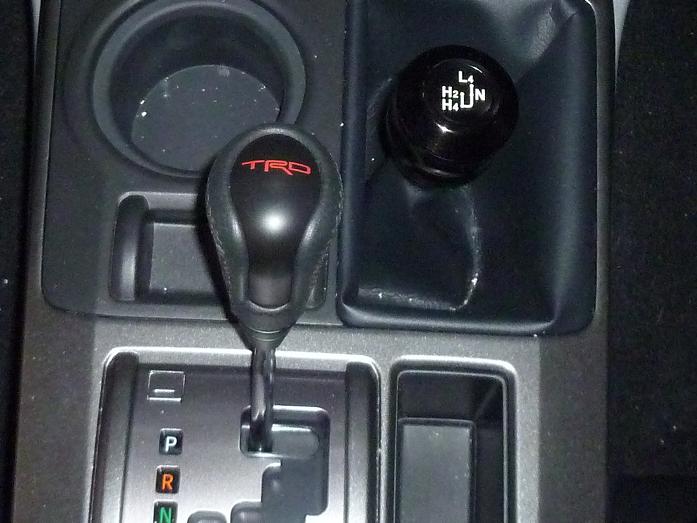

Awaiting delivery of a new 4R, but at the moment I have a F-150 and had to learn the hard way about where, and how to access the shift-lock override switch. Can't get it out of park without pushing it and the forum members pointed to a solenoid issue. I haven't fixed it as it serves as a cheap security system.
I second j_shoe99's request if anyone has pictures and how to access the override switch.
I borrowed this picture from this post by [MENTION=13878]GrantK[/MENTION]. The shift override is underneath the square you see above the [P] and to the left of the shift knob. That square is the cover for the shift override. Pop it off with something thin and flat and press the override.

Wow, that is very simple compared to my F150. I must pop the entire shifter/console cover off enough to use my finger to reach about 1-2 inches down (on the side between P and R) to reach the button. My wife's previous Subaru was similar but the cover was much smaller.
