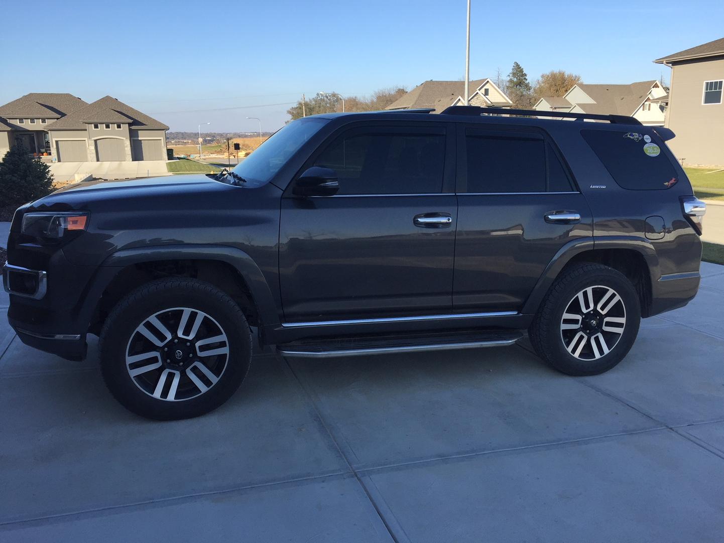

Timely question. Yesterday I had my XREAS removed, and replaced with 5100s all around. Used the original coils, and adjusted the front to have the truck leveled. Ride improved; but then, my right front shock was leaking (100K miles), and I didn't want to go through the expense of repairing XREAS. It's only been 24 hrs, but so far, absolutely no regrets. Truck handles well. If anything, the ride is a little smoother on gravel washboard roads. I did have TORC Motorsports in Omaha do the work. Didn't feel like doing it myself, but I don't think it's too hard. I'll try to post a picture later. PM me if you want any further details.

Not the best picture, but it may give you an idea.
