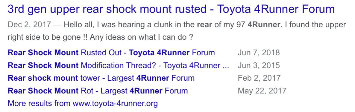

A simple google search yielded the following hits all on this forum.
