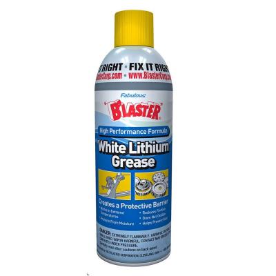

so about 8 months ago (last summer) i cleaned up my coil overs with fresh paint and greased all the bolts to keep them from seizing up.

So question. How should i keep them from going back to rusting?
