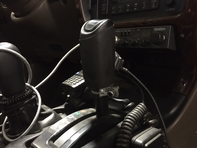

I have the URD short throw on mine and love it. Had to put it on for my dual case install but I wish I would have done it sooner.
After the install I did bend the shifter so that the handle moved back a bit toward me (and away from the dash).
