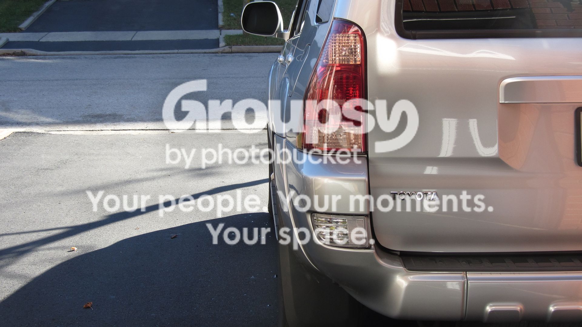

I bought this on EBAY from a seller in Japan, they replace the reflectors in the rear bumper and have turn signal style bulbs in them. The best thing is they look totally stock. They were pricey but were the only clear option available at the time.
IMG_1990.jpg~original
97d72377-c5ff-484a-9b05-a9855a5829fb_zpsnfzp4vdu.jpg~original
Daytime pics don't do it justice, they are pretty bright! I can grab some night time shots if anyone cares.
UPDATE: night time shot added below
8ab82240-6ee0-40ad-838d-844986d85c7f_zps3zadywrv.jpg~original
They are wired to the reverse lights in the tail light housing. I put in some very expensive LED bulbs from VLEDS.com. Before installation I applied hot glue around the inner seams to prevent any chance of leakage into the lenses. They've held up great for 6 years.
I believe similar year Land Cruisers and Hilux models in Japan have these from factory but they're red lenses.

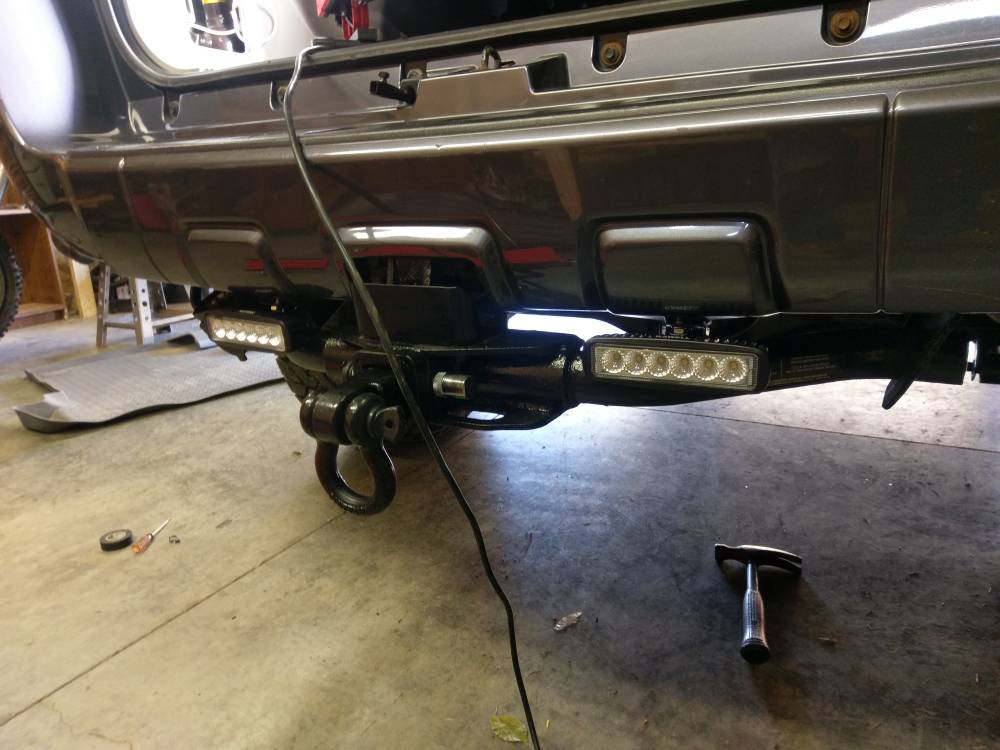

Cheap Kawell brand work lights from Amazon mounted on the two plastic bumper tabs wired into a switch, right next to the anytime backup camera switch. Great for backing up and backing people off. A coworker has used these lights as fogs on his daily driver for over a year with no issues, I would recommend them.

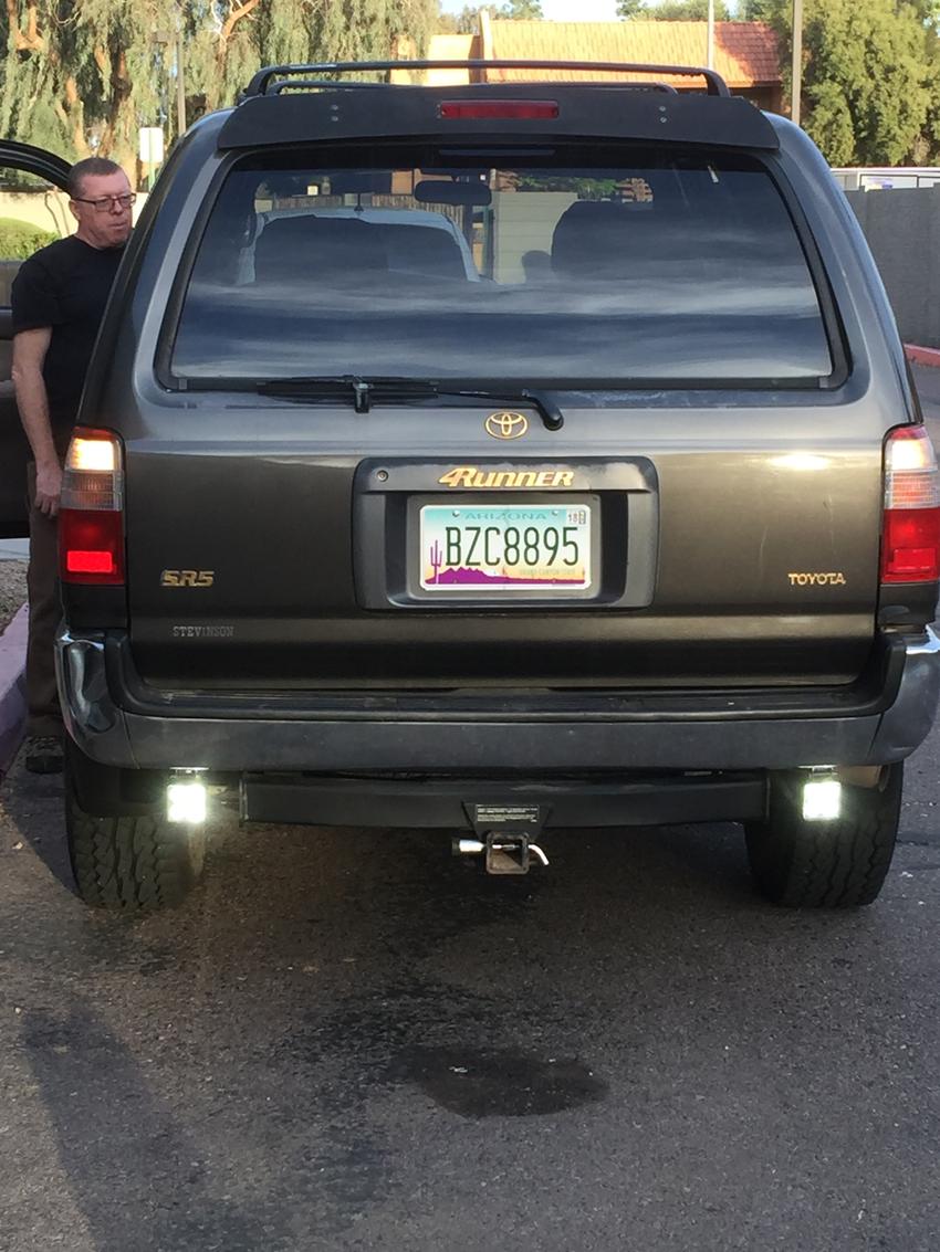

I went to Northern Tool and bought a pair of LED flood lights. Then just wired them into the stock back up lights.

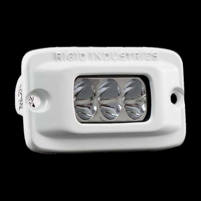

I was thinking about trying to flush mount these right into the back bumper.
sorry for the giant picture.

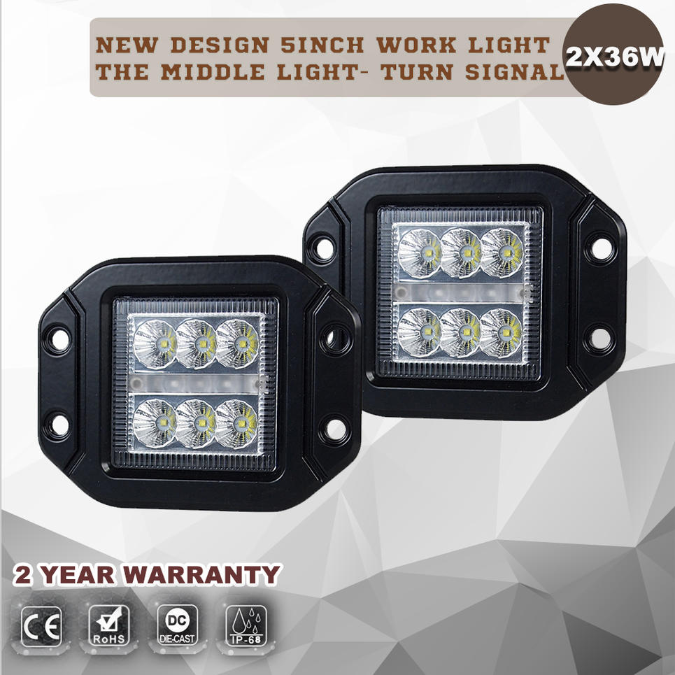

I just bought these, and I'm waiting for a decent weekend to install them.
I plan on cutting holes on the high part of the ends of the bumper...
just above the reflectors. (It's all plastic, no metal)

Can you provide a link for everyone ? I bought these 6 years ago so I'm sure there's more options now.
The one I bought actually has 2 bulbs in each lense . I'm just using the main bulb for the reverse . I left the other bulb in there but not wired up . It can be used as additional tail/stop light or side marker or even Turn signals , just have to get the appropriate colored bulbs for the application .
