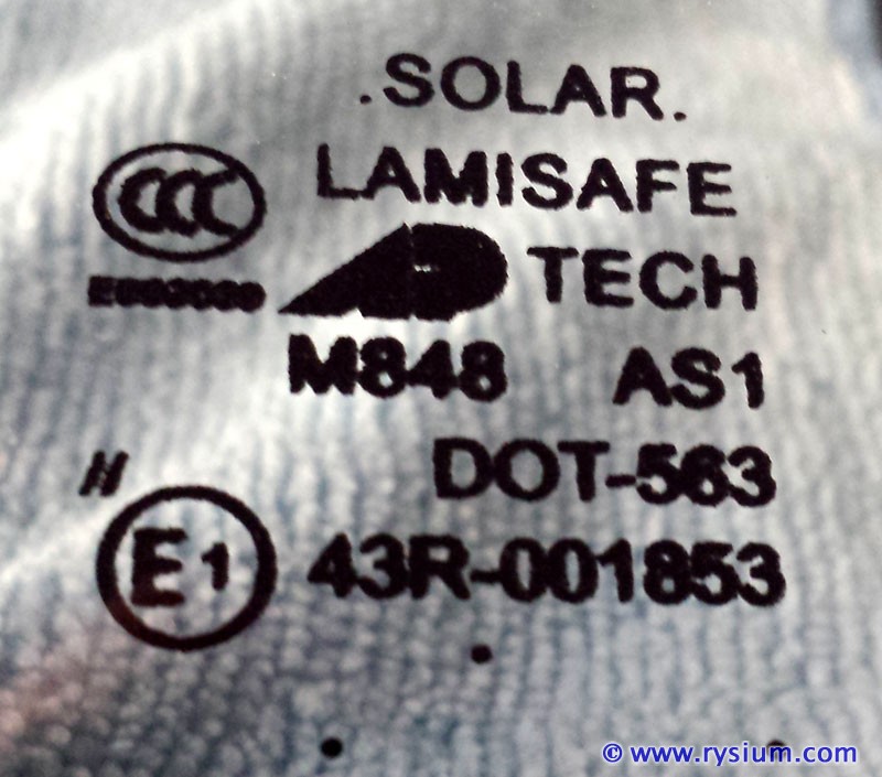

Here is my curent windshield with E1 marking on it.

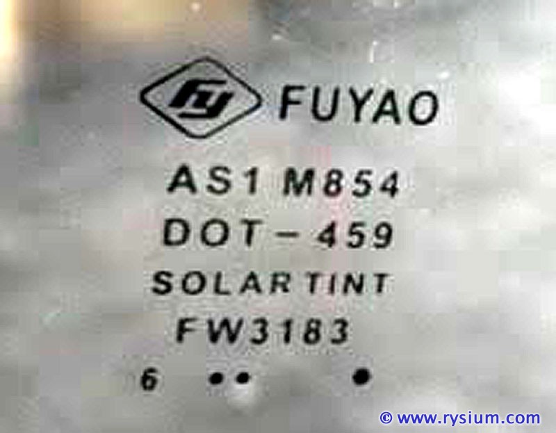

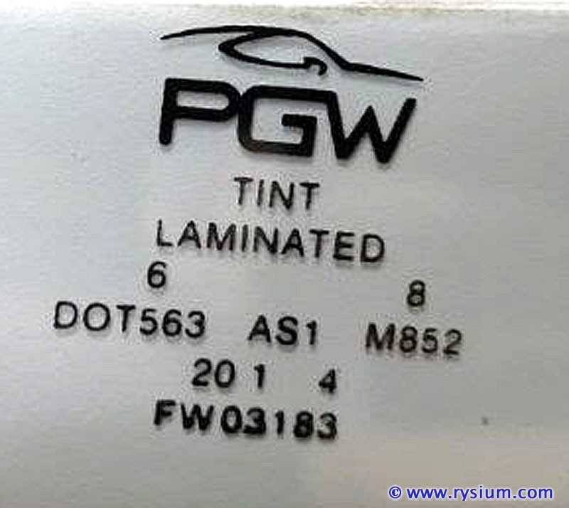

These are two aftermarket windshields available for my local auto glass installer (no E marking, only DOT number)

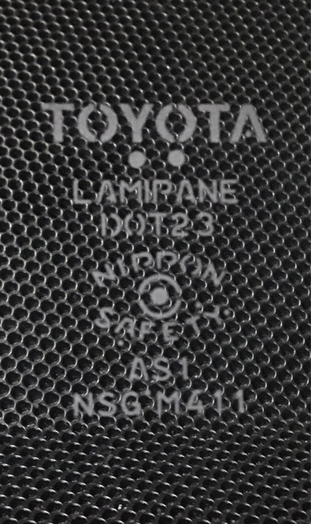

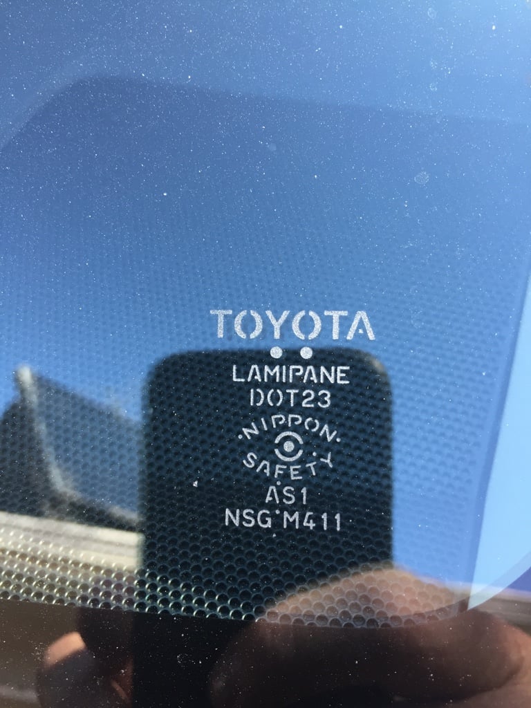

I went through local Toyota dealer lot and some windshields have E-marking some don't. They did not have any 4Runners there, so I couldn't check it.
Manufacturers in USA probably don't care about E-marking, as long as they have DOT, they are OK here. International manufacturers in majority have both markings DOT and E, some have also CCC (China). For example the original glass on my 2015 Nissan Versa Note has E1.

I did research a little bit about the logo on my windshield and it appears to be AP Technoglass. Now I see the owner retired AP and now have business in USA under the name "AGC Automotive Americas" with aftermarket segment "AGC Automotive Replacement Glass". Maybe I should look for AGC instead OEM.

Correct me if I'm wrong, but the 4Runner is not marketed in Europe, just the Prado. Do these two models have the same windshield? If not, you will most likely not be able to locate a 4Runner windshield with the "E" rating here or over there.
I'm afraid you may be right. Glass shop here does not have it. I was curious about the windshield I have now - it is E-marked. From the logo I see it is AP Technoglass, which was doing glass for AGC Automotive Americas. Now this glass is made by Safelite Glass Corp. AGC is big international company making OEM and aftermarket glass for many car companies. The bug on my windshield proves that at some point there was E-marked windshield for 2012 4Runner available. I could not find it now, when I need it.
The glass shop told me that OEM windshield will cost me about 240 dollars if my insurance does not approve it. I think it will be OK. If there is no E-marking under Toyota logo at least when push comes to the shove I will have an arguing point that this is the windshield that came with the car.
