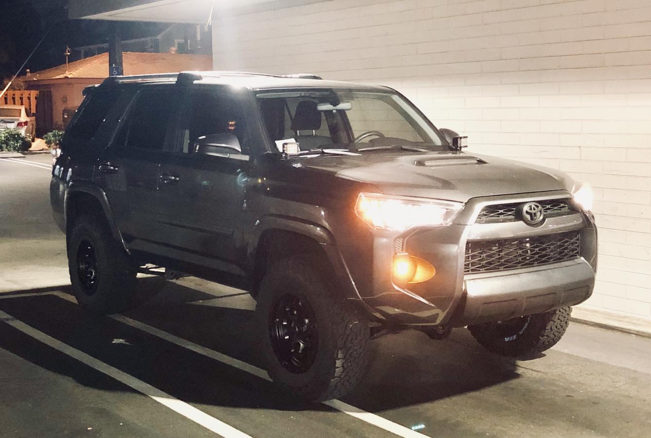

'17 ORP KDSS
Toytec Boss 3" lift
SPC UCA
SCS Ray 10
BFG AT KO2 285/70/17
Spidertrax Spacers

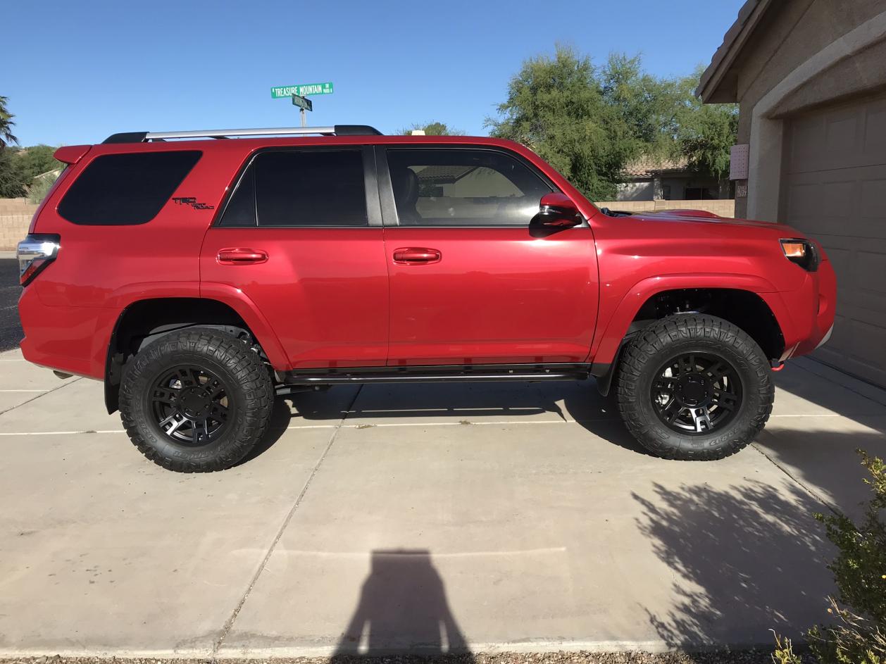

2.5” Bilsteins 5100 with Wheelers T1-T13 springs, JBA UCA and 1/4” spacer up front driver side for lean. Adding 285 Wildpeaks tomorrow, removed front mud flaps and fender liner mod (zero rubbing on 275 KO2s).

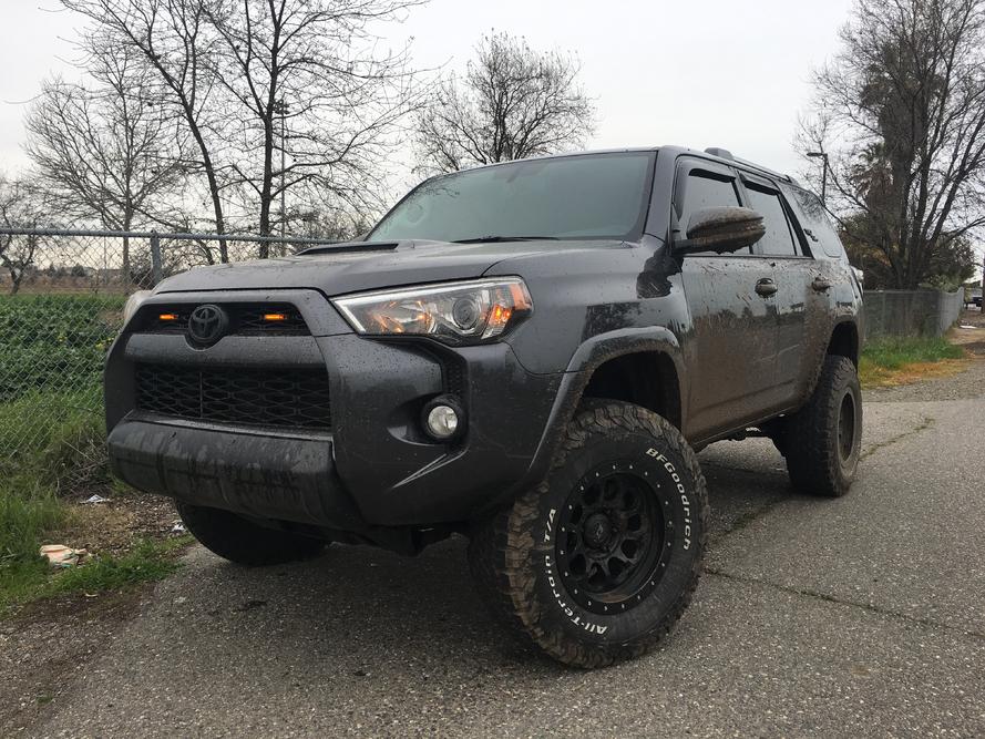

'18 TRD ORP
Kings w/adjusters, 650 springs in front, Dobinson C59-723 springs out back,
Total Chaos UCAs, Cooper ST Maxx LT255/80/17 tires. Truck is lifted 2.5" in front and 1.5" in the rear.

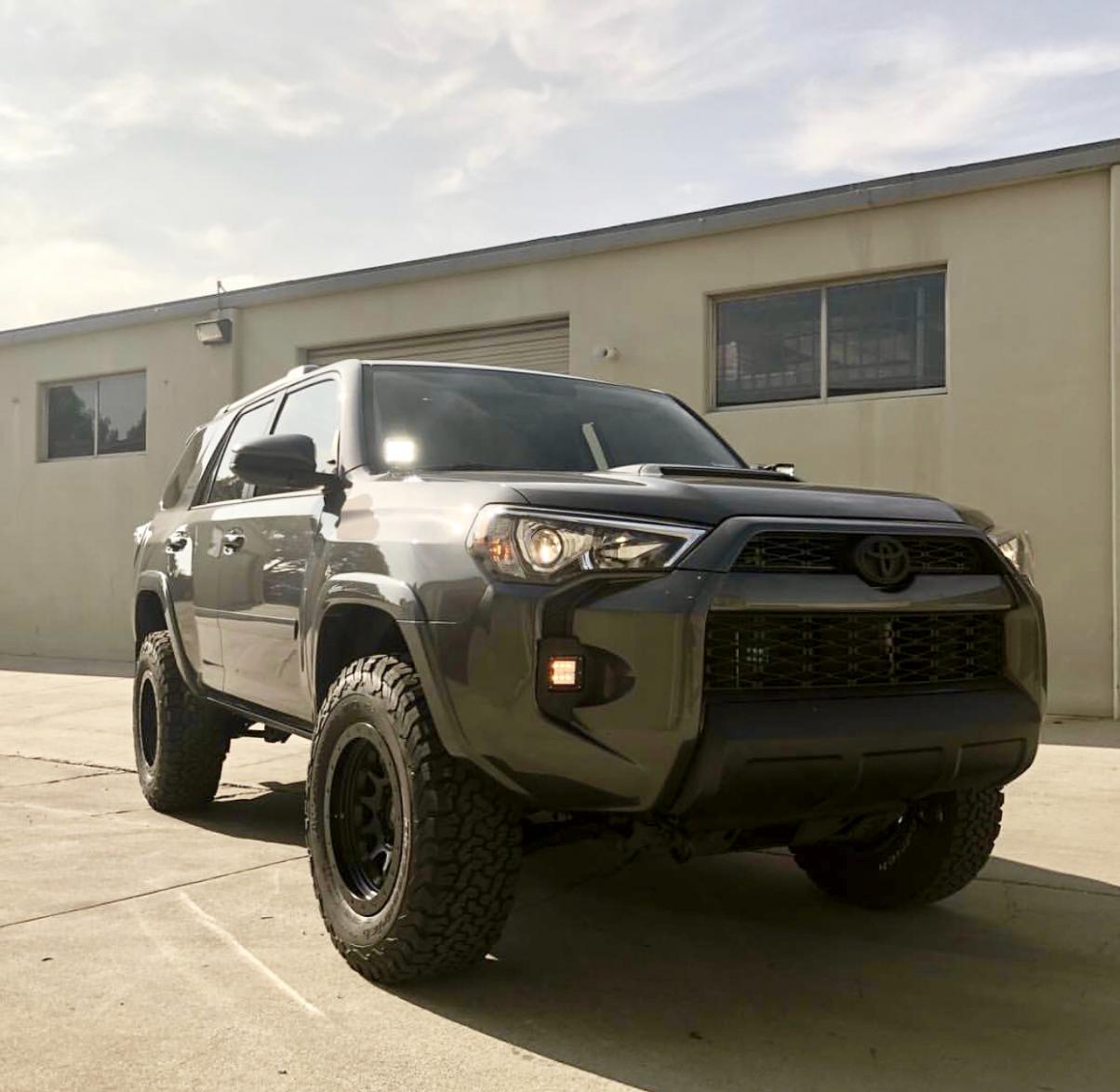

King extended travel w/ adjusters, 2" Icon rear springs, 650lb coilover springs, a little over an inch of preload threads showing with slightly more on the passenger side, Icon delta joint UCA's, 285 tires.
Front rides a bit high especially when the truck is loaded up, but I have a lo-pro bumper waiting to go on and then I'll readjust as needed.
You definitely have some negative rake going on, but it’s not that bad looking. I think once you add some weight like you said, you will be good to go!

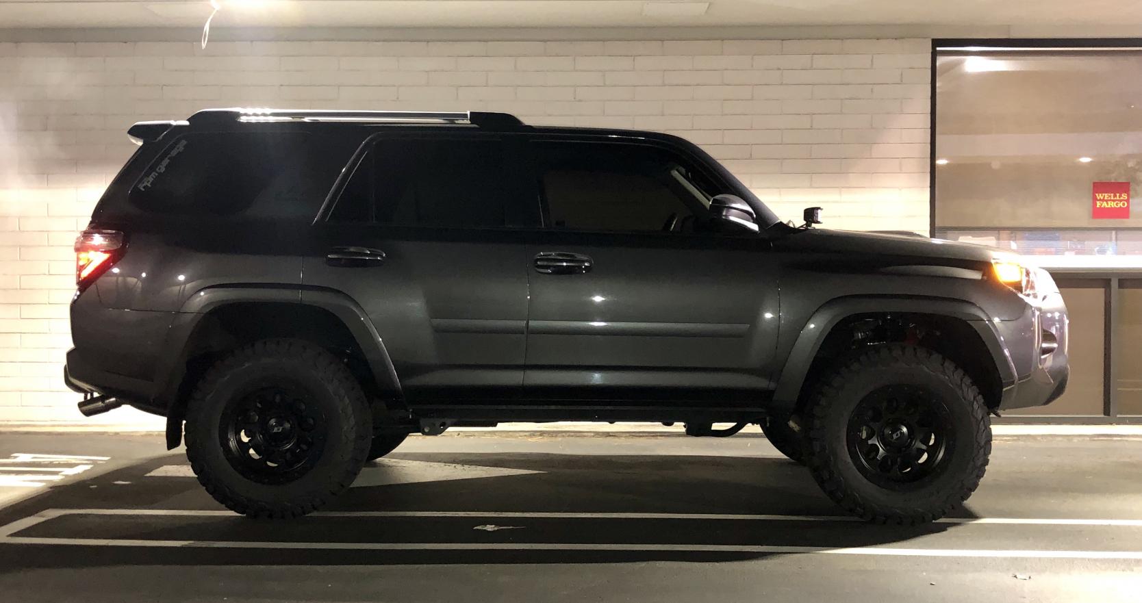

2018 W/KDSS ADS coil overs and rear shocks , Total Chaos UCA, 285/70/17 Nitto Ridge Grapplers.

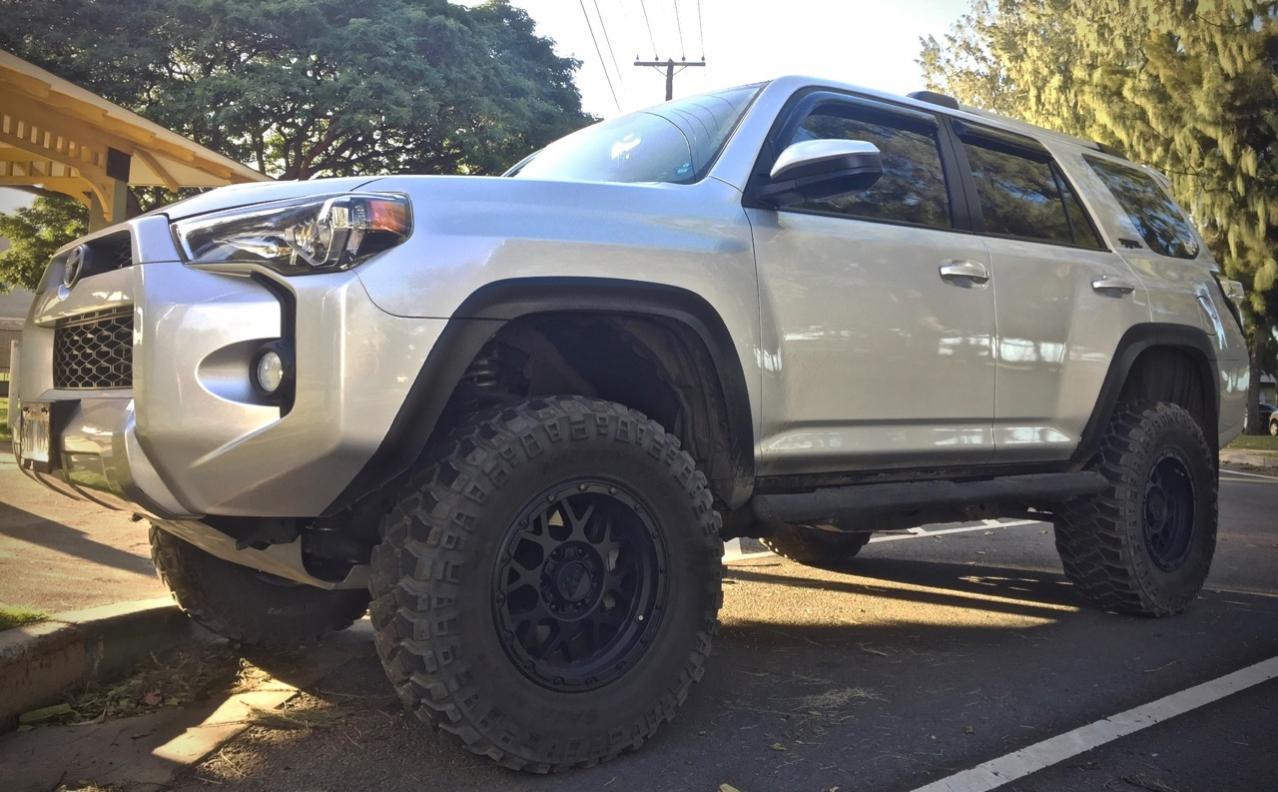

Eibach Pro Kit with OME895E rear coils and 1" body lift with 295/70R17 MTZP3 on 17x8.5 XD Grenade Wheels. Also custom fit the TRD skid for the KDSS to work
