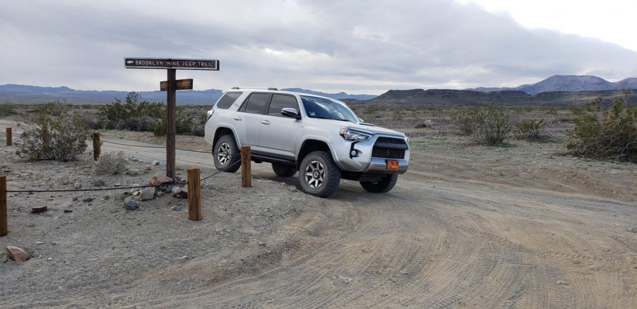

'18 ORP with KDSS
Eibach Pro-Truck shocks all around (Fronts @ 0")
Eibach Pro-Truck 2.75" front springs
Eibach / Wheeler's T13 1.5" rear springs
Stock UCAs, 265/70 Falken Wildpeak AT3W
...and no lean! :guitar3:

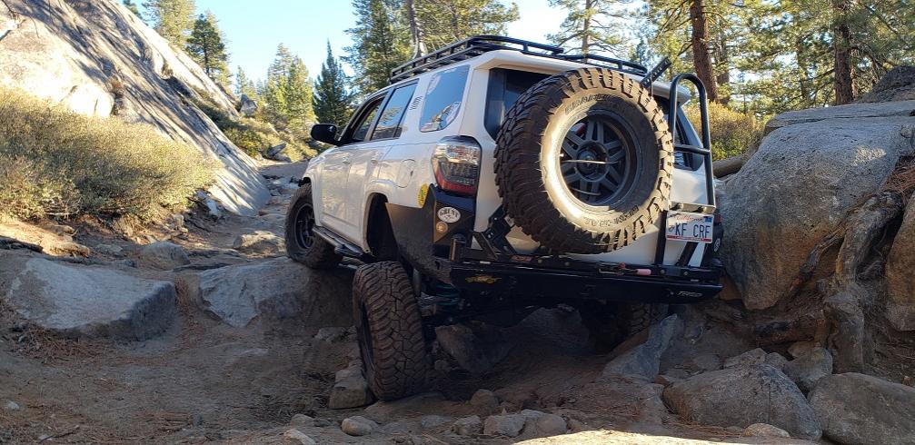

Ditch the KDSS is you want maximum wheel travel and body roll. KDSS is not compatible with any form of LT no matter what anyone tells you.

I respect your build, experience, and hours spent doing your own research so what do you have to say about Sonoran Steels setup? He doesn't call it lt because... it's not. But what are your thoughts?
I really regret buying a KDSS truck because I know I wan't LT. I let the dealer tell me they only sell KDSS. I'm not about to trade anytimes soon and as a it is my daily the KDSS is rather nice to have. I would love a setup that fully exploits system. It would be a perfect truck if the KDSS had manual sway disconnects.
I think the Sonoran Steel Pan Hard Bar may help some for a little additional travel. With the stock pan hard and LT set-up with the KDSS, the piston and panhard make contact and stop any additional down travel. By adding the Sonoran Steel pan hard, it appears to alleviate this condition, as that is where one of the offsets are located. The other issue with LT and KDSS is the KDSS system and components will only allow for so much down travel, part of which is burned up by lifting the vehicle. The piston only has so much travel, so when it is maxed, that is it. On the other side of the sway bar is a fixed link where the sway bar pivots and rotates at. As this point stays the same, again, it limits the amount of down travel as well as up travel.
I ran this one trail for the first time with the KDSS still connected and the truck was very unstable in this one uphill, off camber spot as the travel was maxed out, so I was getting wheel lift. The next time I ran this trail, I walked right up the same spot and felt way more stable and got through without issue due to the added wheel travel.
Don't get me wrong, the KDSS is awesome on the street, it really made the 4Runner handle a lot better even after the lift. It just is not compatible with the LT rear suspension set-up.

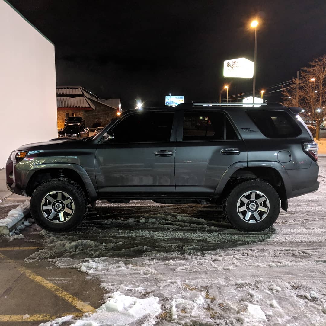

Good to see 285 70 17 BFG KO2s fit on factory OR wheels. Did you get the spacers to clear the suspension components, or just to achieve a wider track? Looking to do a similar lift (pro bilsteins + 1" dobinsons front, 2" dobinsons rear).
Actually, in that picture there, those are only 265's. This picture here is with the 285's. I actually had to take the spacers off to fit the 285's without rubbing. Even with the spacers off, no parts of the suspension are being touched.

Perfect, good to know! I like the way that the 265s look, but the 285s look better. At a 2" lift over stock, I think that 275s might be the best bet for our setup. Thanks for the info, you cleared up a bunch of stuff for us. While I'm all about trimming the various body bits, my other half isn't about it lol

'18 ORP with KDSS

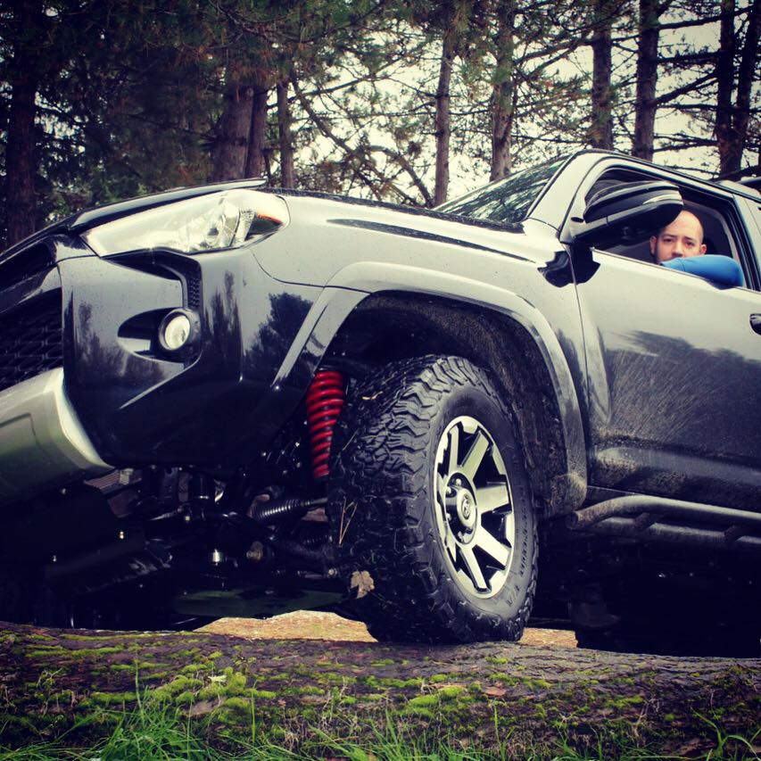

'18 TRD ORP (kdss)
Bilstein TRD FJ PRO with Toytec T4R FJPRO kit - 2.5" lift
JBA Offroad UCA
Toytec Superflexx RCC 2.0 springs
Falken Wildpeaks 255/80R17
