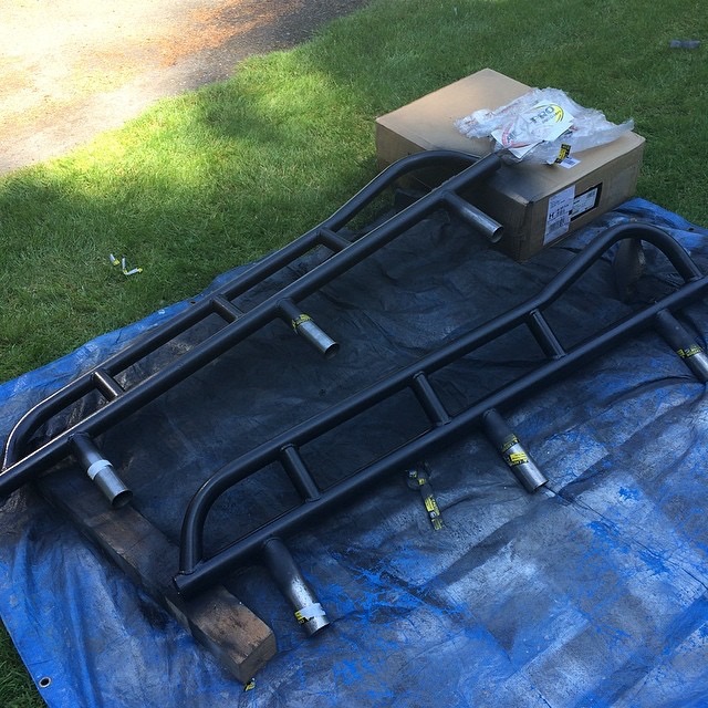

Pic of my sliders.
Sliders will be one of my next projects. Just gotta get a little time so i can actually build them. Anybody got some design tips or anything they would like to see done with sliders. I have a plethora of tools so PM me your ideas and i will see what i can make of them.

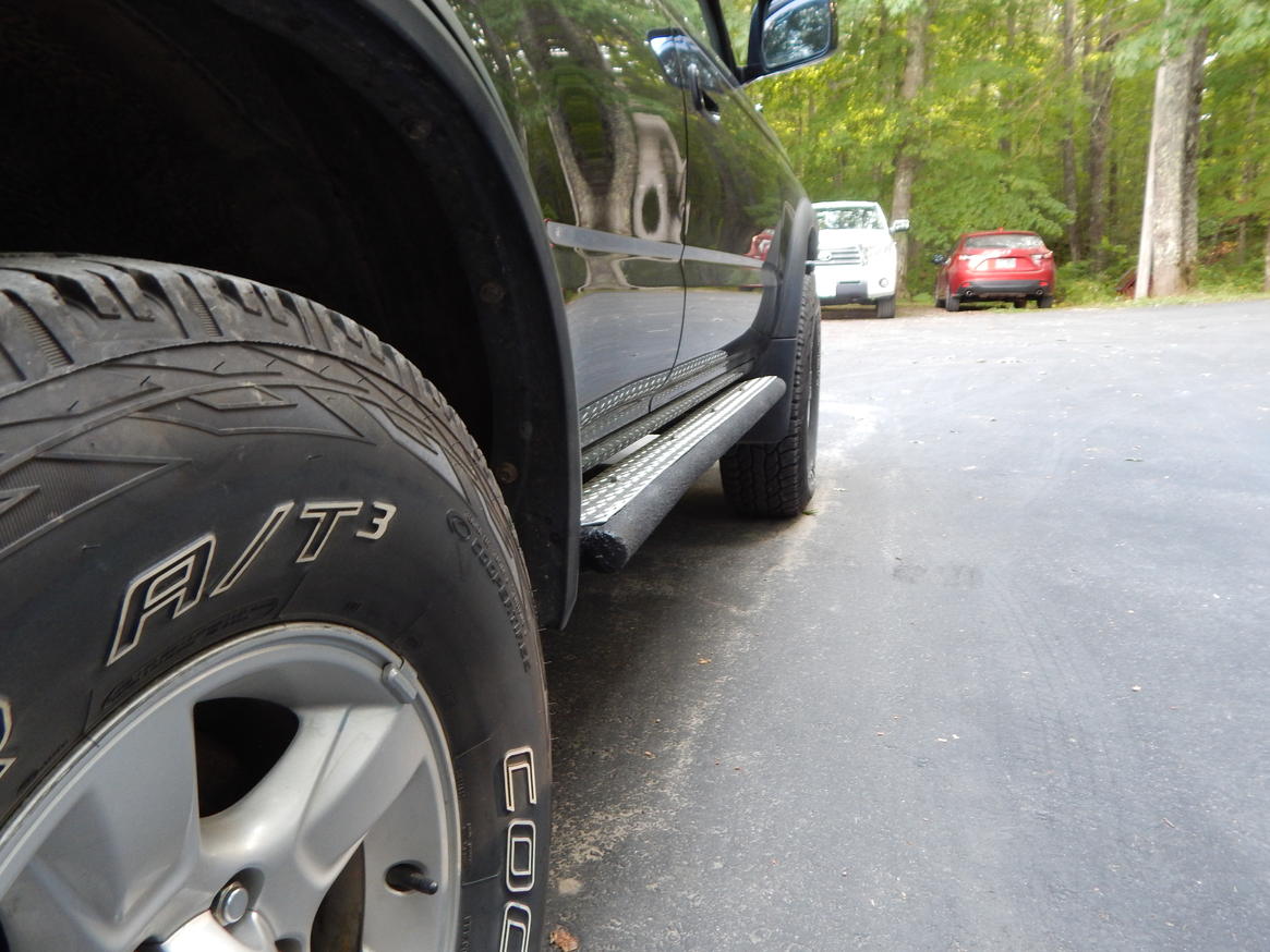

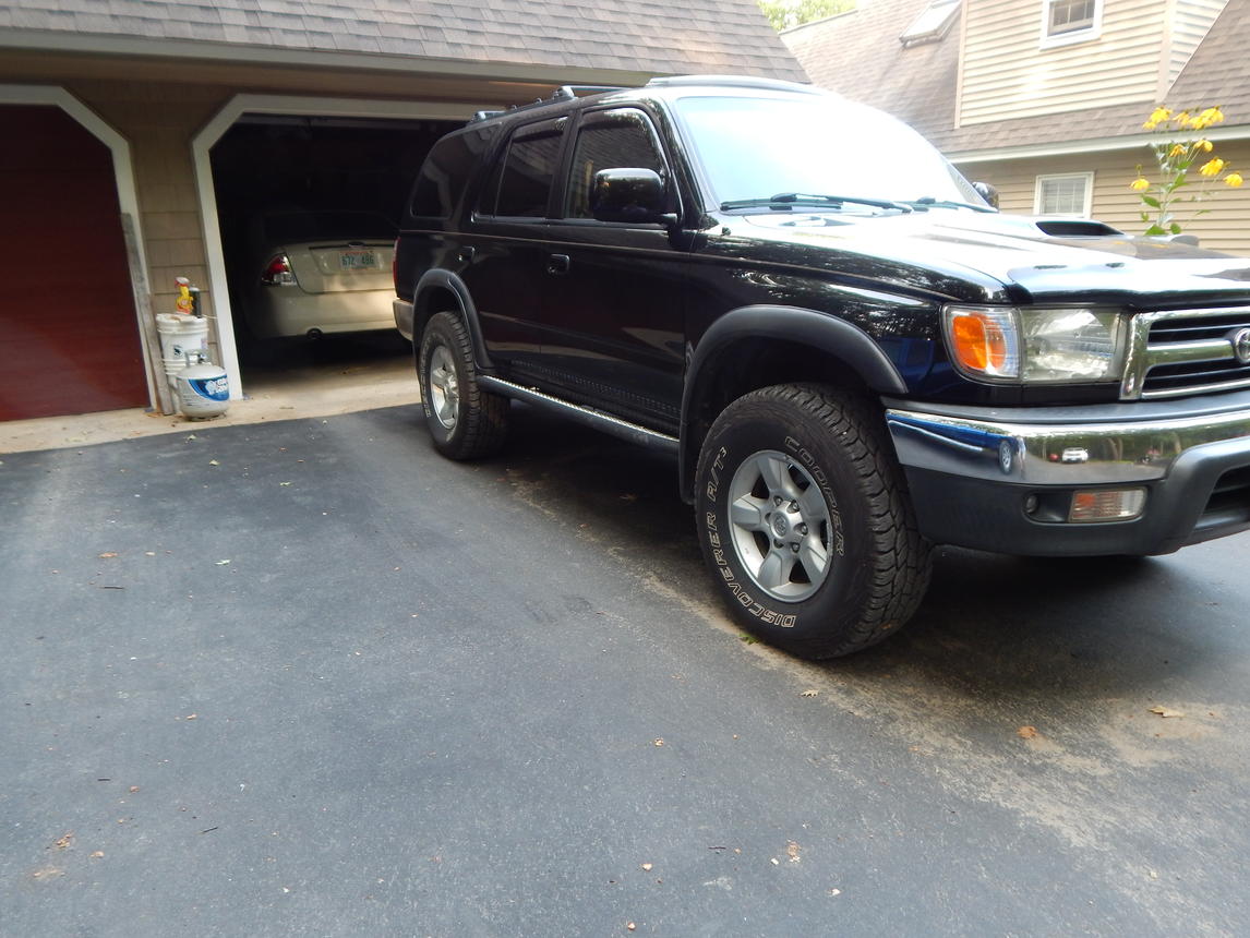

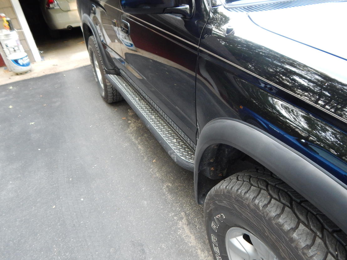

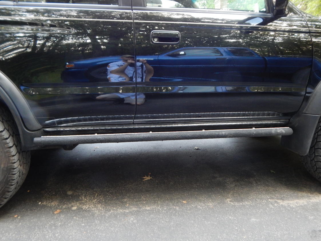

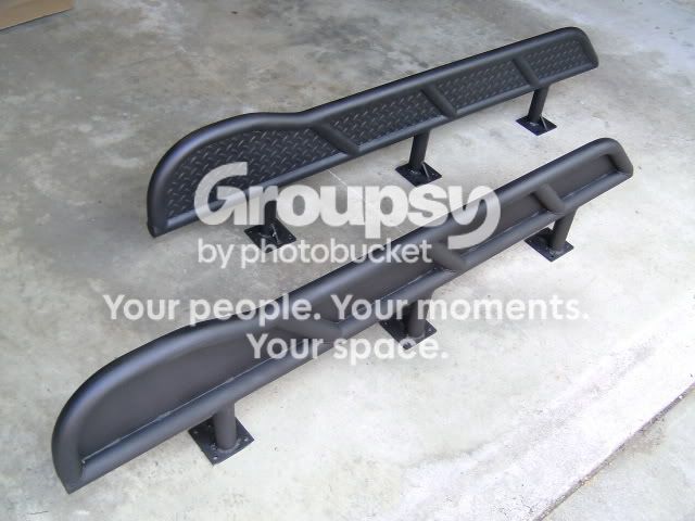

Stubs sliders bed lined. The diamond plate is bolted on with holes set in by Richard. The plate keeps the rocks and salty slush off the side of the rig. Let me know what you think.

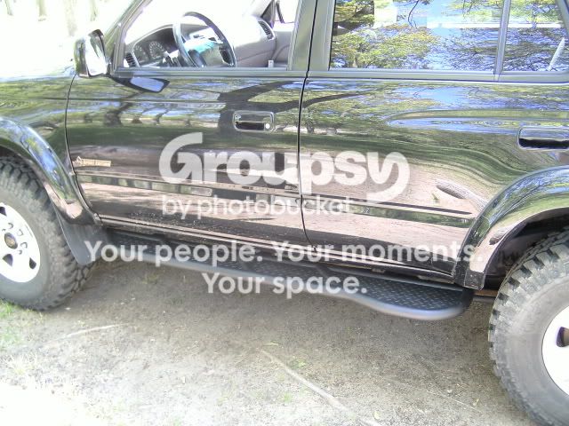

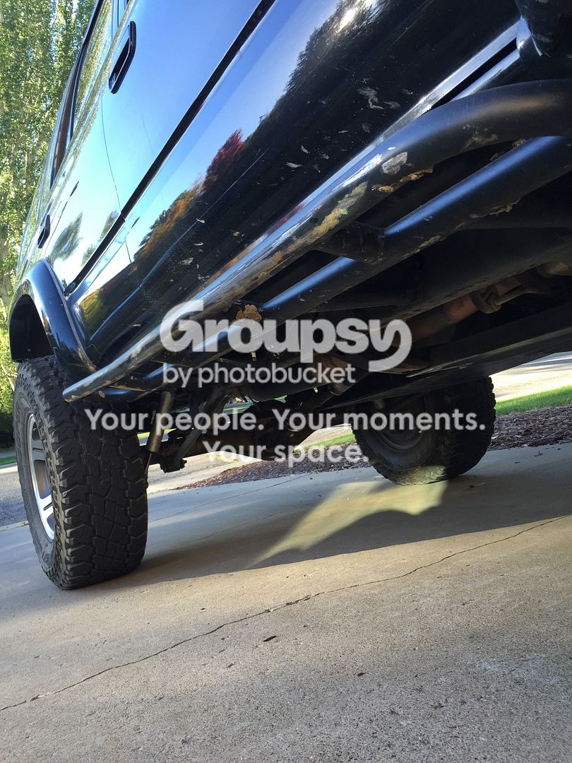

I've got 4xInnovation sliders on my truck. However, I customized mine. I had 4xInnovations angle the center tubes. Then I added diamond plating to fill in the openings. I mounted them to the truck horizontally. They work great.
A few pics:
PICT0181.jpg~original
PICT0213.jpg~original

I really like the way that looks. Do you have any drain holes in there? I could see water/rain, snow & slush getting trapped on top & causing rust & wet/dirty pants going to work.
Thanks. Yes i put 6 half inch holes in each flat section. It drains well unless the snow is really wet and heavy.
