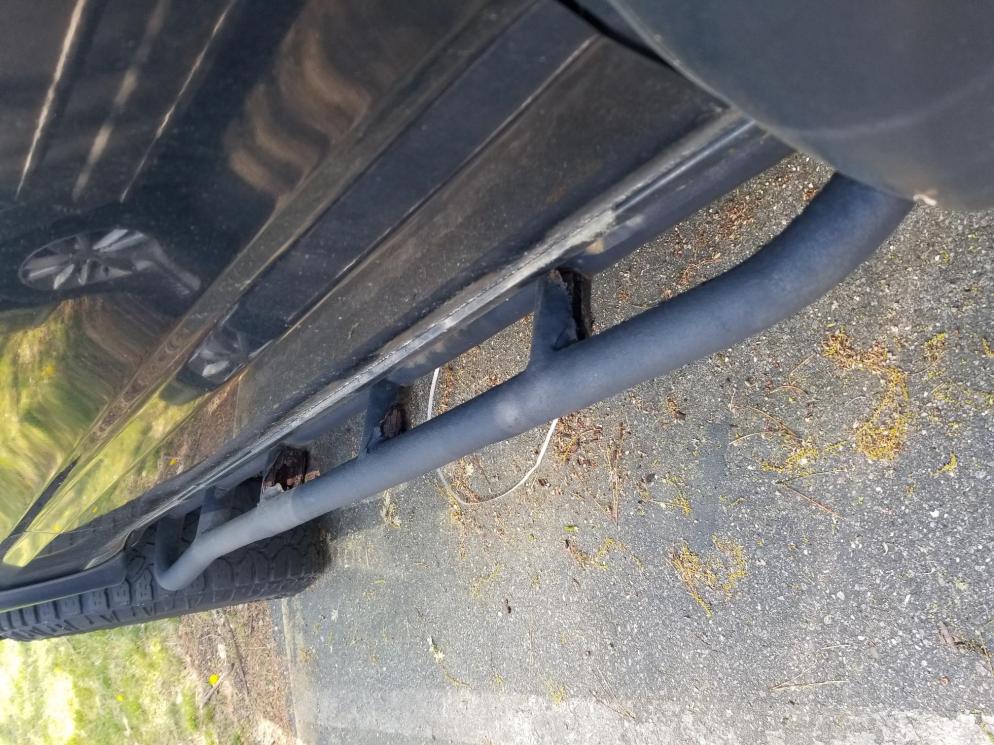

They were just for looks anyhow now they look even worse! sadly i think they welded so that gonna be another problem.
what i have to deal with...

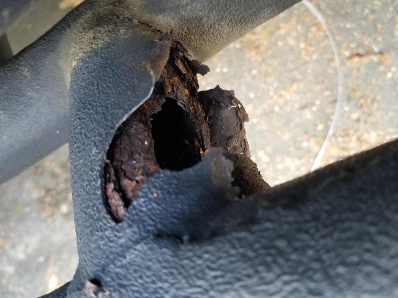

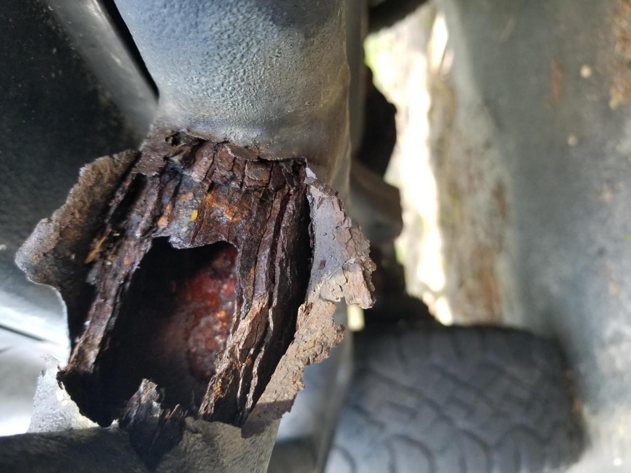

I believe i had these installed in 2011. I should have had them powdercoated. The place i had them prepped/coated and installed didn't do a good job. The Rhino coating apparently wasn't the real thing. I'm in NY so that don't help either. I have a jet ski and that involves salt water- again not helping.
i'm sure than anywhere else in the country it would not be too expensive to have them removed, stripped have the rusted pieces cut out and re installed but then again it might be even cheaper (if i had a mind to) just to get new ones and then powder coat.

Small pinholes in a hard 'shell' coating like that + road salt is a recipe for disaster. The same thing can happen on the frame if you do 'undercoating' treatments wrong...

Small pinholes eh? I never thought of that. Road salt.... I'm in NY so i know that is probably a big part of the problem. I'll bet the coating was not applied properly- or evenly because some part of the Bars are perfect and some- well you know.
