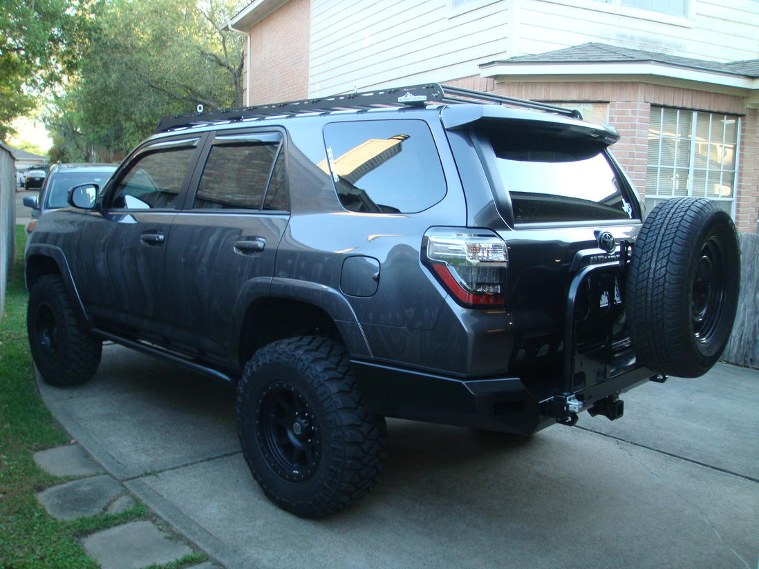

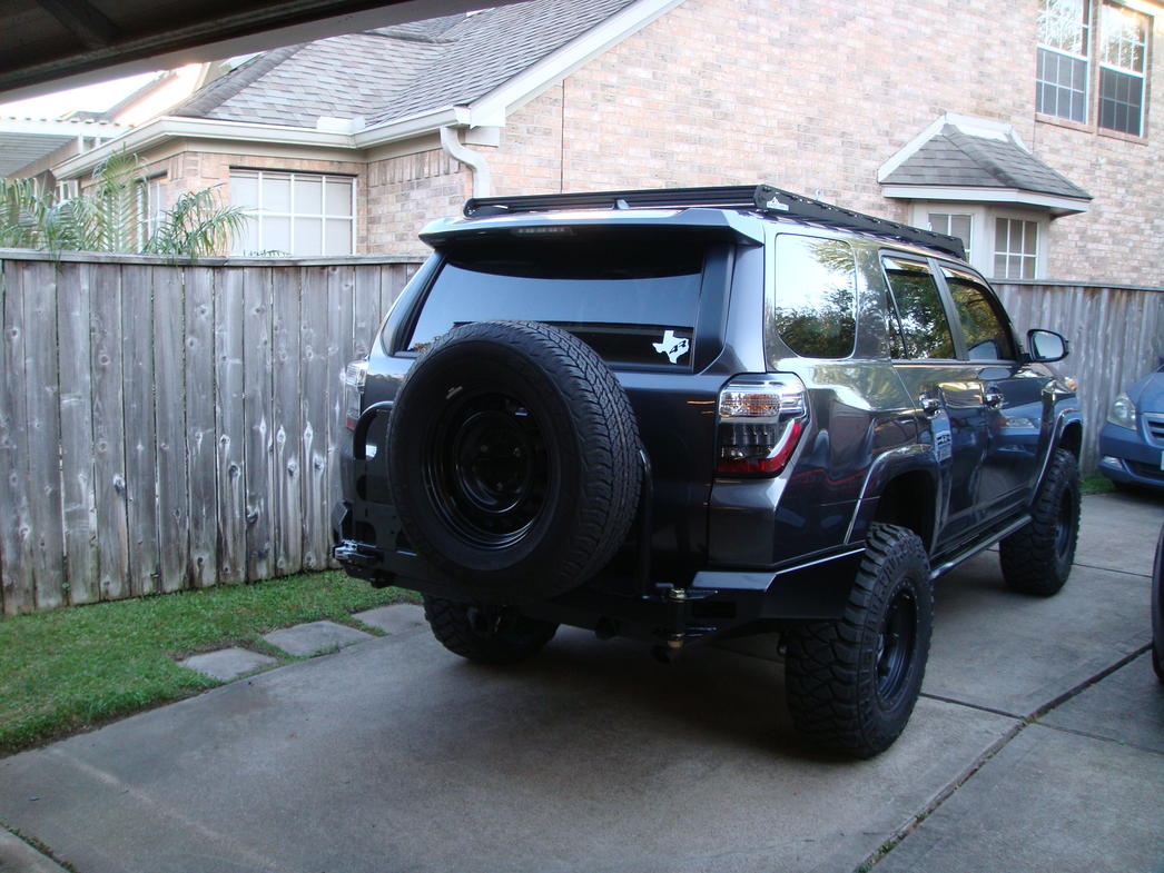

install done just need a few adjustments.

Looks great, how long did the install take? Looking to store other items on the swing out, does the swing out rattle if there is no tire on it?
worked a couple of hours on friday after work taking out my stock bumper.
I worked most of saturday measuring and cutting my stock bumper, sorting out and identifying all the parts. and spent most of sunday relocating my icon rear remote reservoir, since it was on the way of the bumper wing enforcement bracket, that was a PITA because you have to drill a hole in your frame. and spent a couple hours today after work installing my tire swing assembly. I have a single jerry can mount but don't have a jerry can yet and there's a spot for a high lift jack behind the assembly. It does not rattle without the tire, the latch is pretty strong.

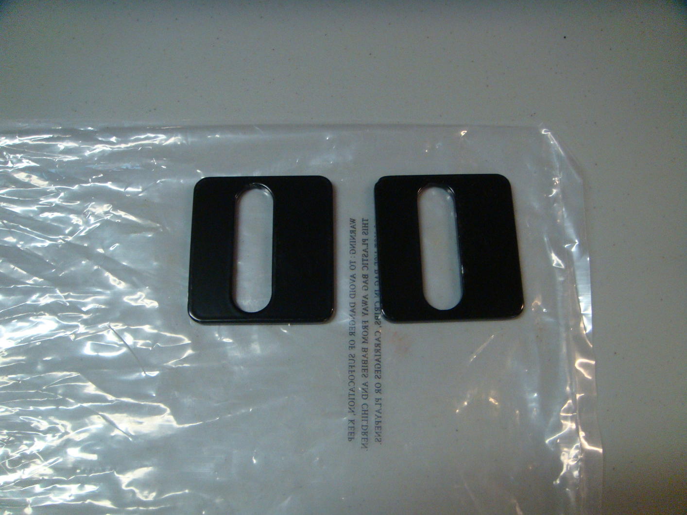

what's this for?
anybody knows what this is for? it came with the hardware bag but never used it. didn't say anything in the instructions either.
Spacers? I can't remember....sorry for the useless reply!
Great job on the install, it looks awesome. I highly recommend putting that spare tire as High, and Close to the vehicle as possible. While wheeling the other day, mine dragged in a little gully and actually pushed the rear swing-arm into the tailgate, causing it the dent and break the paint. The spare tire mounting brackets actually bent UP a little. All in all, it is fine, but my spare is now permanently angled and no longer straight vertical. Just a word of caution...you should be just fine
I'll post some pics in my build thread explaining what happened in better detail.
thank you for posting those videos, it really explains a lot with visuals. right now i have my spare set at the second hole from the top so there's one more slot that i can move up. as far as those 2 pieces goes, i don't know, i'm going to email them tomorrow and see if i get a response. i really don't think they are spacers. i used the thick washers as spacers. my next project is going to relocate the backup camera. i'm going to yank that back cover off and see what's back there. thanks again for your input.
FWIW, I've built two Jeeps and now a 4Runner using Shrock armor. I work at a garage part-time when I'm CONUS and have installed several Shock products on customer rigs. One constant ...Shrock always sends more hardware than is needed/called for, to include spacers/brackets/etc. It can cause confusion, but I appreciate the effort. Better to have more than you need than end up with missing hardware ..."thank you company that rhymes with Poison Spyder".
If you can't figure it out give Shrock a call. They're very helpful!
Anyway ...awesome bumper!!!!!
