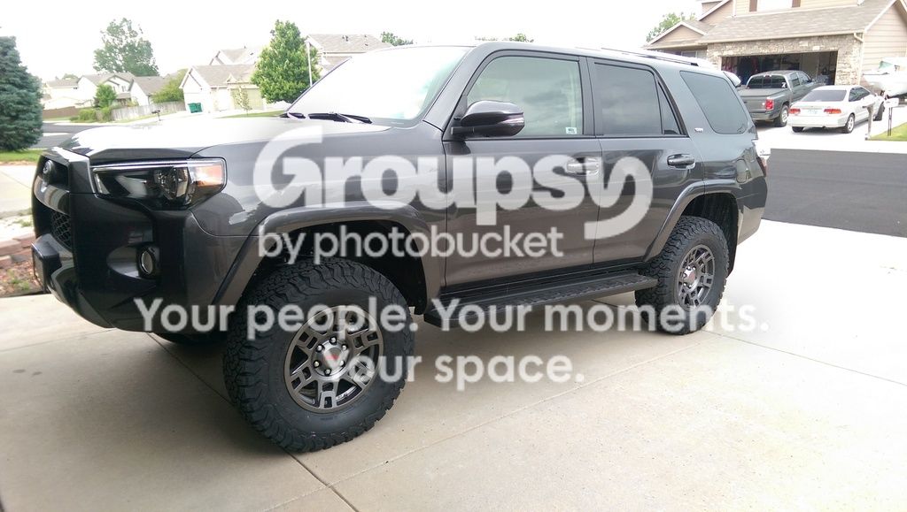

Truck is looking great! Yeah I had to really grind down one of the stick nuts to get it in a small hole, on one or two I bought longer bolts as it made things much easier. Love the step sliders though! Good looking rockers of course. Haha
OP sand and paint those stick nuts or grease the crap out of them they rust like a mf'er.
Well a little late to paint and grease them as they are already installed...should I spray a ton of WD40 in there or spray paint or just live with it? I'm not taking them back...F that.
